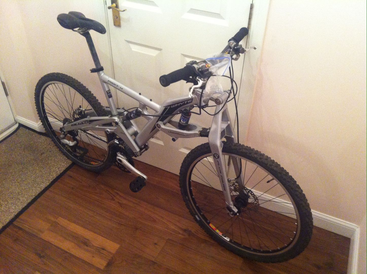

My new (old) toy...
Picked up this afternoon. It has a history that's common to so many bikes; bought, used extensively, broken, left in shed until it can be fixed later. Cue several months/ years of playing host to spider webs and gathering dust, and then a house move, new job, or other life change comes along and suddenly it's no longer a valued possession, but a bloody nuisance that's in the way...
Still, his loss is undoubtedly my gain :lol: , I've had a hankering for one of these ever since I saw one in the window of Action Bikes on London's Victoria Embankment back in 2000 or 2001. Sadly the price tag at the time time was way beyond my reach. I think a fully spec'd one was well over £3000! :shock:

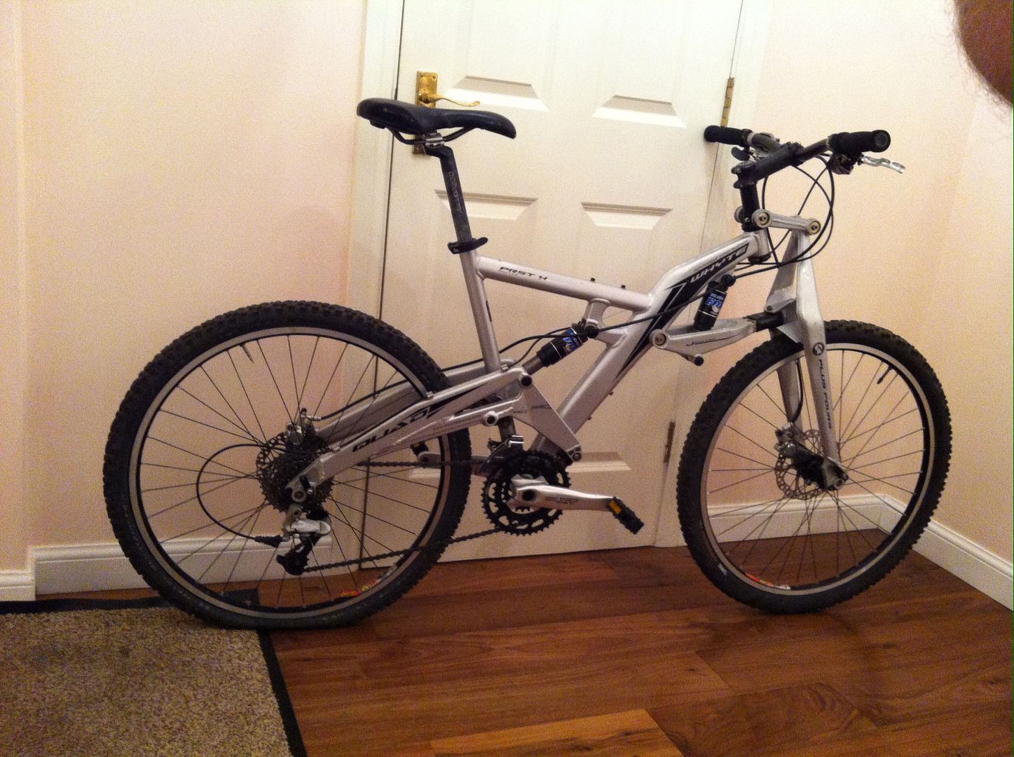

So, here it is. A Whyte PRST-4.
This was the final evolution of Jon Whyte's "Plus Fours" linkage front suspension system, a system he came up with after he stopped messing about designing Championship winning F1 cars for Michael Schumacher, but which was sadly discontinued sometime in the mid 2000's.
As a self confessed Engineering geek extraordinaire, it's always been a very intriguing beast to me. Mechanically pure, and visually more exciting than any set of tele-forks. It always brings to mind John Brittens V1000, a racing motorbike he developed from first principles in his shed, completely rethinking the way a motorcycle should be built. He designed and built the thousands of unique parts in his garage, including the engine :shock: , and the linkage suspension systems that are echoed here in the PRST. He took it to Daytona and giving the works Ducati team a massive fright, and an exceedingly bloody nose... Sadly, he died in 1995 from skin cancer, he was only 45...
Anyway, enough of "GSB's Engineering Heroes", back the bike. Considering the furore I recall around the PRST-1 when it came out, & then around the PRST-4 that succeeded it, there is practically no info at all to be found online about them, and in particular, on how to maintain them, tune them, and perhaps even improve them. I'm proposing to rectify this, and this page will play host to a detailed stripdown and rebuild photographic log of every last component, and will detail the technical specs of all the parts that are unique to the PRST, including part numbers and current suppliers, something that I've struggled with today...
This particular bike has been well used, but its straight, crack free and looks like a liberal dose of T-Cut and new fasteners will have it looking 99% factory fresh in no time. If not, then it's going to the powder coaters to be refinished in White, a colour that I think would suit this particular frame. (Or perhaps the colour of Marmite, on account if its love it-hate it reaction from most people!)
It's currently suffering from the usual PRST gremlin, as the spherical bearing in the front suspension appears to have comprehensively shat itself on its last outing. All the other bearings appear fine, but will be replaced anyway to provide peace of mind, a factory fresh frame, and of course to provide a record of how to do it here...
Should any other readers have experience with these bikes, and have any tips, please feel free to post them here.

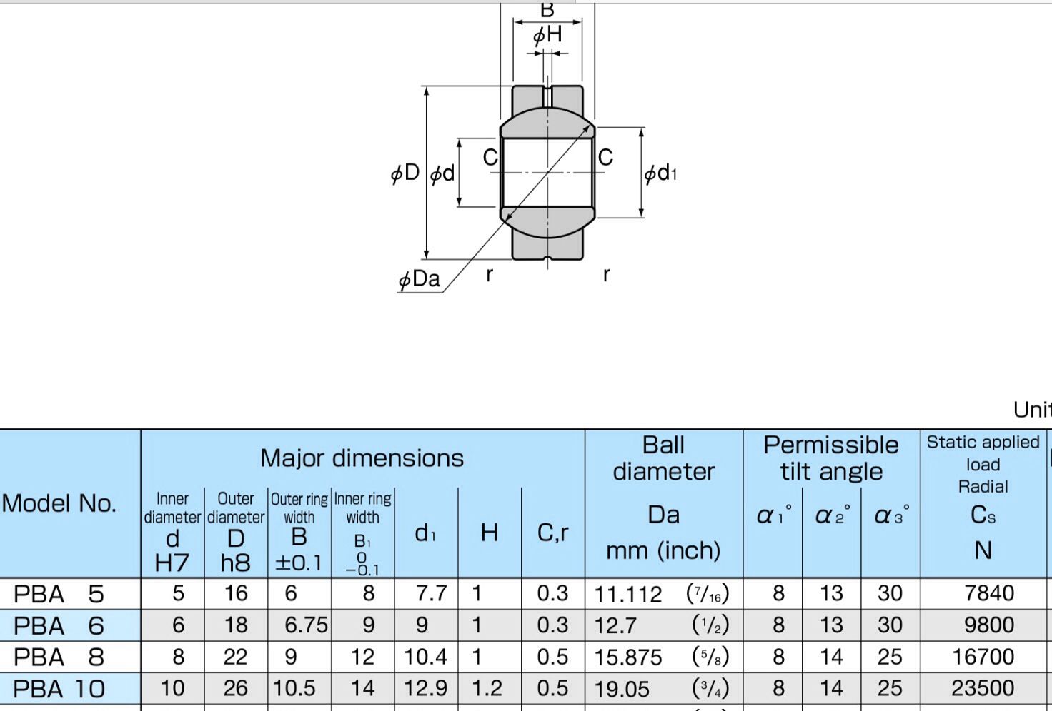

Anyway, the bearing situation is definitely one I want to look into. £150 for 15 fairly common bearings "seems" a little pricey to me, especially when you consider that the problematic spherical bearing that Whyte supply (PBA10) is the cheapest, nastiest, die cast bearing they can get their hands on. The rest of the bearings are generic aircraft control bearings developed decades ago. I'm almost positive that there are either savings to be had, or improvements in quality and longevity available for that sort of money. The spherical bearing in particular is an area that can definitely be improved upon.

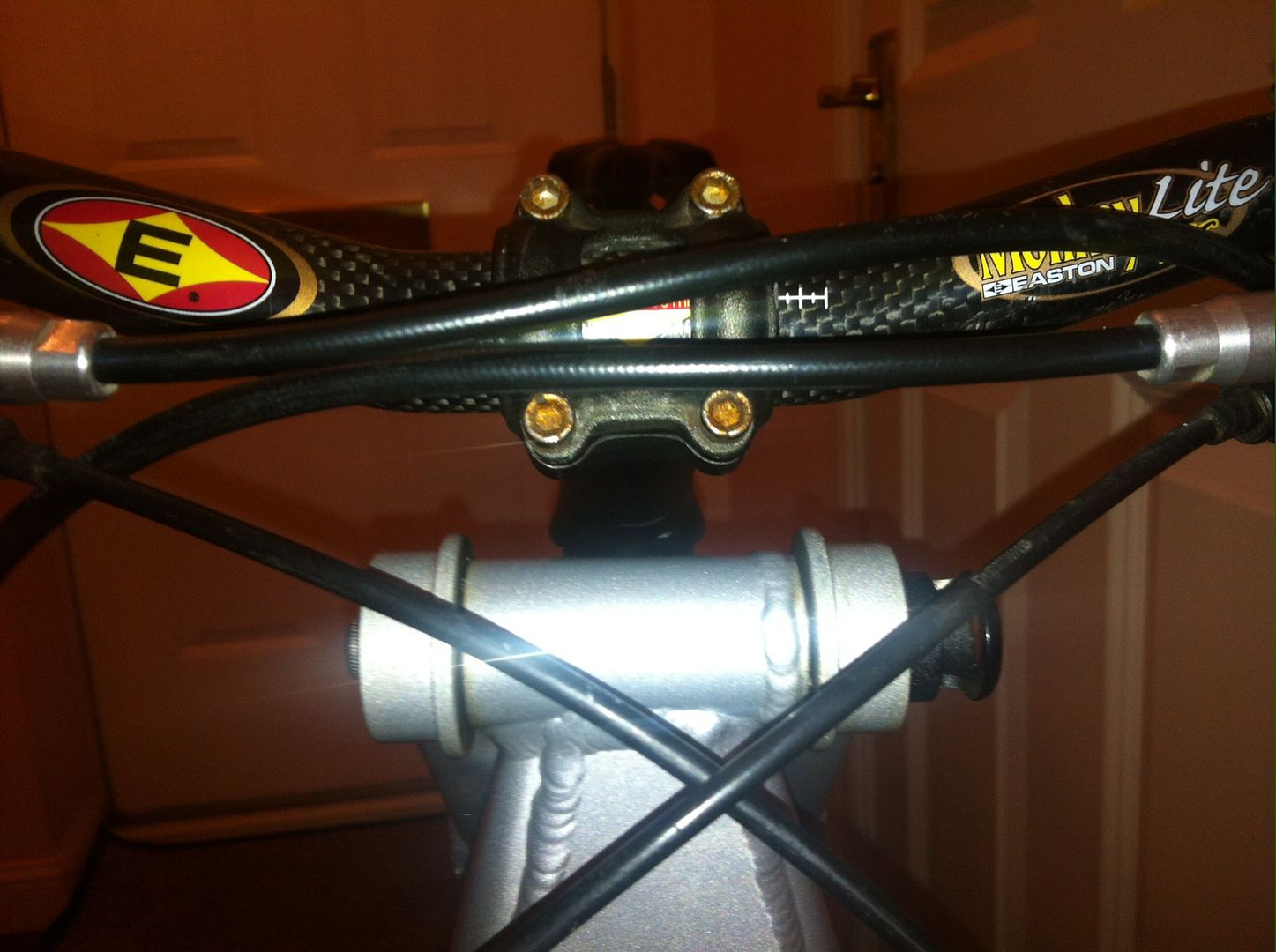

The top tube length on my PRST is identical to that on my 4 Banger, so it seems ok to me. It's got a long steerer which puts the bar quite high (and for some reason the previous owner has augmented this with a set of Easton carbon riser bars - soon to be in for sale thread near you...) and it's got a 100mm 5 deg rise stem on it, but you're quite right, clearance is the issue. Its a 4" travel front end, and the non-telescopic design means it needs 4 and a bit inches clearance between the top of the fork and the stem when extended, since when compressed it does get mighty close;
That's unusual, but ok. What frightens me is the prospect of bearing wear putting the front tyre into the lower wishbone if you bottom it out. Imagine the picture below with a bit of brake induced flex :shock: I think a superman impression would almost certainly be on the cards...

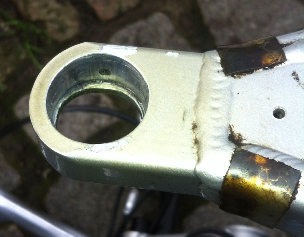

The bearing lives in a machined recess in the lower wishbone, the recess is shown here with the bike upside down. Note the flange against which the bearing rests, and through which the suspension forces are transmitted;

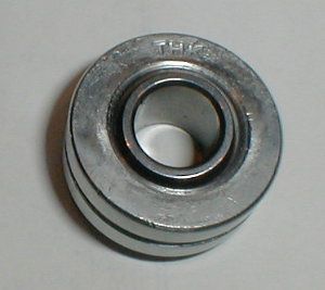

The bearing that lives in there should be a plain spherical bearing type PBA10, that looks like this;

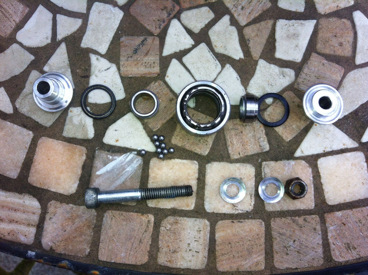

What I found in my bike though, was a tiny bit different...
This is an odd bearing indeed. Its a compound bearing, one inside the other. The two parts on the extreme left and right are the parts that Whyte provide to connect the fork to the inner element of the spherical bearing. The bolt goes through the middle and clamps it all together. In the middle is the spherical plain bearing, as expected, but with a far larger centre bore. The pieces either side of that are inner race halves of a normal angular contact single row ball bearing. The balls should live between the groove that these parts make when joined together, and a matching groove that lives inside the spherical part of the main bearing... So what we have is a high speed - low load ball bearing sat in the middle of a low speed - high load bearing.
Yep, I'm scratching my head too... The high speed capability isn't required. Possible reasons for fitting it would be to reduce friction when steering, but it comes at the expense of an even more fragile bearing that fails in an even more spectacular manner than the type I was expecting to find. There were a number of balls I didn't find in there, so at least a few have escaped. The amount of clearance the failure of this as yet unknown bearing type generates when it fails is spectacular, the bike would be utterly unrideable.

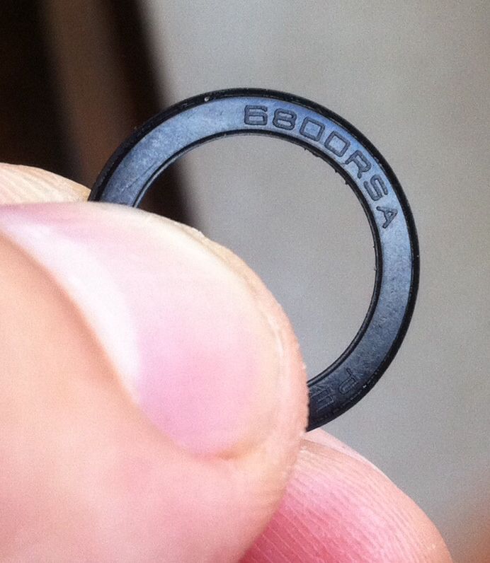

So what sort of bearing is it? According the the dust seals I salvaged from the greasy mess inside the bearing cover boot, its a;
6800RSA From PEEL in China. Except it isn't. The 6800series bearing in peels catalog looks rather different to this one.
Un petit mystery, n'est-ce pas?
Whilst I had the suspension in bits I took a look at the other bearings as well. The upper wishbone, which is pretty much kept out if the filth, spray, mud and muck, was buttery smooth in operation. No issues there at all. The 2 Bearings in the lower wishbone have had a harder life though, as they are very notchy, feeling like they are full of sand...
