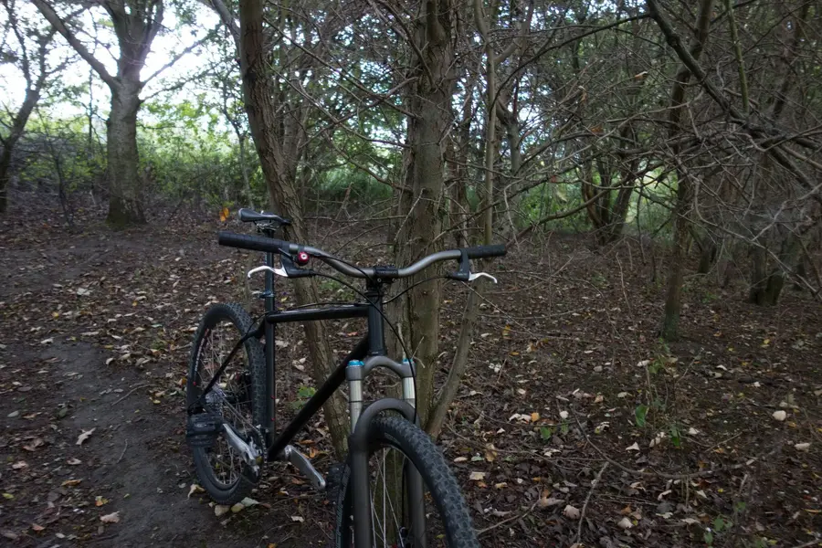

Here is my new CX ride, an Cotic soul build whit 650B wheels

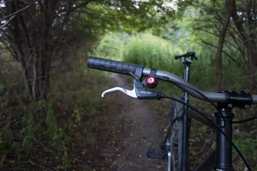

Frame: Cotic Soul

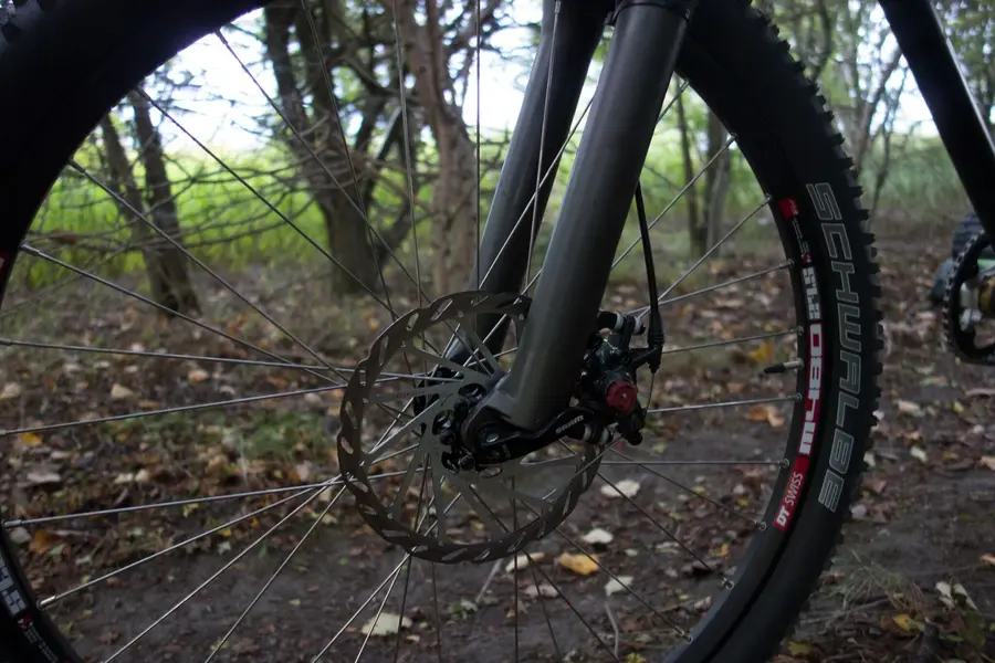

Fork: Fox (can some one name the model??)
Headset: BBB treadless
Stem: Thomson
Handlebar: TI 25.4 riser
Grips: No name lock-on
Brakes: Avid BB7 180mm
Brake Pads: Avid
Brake Cables: Clark
Brake Levers: Shimano XT
Shifters: Paul/SRAM 3V
Rear Derailleur: SRAM X.9
Derailleur Cables: Clarks
Cassette: Sram 10 speed 12-34
Chain: KMC Silver X10
Cranks: XT
Chainrings: 39T ( will be replaced soon whit a 34T)
Bottom Bracket: Raceface
Pedals: Plastic BMX platform
Rims: DT Swiss M480 650B
Hubs: SRAM X.7
Nipples: DT Swiss
Spokes: DT Swiss
Tyres: Schwalbe Rocket Ron 650B (54-584)
Tubes: Schwalbe 26"
Saddle: Specialized Phenom SL
Seatpost: Ritchey WCS

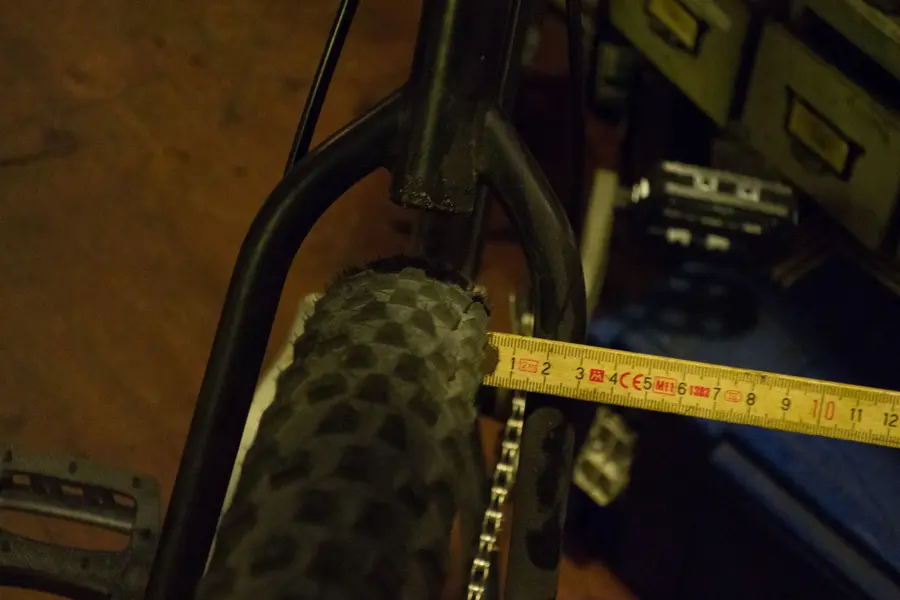

Here is some photos of the clearings:

Excellent!
