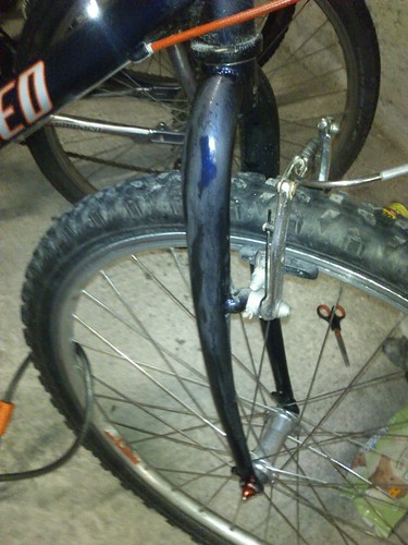

On collection, I felt that the buyer had understated the condition of the bike, somewhat... The scratches were numerous, and there were an above average amount of bare metal patches caused by repeated scuffing. Bike carrier damage, I reckon. There was also a dent on both sides of the down tube, as if someone had put it in a vice. The brakes and shifters were scuffed beyond belief, and the Gripshift was vague and couldn't hold the gears in place. oh, and it was a 1998 model. :facepalm:
Dent.

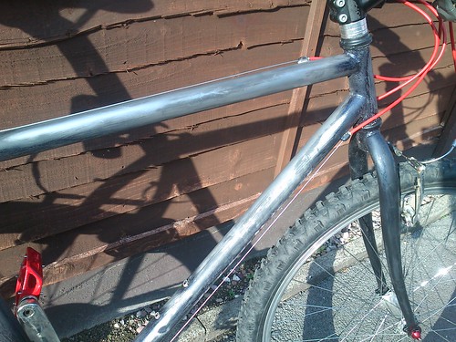

Before heading home, I decided to have a quick try with some sandpaper. The coarsest I had was rated '60', whatever that means, and I gave the top tube a good old scrub with it. Within seconds, I was seeing bare metal! :D So then I gave the down tube a bit of a scrub. Then the seat tube.. Then the top tube a bit more..
That's more like it! In 30 minutes, I managed to remove about 50% of the paint from the bike (all the easy bits). I'm not sure if it came off so easily because of the paint stripper. Hopefully it did help, because that means I didn't waste a lunchbreak and £5.99.. :p

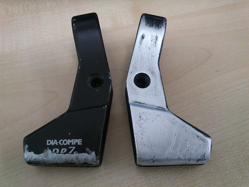

Anyway, I've now created a smaller anti-rat project: I'm trying to refurbish the scratched-up Dia-Compe DP7s that came with the bike. Here's the result of the little test scrub that I gave one of them:
A bit more scrubbing, some metal polish and some laquer, and they might actually scub up quite well! :)
I did the same thing with the brake leavers with a scowrer and sandpaper.. worked out pretty well quickly.

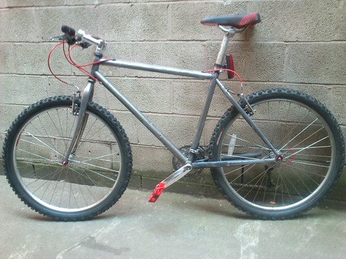

Yesterday, I decided to put the paint stripper on again, as I suspected it had been the reason that I made so much progress last Thursday. It turned out that I was right - it made the paint soft and much easier to sand off! It makes sense, I guess, as the bike is most likely powder coated rather than painted, so the paint stripper must unbond the coating for a bit. Once it dries, the paint seems to bond back on.
I didn't take a photo yesterday, but I did the same thing today, and here's my progress (red bits may or may not be staying):
Apologies for the bad mobile photo
Nearly all gone! :D
