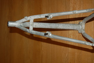

The strip down was all pretty easy until the non drive side crank, the bolt was corroded but came out after a bit of a struggle but that was the prelude to the crank refusing to budge. The crank set is Shimano M569 Deore LX c1998 so not worth that much, particularly as set up as a single speed and needs 2 new rings. Key issue was not to damage aluminium frame so after much deliberation re violence, heat, etc decided in the end had to cut off the crank with the angle grinder. Then it just came to the BB. The standard sealed shimano unit but some sort of compound had been used in threads as these were a nightmare but a 3ft breaker bar helps.
Close examination of the frame showed the white corrosion of aluminium oxide pretty evenly over the exposed frame and also that large parts of the paint could be just pealed off by hand, bit like pealing hard boiled egg. This to me suggests a problem when painted or coating ? However the good news was that a little rub with wet n dry was very soon down to metal so initial prognosis good news. Having got 2/3 paint off, resorted to the paint stripper, all came off pretty easy.
Image Image
Image Image
Image Image
Image Image
so frame is sound it seems, :D ,certainly all the welds look good and indeed many seem to have escaped the painting issue completely.............and some polishing to do.

yes, assuming you mean this one, viewtopic.php?f=4&t=254035&p=1907094&hilit=Dean#p1907094, and to save anyone looking it up, paid more than I really wanted to, but didn't have to go to Cambridge as seller kindly brought to London, just hope I can flog some of the bits for a bit of cash. I think there was definitely something wrong when last painted, it came off so easily hard to believe not a respray, but did look like it came from the factory and just missing something as "corrosion" had got under paint. I know corrosion is the wrong description as Aluminium has a thin layer of oxide almost inevitably but not where bit powdery.
Some of it can still see stamp on Easton tubing and I do like nice clean tig welding
.........and it is very light (compared to the old steel things I'm used to) :D
