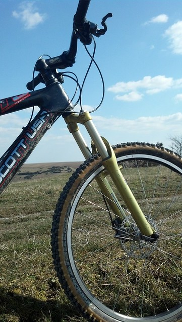

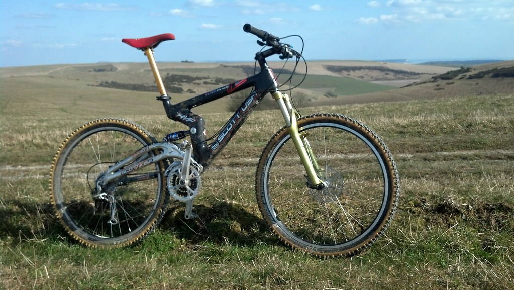

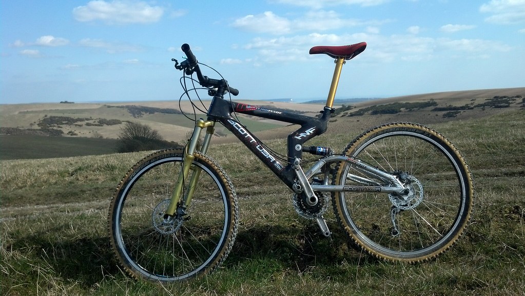

So I built this up finally a month ago and have been loving it - my first full sus.

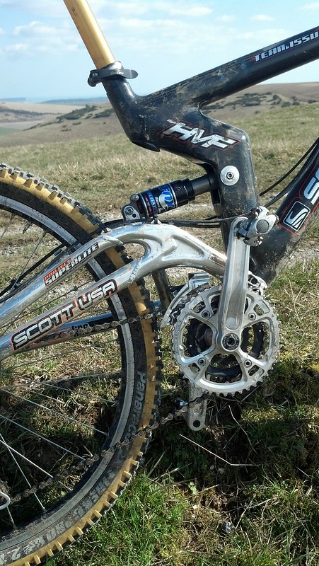

Now I have discovered that the rear is cracked in 2 places - I probably rode it too hard - it is a 'superlight' frame after all, and 'team issue' which usually means 'falls apart after less than a year'!
Anyway, here are some pics of how it was, taken on the South Dawns around Brighton..
Its my highest spec build so far - details after the pictures.
The frame weighs about 1900g but I haven't actually tried on propper scales yet. I think that is one of the lightest full sus frames of its time - wonder how heavy the lightweight full sus. frames of today are?
Anyway - the build:
Wheels - Hope Ti on Syncros Altrax XLT
Tyres - Panaracer Fire XT Pro 2.1
Front Shock - Rock Shox Psylo Race 2002
Rear Shock - Fox Float RL 2003
Brakes - Hayes Stroker Carbon
Rear Mech - XT Shadow
Front - XT
Shifters - LX
Bars - USE Atom
Stem - Truvative XR
Grips - ODI
Cranks - Race Face Atlas AM
BB - Enduro
Seatpost - GUB
Saddle - Club Roost
I have potentially found a replacement rear swingarm but it is from a Medium framed plain G-Zero - mine is a 17.5". I'm guessing I will just put up with the slightly longer wheelbase - unless it is only maintubes which change? - Pretty sure they would change length of swingarm through the sizes too though..
Hope you like it - or liked it :(
PS: Anyone know how I would remove the swingarm - the pinch-bolts on the pivot are all I can figure out - do I need to hammer something?!

Hi - I've had a couple of these (love them) I actually sold a Scott spark 20 as I preferred my old strike.. Ive got 2 currently, one of mine cracked on the rear arm either side of where the rear shock bolts through. I had it welded without taking the rear arm off (which is a bit of a mare....) cost about £30 to repair it....

re: swingarm removal - looks like you need to undo the pinchbolts then the tube gets drifted out is my guess. You can put in a large screwdriver or other implement in the gap to open up the clamp so it is loose on the tube - same as you would do with stubborn seat tubes and stems - but not too much as you don't want to fracture it,

I had two of these frames the team edition and a standard one. 12 year old carbon went pop one day when I was putting 600watts of power through the crank. I think it had been crashed though. It is a shame I didn't see your post a while back as my friend has this bike and a full functional swingarm.
To remove the rear swingarm you need to remove the pinch bolts.. Don't pry them as they might snap. Carefully put the frame on the floor and get a long socket the same size as the metal and bang the socket and axle through. I managed this and replaced the seized bearings at the same time.
The bike rode really well after that... I wouldn't ever try to repair a broken carbon frame - that's a bin job straight away. The rear scandium frames can be welded up again pending where the fracture is..
