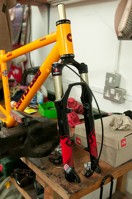

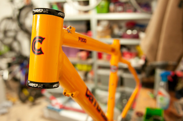

After some extensive Googling I eventually determined that you could ditch the headshok (which I didn't have anyway) and convert the frame to run a conventional fork by use of a 1.5" to 1 1/8th adaptor headset. You can only insert the headset about 11mm into the frame so I have shaved a few MM from the bearing housing to get it in. The original P bone headshok was only around 60mm of travel and the new fork is 80mm so it will change the geometry slightly, but 80mm is as short as I can get on a modern fork.
Forks in:
It may be up and running by the weekend, but knowing the vague delivery plans from on line shopping and the chances of it all actually fitting together first time it may be a few weeks yet! :)

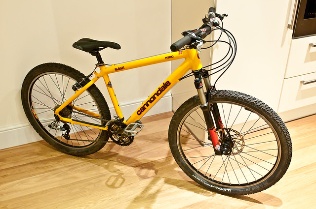

Finally finished it!

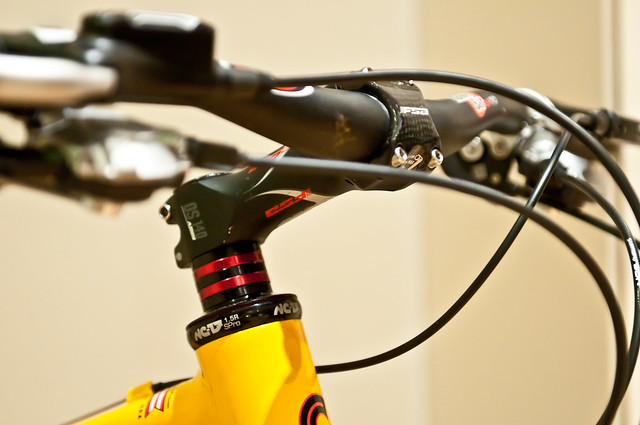

Various unnecessary but essential carbon and anodised bits:
23lb all up weight so quite pleased with that for the budget, he just needs to grow a bit now, but I get the feeling that's not going to stop him riding it! :)
The frame around the rear brake is a bit flexible so you can pull the lever to the bars, so a retro brake booster may be in order!

We had our first proper ride out this weekend and it's great! The components should serve him well for years, just need a bigger frame once he gets to more than about 5' 6"!
I've got all the bits to build my daughters F600 frame up now, so I'll crack on with that one soon!
