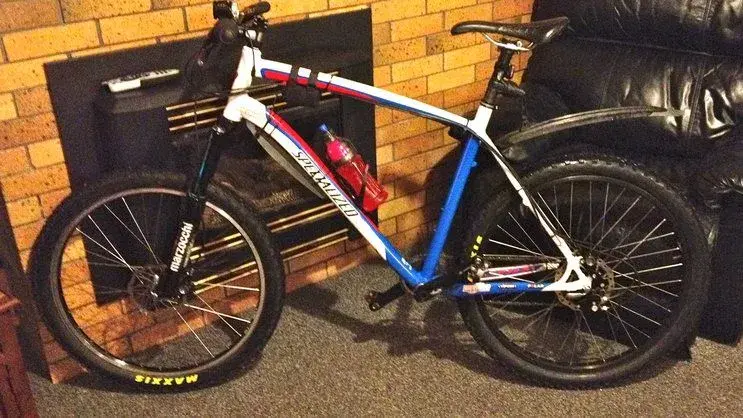

Picked up a 2011 stumpy frame last week and started sticking bits to it
The plan was for an all purpose/winter bike
It just kinda "evolved" into the bike i the pic
I had my first outing on it today and it just works!
Spec
2011 Stumpjumper
Bomber rlo 44 fork
Rohloff 14 speed internal gear hub
xt crank with surly 32t ring
rear 36 hole alex dm24 rear rim
mavic 717 on xt hub front
magura disks front and rear
Looks a bit like this----
