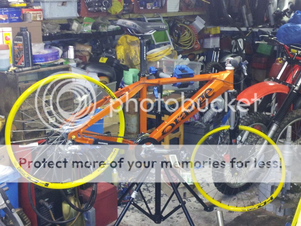

First up where the wheels, forks and brakes. I had some Rockshox Psylos hanging around which I picked up cheap, some Hayes Comp disk brakes and bought some cool yellow Vuelta rims with Diatech hubs from my local bike shop. I also changed the broken Deore Cranks for some used Hollowtech 2's.
However, the hubs were that old that the disk mounts were not the current iso standard so the wheels had to go back.

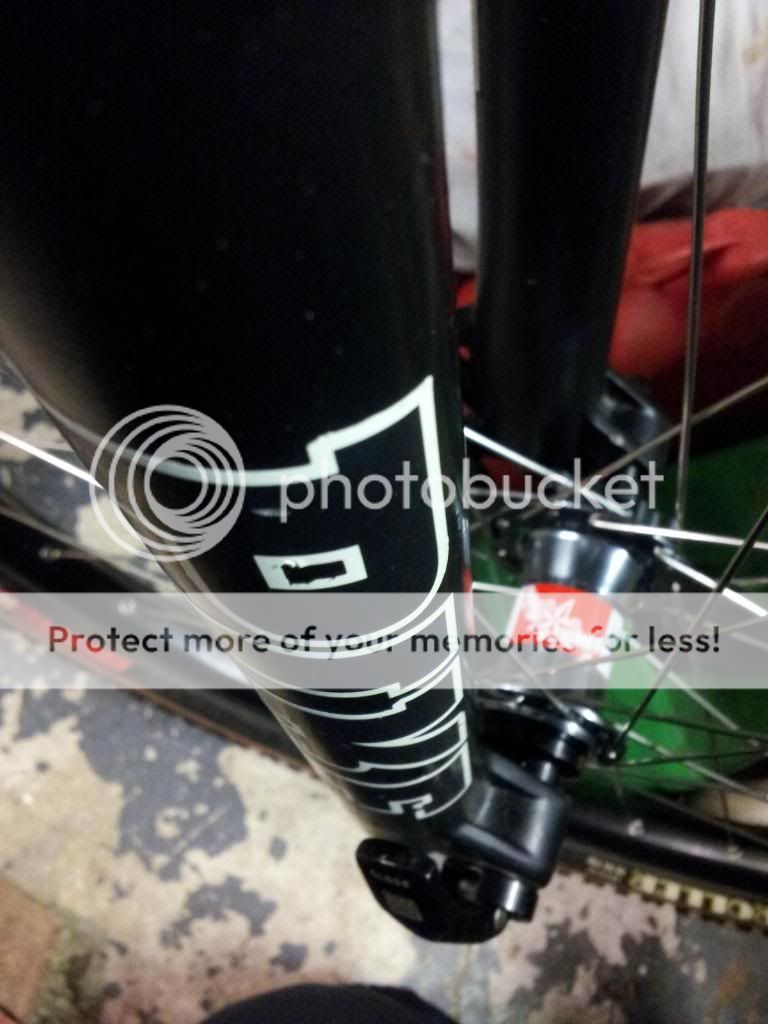

I then sourced a set of Rockshox Pike 454 air U-Turn forks as the Psylos wern't really up for the abuse the bike was going to recieve.

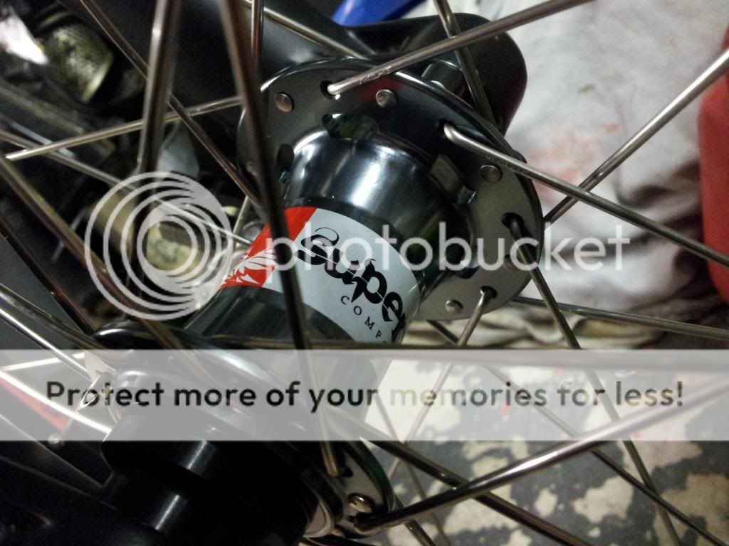

With the new forks, I needed a QR20 front wheel, so after some research, I got some prebuild, superstar AM wheels in their clearance section for just over 100 notes.

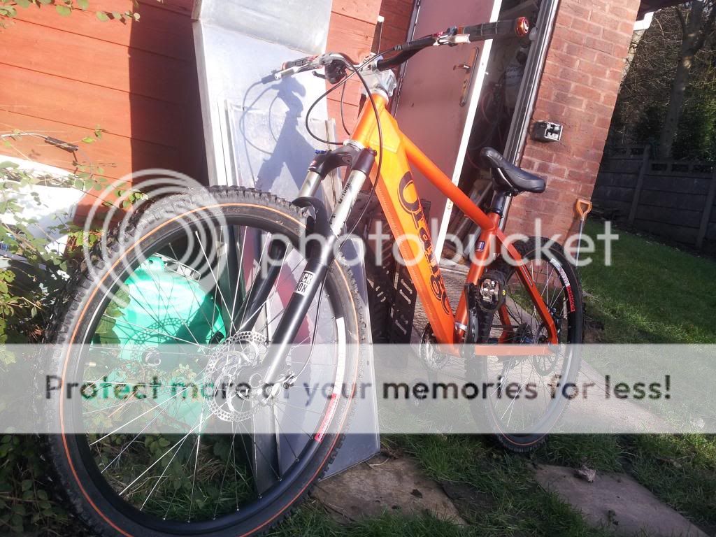

I then changed the broken XT mech to a Tiagra road mech, got an 8 speed road cassette and 8 speed shifter, a pair of Avid Juicy 7's as the hoses were too short on the Hayes with the Pikes, a Ritchey seat post, Salsa seat clamp and a set of Superstar Lock On Grips
This is how the bike stands at current. I have had to use the bash guard and front mech as a chain device, but that is the only bodge at the moment, and after yesterdays maiden voyage, everything seems to be working well.
