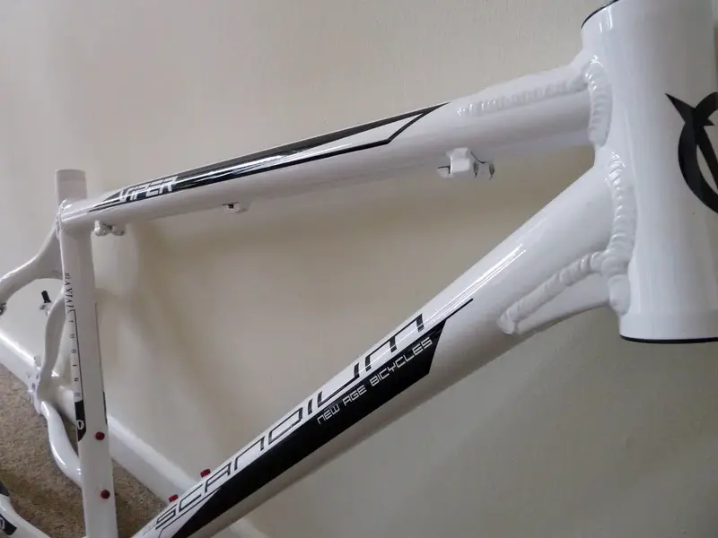

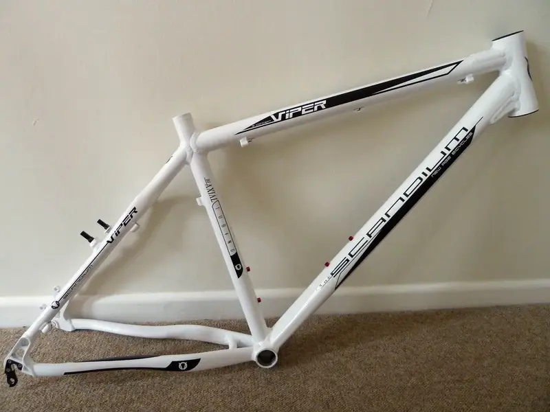

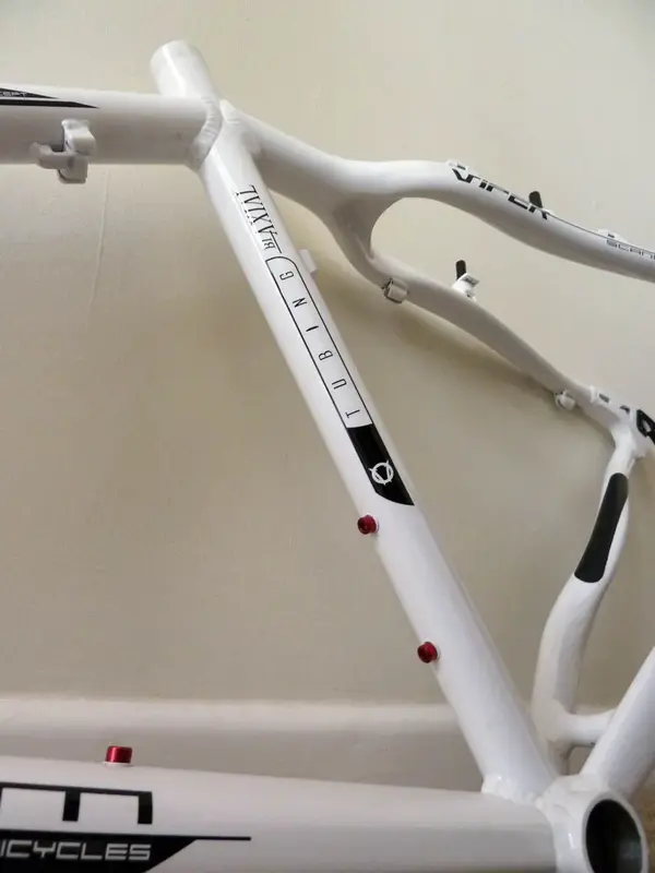

Right, it's time I started a thread for this project. I bought this Viper Scandium frame here a few weeks ago and am starting to build it up. I was a bit miffed when it arrived as it was a good 200g heavier than the seller stated, though it's obviously still pretty light at 1525g, which includes brake bosses and the headset cups (but not the bearings etc).
The plan is to go for a weight weenie build, but with suspension and a 3 x 9 drivetrain. Hoping to bring it in around 19.5lbs excluding pedals and I'm not far off with the parts I have. Colour theme is black finishing kit (wheels, seatpost, stem, bar) with red accents (bolts, clamp, skewers, spacers). Pictures of the bare frame included for starters, more details to come as the build proceeds.

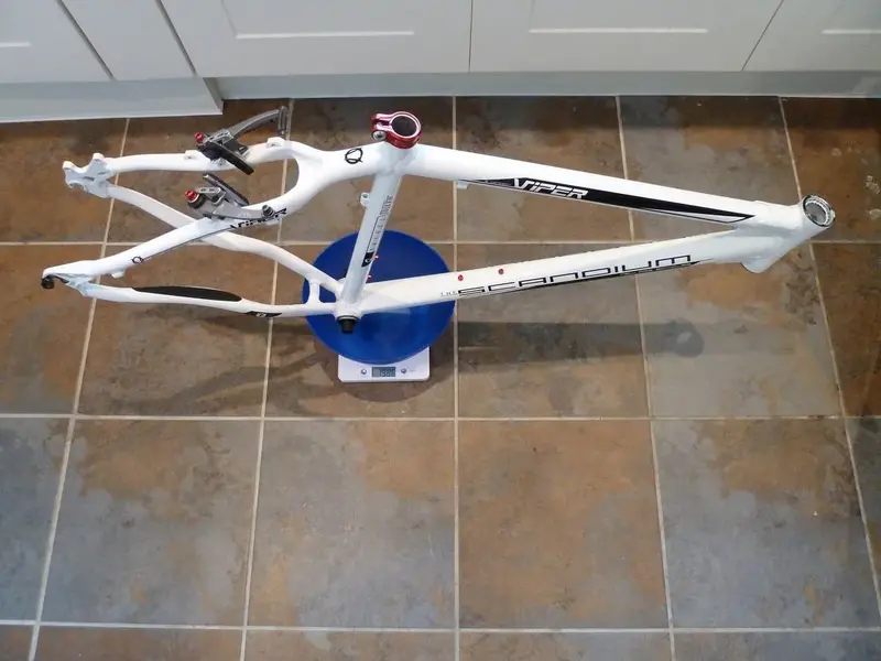

It's 16" c-c with 23" top tube.
I weighed it when it arrived (on more than one occasion!) at 1525g with headset cups and brake bosses installed - so presumably that would be about 1460g 'bare'. As pictured, it shows 1986g on the scales (set to 0 after adding the blue bowl). So minus the ES71 BB (248g), XTR brakes (178g), Hope clamp (19g), 2 brake boss bolts (7g) and 4 bottle cage bolts (6g) that makes more or less the 1525g that I weighed first time round. Unfortunately the weight the seller stated was estimated, and I was not especially impressed by that when it arrived.

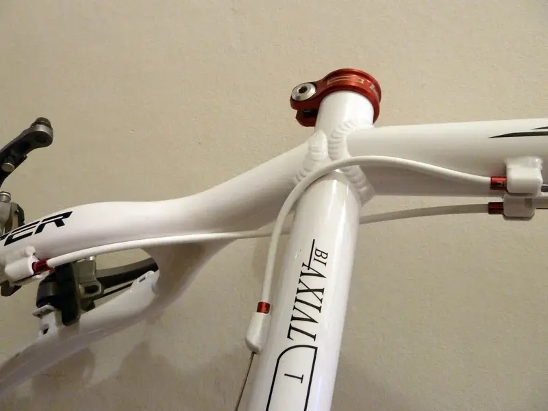

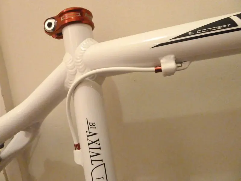

Another photo update as I get more obsessed by cabling...
