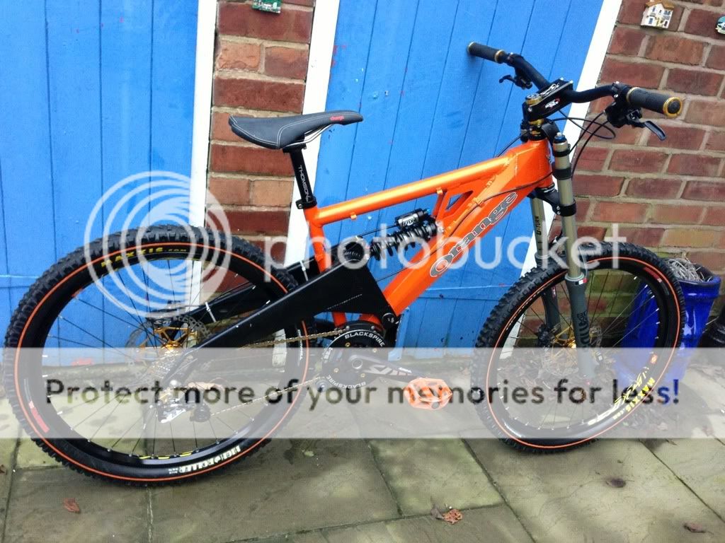

As some of you may or may not know, up until recently I had two Orange bikes The MsIsle for commuting and the odd thrash around a BMX track if I feel like it... and the Patriot for downhill duties.
The patriot has the usual spec list; Boxxers, saint brakes and gears, Hope/mavic wheels etc etc and was very specific to Downhill riding.

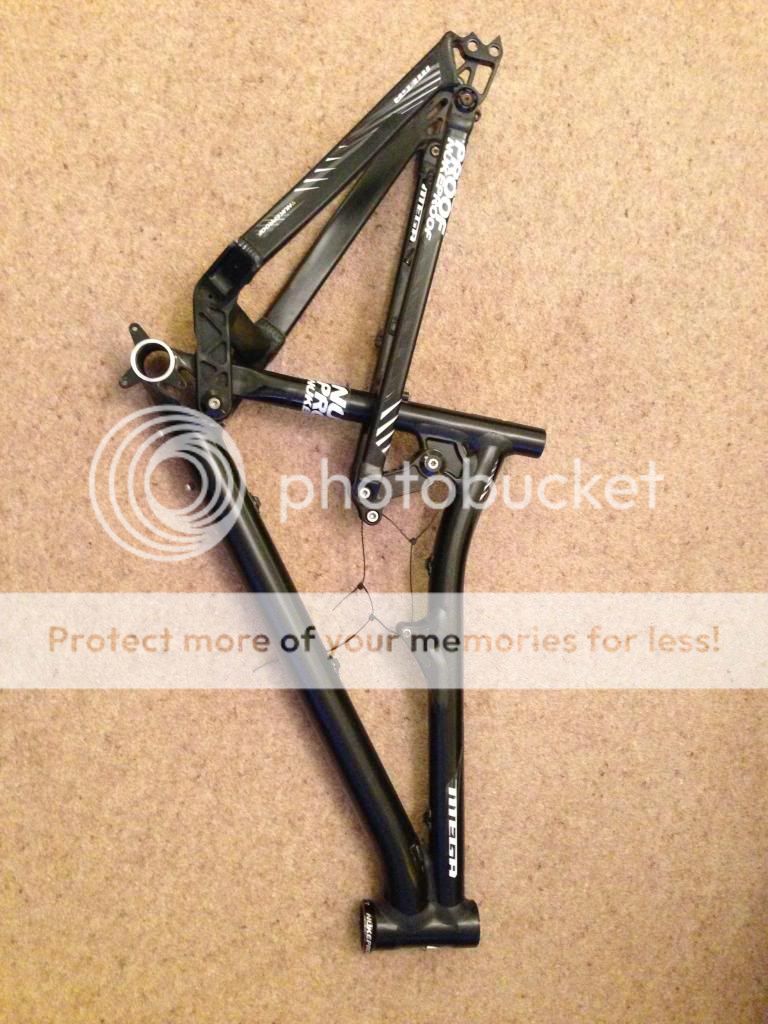

First step was stripping down the Patriot, the forks have sold, but the frame/shocks/chain device etc is all up for sale if anyone is interested give me a shout.

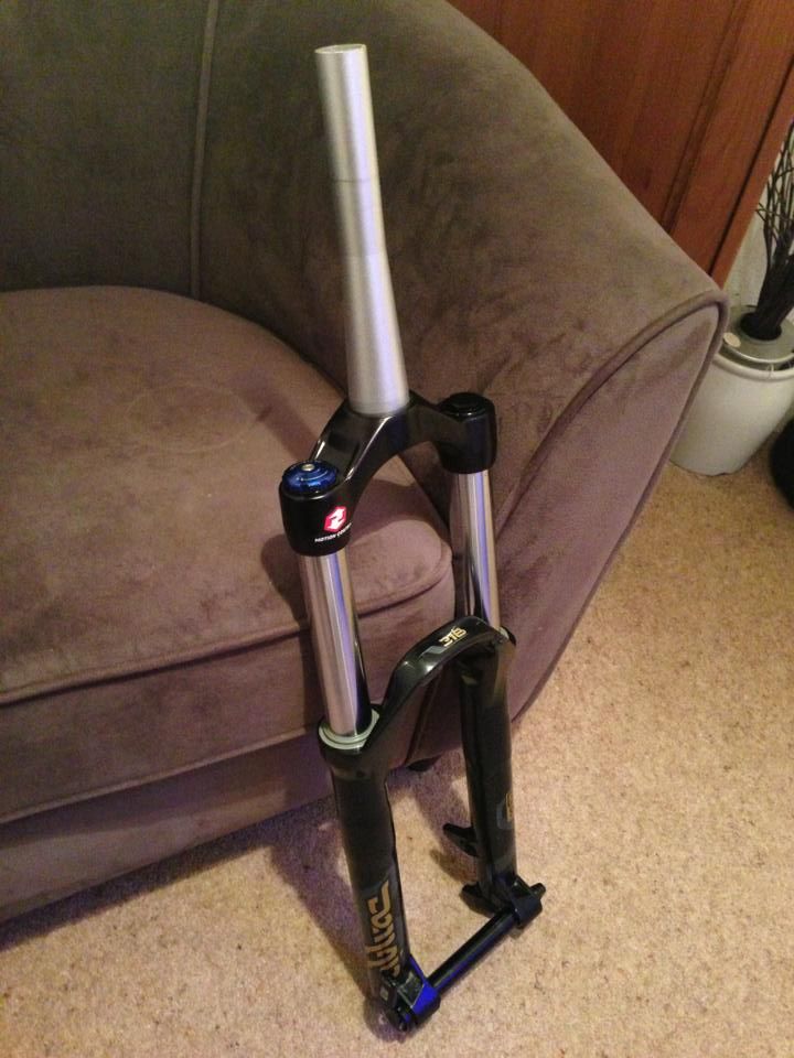

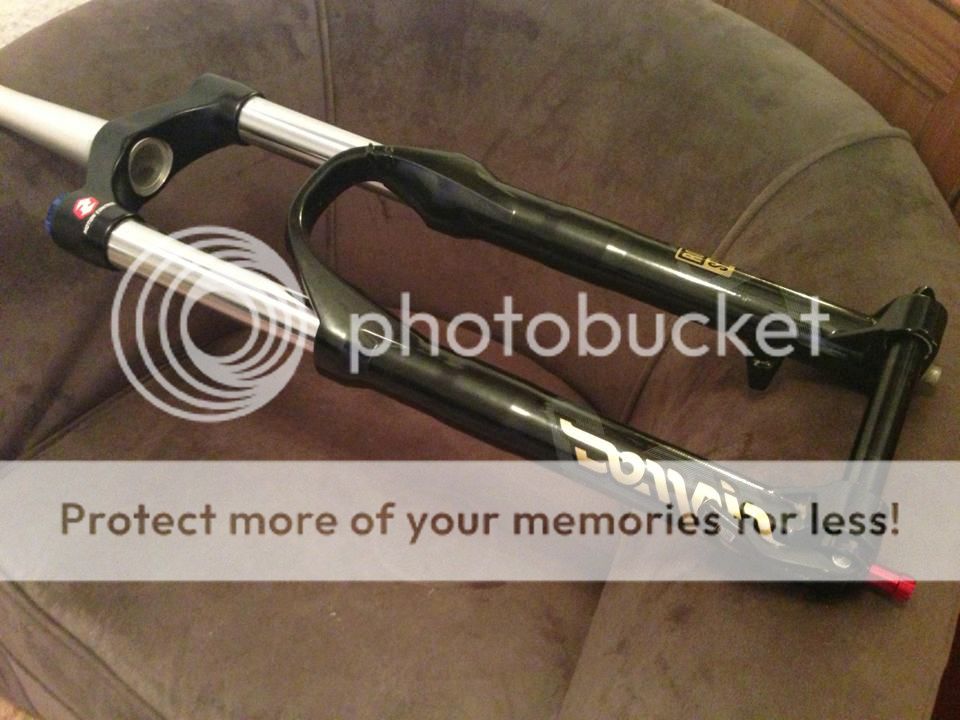

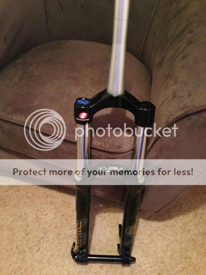

The first part of the puzzle arrived on Tuesday, a set of 160mm Rockshox Domain 318 in black with a tapered steerer.

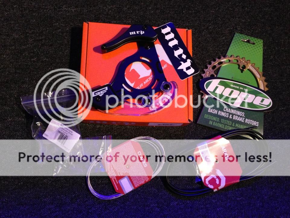

Second part of the puzzle arrived early yesterday, A Hope 36T chainring, MRP G2 mini chain device, a seat post shim, and shifter cable and outer.

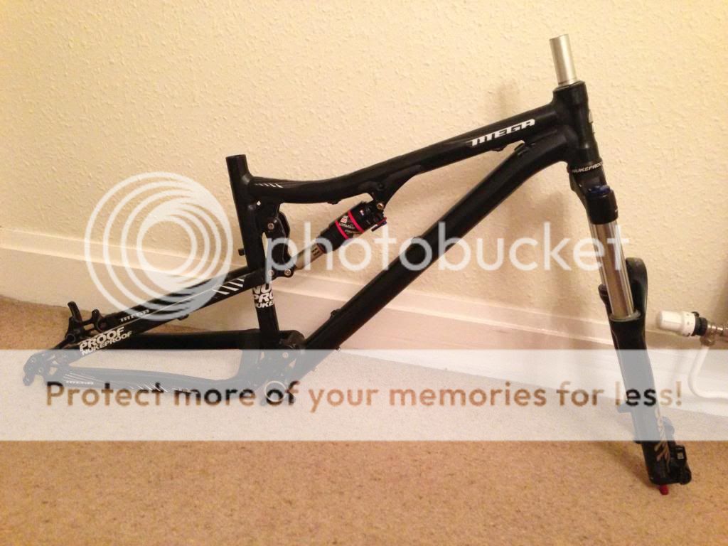

And then when I got home from work last night I had this waiting for me.
Ohhhhhh stealthy.
I wanted to check all the headset was present and working so put the bits together.
Then I got carried away as I had an hour to spare before I had to be anywhere.

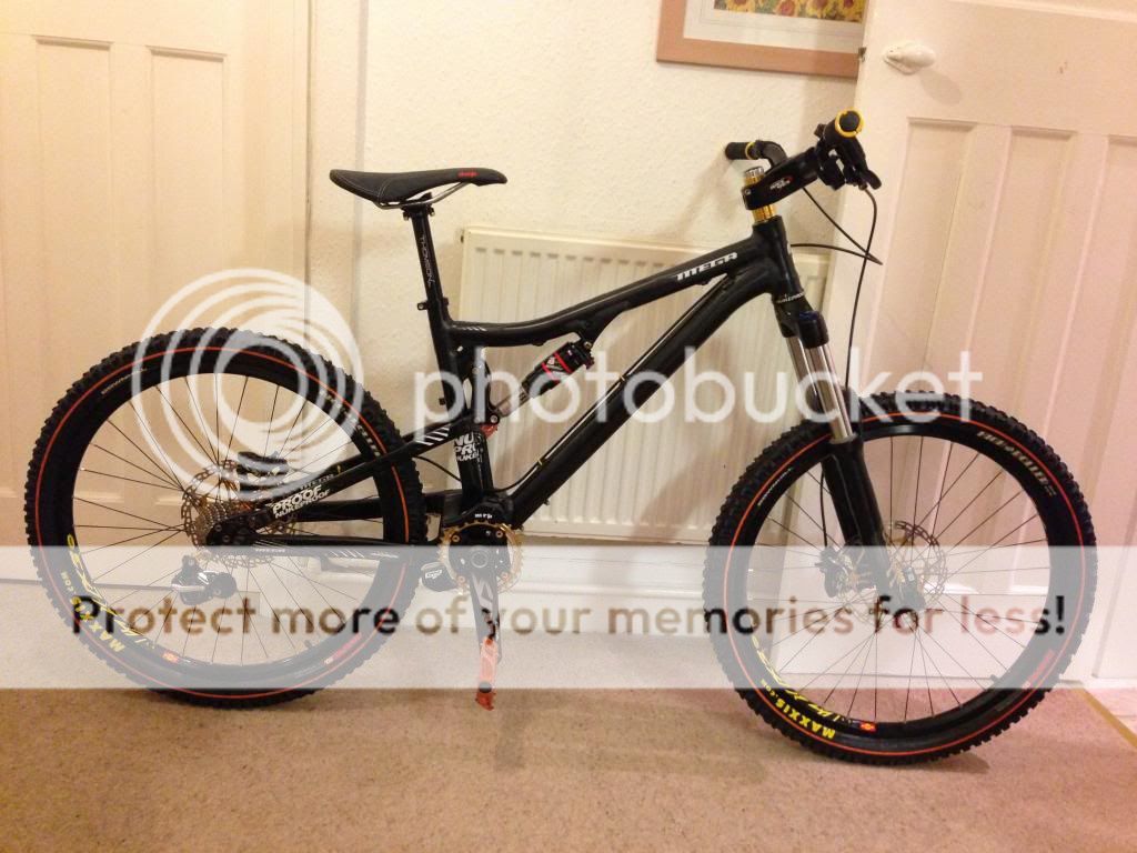

Decided that I needed to test fit as much as I could so i could order anything I needed before the weekend as Im aiming to get out on it on Sunday. After an hour I had to give up, but its 90% complete
REALLY pleased with it so far, Had to order a few little bits from CRC today, including a shock pump as the shock is sagging about 70% into its travel when I'm sat on it.

Finished it off today, got the rear shock pumped up! It at about 250psi now! Just to get me at 20% sag, but it does feel good! Only had a quick blast around the street, off a few steps, but its a lot plusher than the patriot.
The front fork needs a stiffer spring in it, which I'll do in the next few weeks, along with a shorter stem and slightly wider bar, now I've decided on combo, but that's another £100.
The headset/stem looks better now I've put the gold hope spacers on with gold hed doctor.
It's very very wet here today so unsure I'm gonna get out on it this week now though! Will see! It's gonna be interesting to ride, its very different to the patriot... Long rear stays mean it takes more effort to get on the back wheel. All good fun though I guess!
