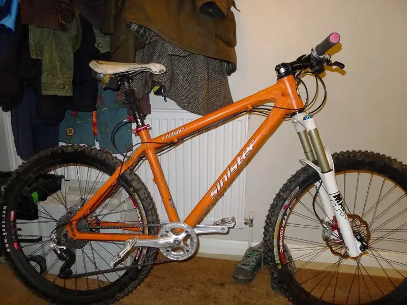

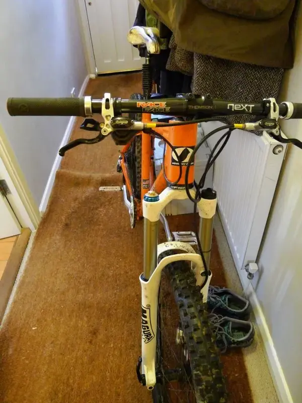

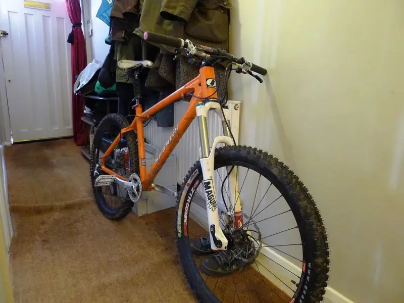

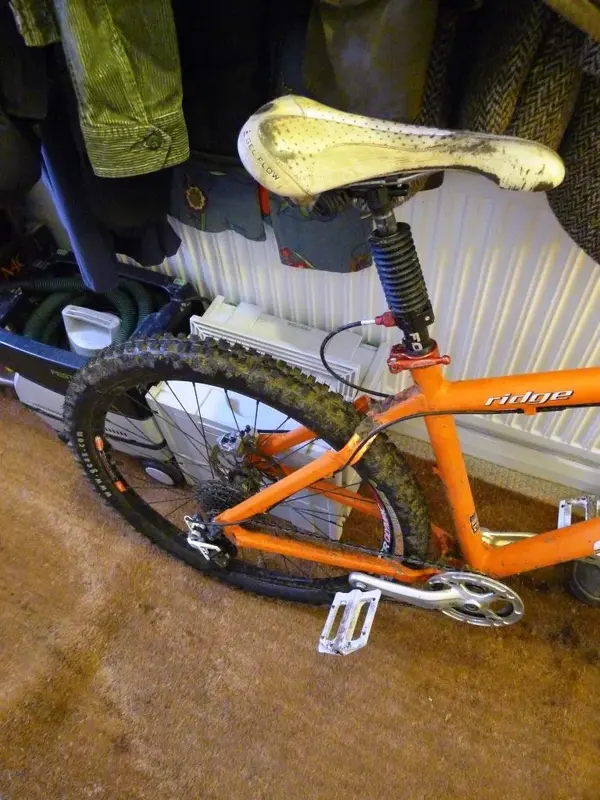

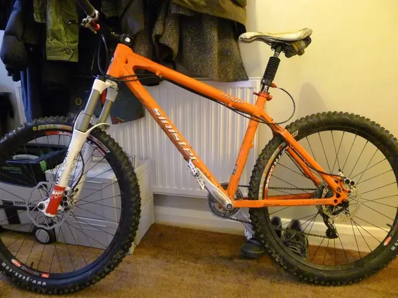

I acquired this frame in a swap on RB from IWish here http://www.retrobike.co.uk/forum/viewtopic.php?t=196817&postdays=0&postorder=asc&start=0
I wanted to build up a winter thrasher that was cash neutral, so this bike is made up of parts that I already had, traded on RB or purchased from the proceeds of surplus parts sold on RB.
I already had a Magura Thor with 140mm travel - this is borderline long enough for the frame, but it had a very short steerer, so I had to buy a Hope internal headset top cup.
The only other bits purchased were a new shadow plus XT rear mech and 10 speed Saint shifter, and flat pedals. Total new spend has been about £150.
The rest came out of the parts bin.
Spec as follows:
Frame: Sinister Ridge (2006?)
Fork: Magura Thor 2010
Headset: Hope internal top cup/FSA bottom cup
Stem: Thomson x4 80mm zero rise
Handlebar: Race Face Next carbon, flat 630mm
Grips: Kona lock on
Barends: NA
Brakes: Hope Mono M4
Brake rotors: Magura 180mm F/160mm R
Shifters: Saint 10 speed
Front Derailleur: NA
Rear Derailleur: XT shadow plus
Derailleur Cables: Gore
Cassette: XT 11-36
Chain: Mavic 10 speed
Cranks: Truvativ basic jobbies 170mm 104bcd
Crank Bolts: ?
Chainrings: Truvativ 32 tooth steel with Hope bashring
Chainring bolts: ?
Bottom Bracket: Shimano UN52
Pedals: Nukeproof electron
Hub Skewers: Maxle front/XT rear qr
Rims: Stans Olympic
Hubs: Hope Pro 2
Nipples: DT Swiss 14mm prolock black
Spokes: DT Swiss Comp black
Tyres: Geax Datura tubeless
Tubes: NA
Saddle: Ancient Selle Italia gelflow
Seatpost: Forca dropper post
Seatpost Binder: Hope qr
Weight: something around the 27 pound mark
It's great, a lot of fun to ride and it's the bike I hoped my much more expensive Nicolai Argon was going to be. I have even learned to ride up steps - up to about a dozen now depending on steepness.
I've gone back to flats after 20 years of spds and I'm enjoying them.

A wider bar would make all the difference in the world.
PostPosted: Thu Nov 29, 2012 8:29 pm
Joined: Thu Nov 09, 2006 11:19 pm
Posts: 1939
Location: Gwlad Gwlad to be here
I did have a 680mm bar on it but most of the tracks I ride are narrow and through the woods so I went back to the 630mm wide bar. If I was off to serious big mountains then I'd stick the wide bars on again.

Very nice. Seems small, what size is the frame?
PostPosted: Fri Nov 30, 2012 5:26 pm
Joined: Mon Mar 12, 2012 10:24 pm
Posts: 338
Location: hemel hempstead, england.
long travel hardtail, all the bike you ever need :D
PostPosted: Sat Dec 01, 2012 11:30 pm
Joined: Mon Nov 20, 2006 10:12 pm
Posts: 4765
Location: Barry
Love it- great looking bike. Impressive parts bin!
PostPosted: Mon Dec 03, 2012 5:01 pm
Posts: 1939
Thanks gents. Yes, the parts bin had built up and I had lots of things that I didn't want to sell so I just had to get a frame to put them on.
My riding style isn't extreme - but I'm pleased how well the Stans Olympics are holding up.
The frame isn't so small. It's a 17.5" centre to top seat tube and 23" top tube (actual) or 22" virtual horizontal.
