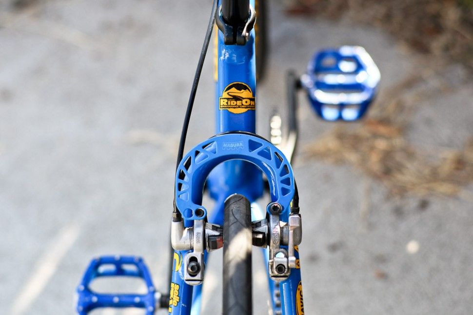

I found that the seatstays flexed outwards a bit under heavy braking, so I looked at buying a nice CF brake booster for the old V-brake on there, but was talked into slinging an HS33 on the back instead. Loved it, a proper fit-and-forget item. Didn't buy a front one as the forks just didn't need it.

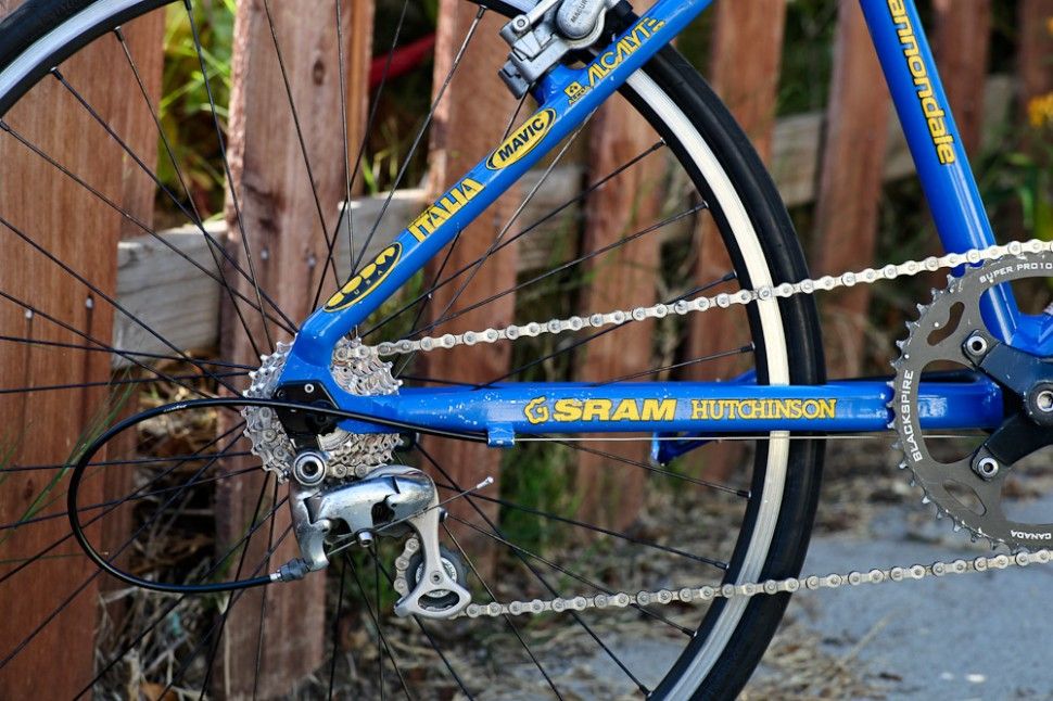

The bike stayed like that for a while, and then inevitably my rain-soaked 20-mile-a-day commutes killed the rear hub. I had Merlin build me up a 36h X618 CD on a black Hope XC hub, and that rear wheel is still on the bike today. Bombproof.
I later had Condor Cycles build a 32h X618CD onto my front LX hub once the old X517 had reached the end of its life.
As bits broke, I bought nicer bits as replacements - an old Deore DX shifter was replaced with an M952 XTR, the old Turbo saddle with a Selle Italia SLR Trans-Am, bars & stem upgraded, etc.
Rear mech is now an RD-6500 Ultegra, and cassette is 6500 Ultegra 12-23T 9spd.

the bike definitely deserves a front HS 33 wink:

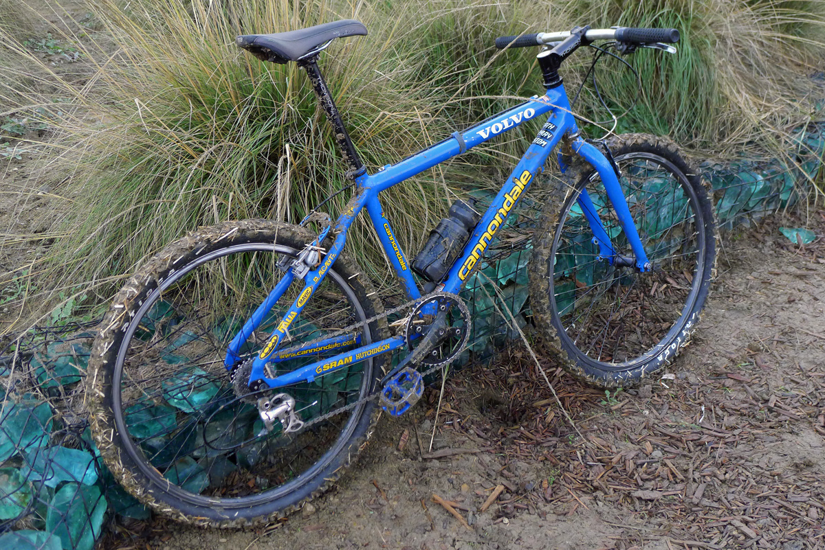

Headed out to watch a local CX event yesterday and decided to take the Cannondale as a pit/spectator bike.
Needed a little modification, so off came the slicks and on went a set of Tioga Factory XCs I bought years ago. 46T front chainring was replaced with a 42T.
Road seat was replaced with an SDG Bel-Air that the wife had sitting around. I've also recently acquired a wider (ie uncut) set of silver flat bars, marked HyperLite Easton EA70 / Cannondale Competition. :)
