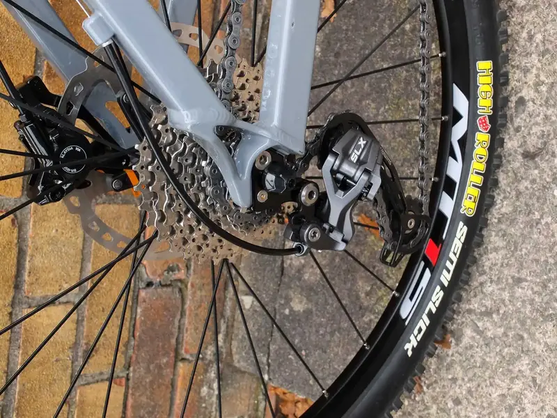

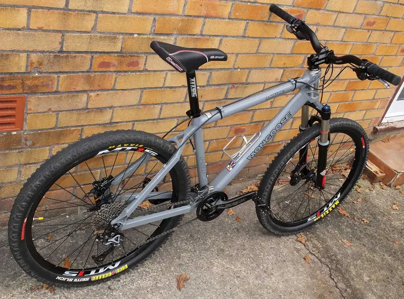

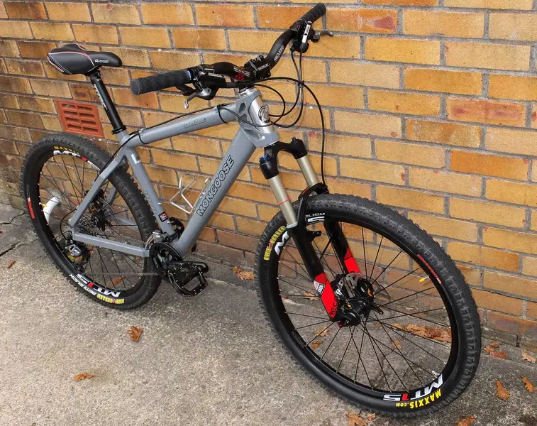

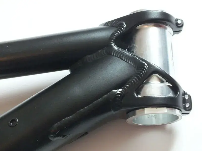

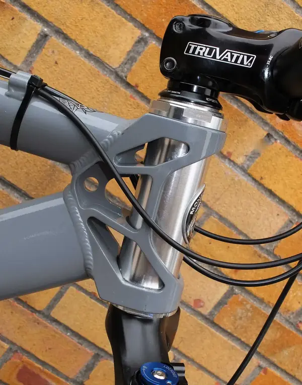

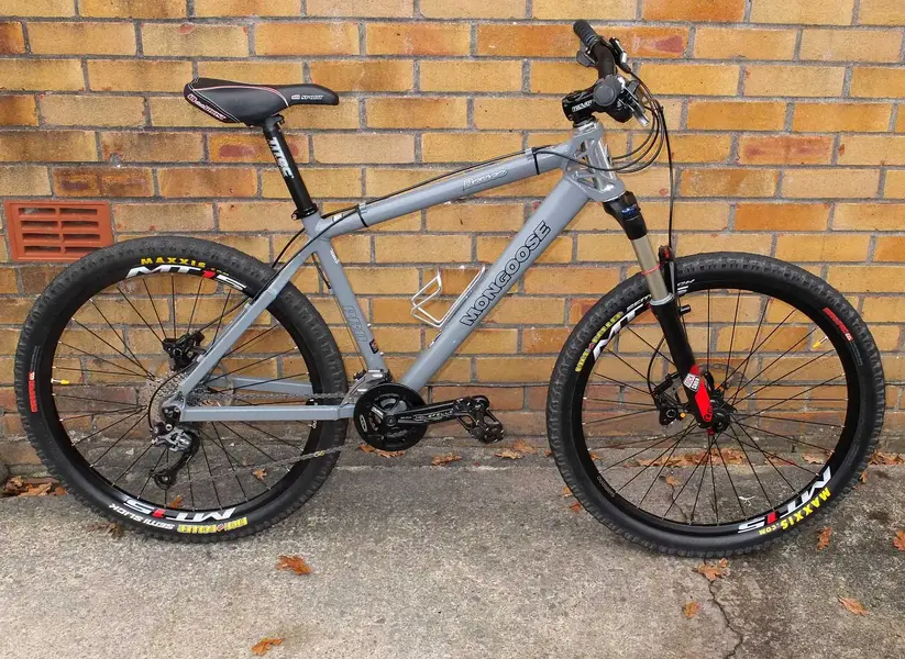

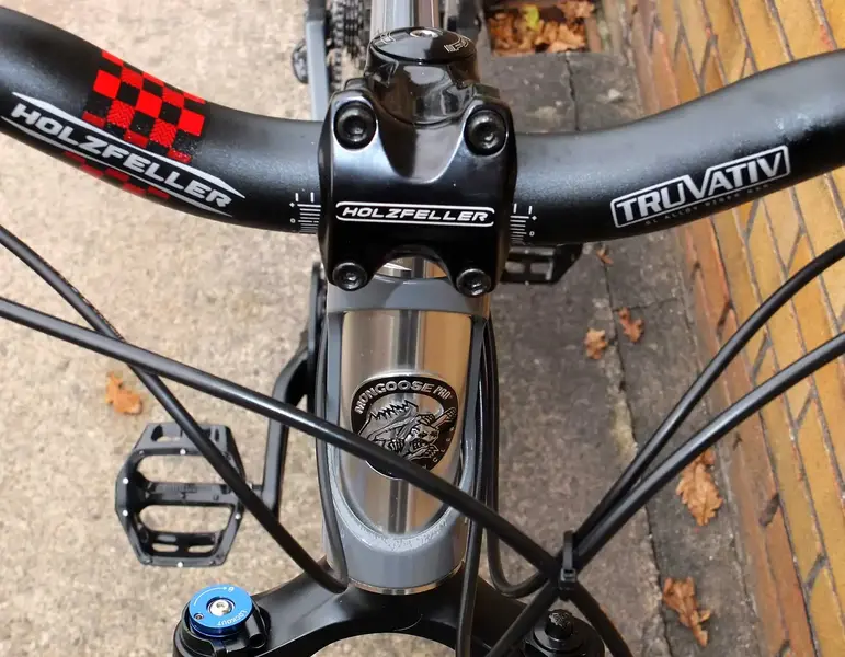

Recently picked up this somewhat rare and unusual frame. I have scant information on the frame as there is hardly any info out there, but it seems to have been produced from 2001 for a few years. The frame around the headtube is unusual in construction being skeletal and adjustable for head angle. The frame is very nicely made but it's not exactly a lightweight, it was obviously not aimed at XC weight weenies. I like the nondescript grey colour so decided to keep it grey/black so won't excite any Klein fans. There are one or two small marks on the frame that need touching up if I can find suitable paint, but I'm not too bothered, its just a fun bike.
A large number of parts have come off my Giant Anthem which has recently gone through a major upgrade process. Here's the spec:
Frame - Mongoose Deuce Pro
Forks - Rock Shox Recon Gold Solo Air 120mm
Shifters - Shimano SLX 9sp pair
Rear Mech - Shimano SLX 9sp
Front Mech - Shimano Deore
Chainset - Truvativ Holzfeller 36-24 and bash
Chain - Shimano HG93 9 speed
Brakes - Shimano Deore BL-M596 f/r
Disks - Shimano SLX Centrelock
Handlebars - Truvativ Holzfeller 700mm black
Stem - Truvativ Holzfeller 60mm black
Headset - FSA IS2 Semi integrated
Grips - Giant lock-on
Seatpost - Titec 31.6 Black
Saddle - Club Roost CR Sport
Rims - Shimano MT-15 black
Hubs - Shimano
Cassette - Shimano HG61 9 speed
Tyres - Maxxis High Roller semi-slick
Pedals - DMR V8 black

Headtube is pretty cool, I like it. Nice to see something a little different.

Ditto, love the head tube detail. Similar to a Scott(?) DH bike.
Hey you're right. I've never seen a Scott Octane before. The headtube on the Mongoose can be rotated 180 degrees to change the head angle. It's currently set to slackest, I don't know the actual angle as I can't find any info about the frame. Looks to be a change of about 2 degrees.

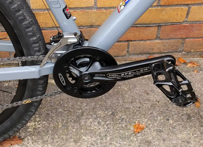

is that a 3 speed front mech used with 2 chain rings - the bottom of the cage looks to be very close to the chainstay plus is it quite a way from the rings.
Yep, you got it. Repositioned the mech as close as I could to the outer ring which gives me about 2mm clearance between the bottom cage and chainstay, wind in the H adjuster so it goes no further than outer ring. It all works smoothly.

That is truly a lovely bike....first time I have felt the need to comment on someones ride.....Loving the understated grey and the head tube is just pure art!
Want that one!
