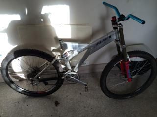

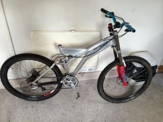

Started the strip down today in between cars
Removed saddle
Removed all cables and handle bars, brakes
Wheels removed and it looking very sorry for itself (I have got a bike stand and will put it on it when she comes back from the powder coasters)
So tomorrow I will remove the cranks, bottoms bracket, removed the headset bearings, front and rear shocks, and start blanking off holes. I will be weighing the bike before it's goes to see how much the powder coating weighs, having looked at the items that have come back does look like he puts in on that thick.

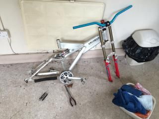

Well continued the strip down today
This is my home weld of a butchered a2z adaptor, a bit crude looking at present but will file and clean it up before powder coating happens
Need to find out where to get bushes for the end or go bearings not sure yet
Box of all bits I have taken off

That welded adaptor .. Surely that weakens the area that is stress bearing? Ie around pivots? I'd have run a magura on the back to be honest.
 Post subject: Re:
PostPosted: Sun Oct 26, 2014 9:48 pm
Joined: Sun Oct 14, 2012 8:26 am
Posts: 321
To be honest I don't think it does it's survived a rather tough wales trip, nothing has been removed from the bike, it goes over the topic the joining weld and was all clamped tight and measured to make sure nothing dis-figured from the heat, so personally I would think it would strengthen it,
