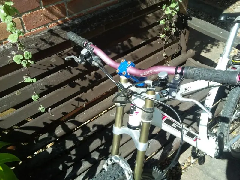

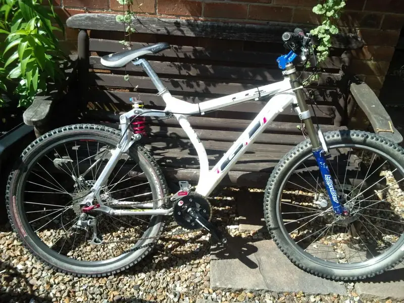

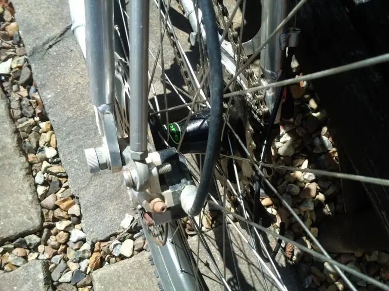

here is some pictures taken before i got it pretty much.

Doesn't look that bad...the chain device is missing the bottom roller though.
If you want to convert it back to a triple ring set up, you could just add the required rings assuming that the previous owner just ditched the middle and granny ring. Either that or try and pick up some old school Race Face.
Brake wise, I'm not a fan on the C2's especially with the sport lever, so I'd probably go down the route of maguras. The rear brake set up is pretty sort after, so you could recoup / make money on that. They've gone for crazy money on flea bay. Rims will be fine; it looks.like they've been used with rim brakes at some point.
Personally I'd lose the stem too...it's an abomination! I remember when they were all the rage...dark, dark days! Don't think it will take much to to turn it around.

ur goin to have issues as soon as u take the c2 brakes off as the rear axle on the wheel is designed for the hope c2 brakes (its a no 2 caliper )
and the rear bolt is a harded bolt and needs a bushing on it for the rear shock even then ive bent a std one so i would be careful if u put another bolt in there

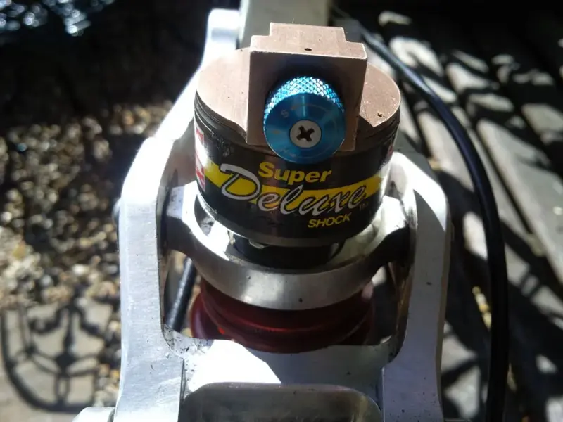

Maguras do suit,
Do's this image help at all if not I try and take one in morn
PostPosted: Wed Aug 22, 2012 6:30 am
retrobike rider
retrobike rider
Joined: Sun Dec 18, 2011 10:42 pm
Posts: 2202
Location: milton keynes
Thats nice have you got a picture of the bottom of the rockshox with al its associated spacers ect?
