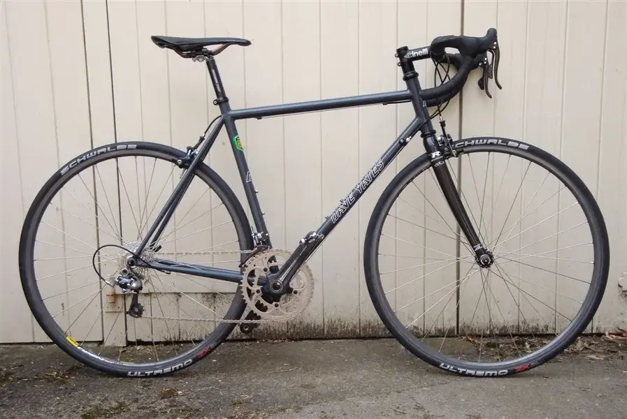

New 853 frame
Slightly retro Campagnolo Record 10 speed

How does it ride? Have you weighed it?

It weighs 8.6kg with pedals (just under 19lbs). 8.3kg or 18.26 lbs without pedals. I could drop the weight a bit further with a titanium cassette and lightweight inner tubes but it feels fine as it is. I was pleased to find some NOS (non-integrated) Reynolds carbon forks to go with the frame. I am very pleased with the way it rides but I have yet to take it up and down any hills, so far just a short 10 mile spin to check all is working.

Looks good. Like Dave Yates. 8)

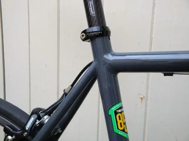

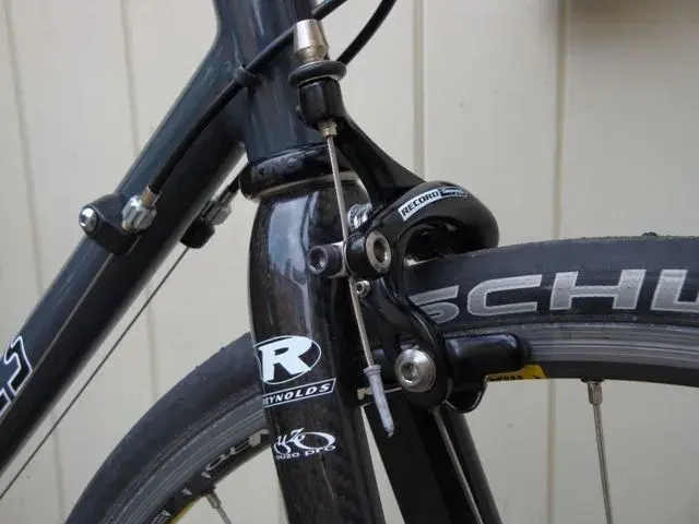

Some details

Is your seatclamp on the right way round?

Thank you for the comments. For a carbon seatpost the clamp is the correct way round. The instructions which came with the Campagnolo seatpost were quite clear that the gap in the clamp should not line up with the gap in the seat tube. The same advice came with a Fizik carbon seatpost I fitted on a friend's bike. Any other opinions about this are welcome. The Campagnolo Record seatpost came with a 31.6 - 31.9 clamp but this is too large for a Reynolds 853 seat tube so I used the Thomson clamp. I asked Dave to put the split on the front of the seat tube to protect it from road spray.

Just looked at the instructions that came with the Thomson clamp which say "conventional, collar slot inline with frame slot - carbon, collar slot rotated 180 degrees away from frame slot".
