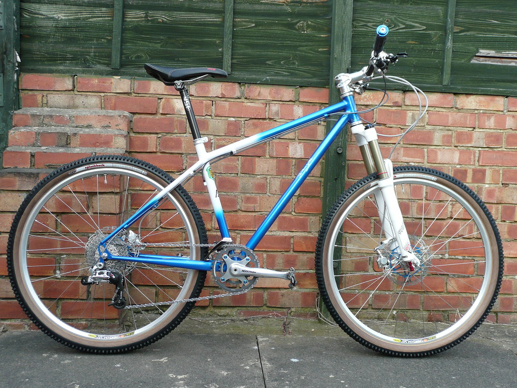

I wanted the frame to be as clean looking as possible & the theme for the build was as much UK made or at least stuff from UK companies

P1030230 by Andy B72, on Flickr
P1030239 by Andy B72, on Flickr
P1030244 by Andy B72, on Flickr
P1030237 by Andy B72, on Flickr
P1030231 by Andy B72, on Flickr
P1030240 by Andy B72, on Flickr
Frame: Fully fillet brazed Reynolds 853 main tubes, Columbus Zona chainstays, Reynolds 525 seat stays & head tube
Forks: Rockshox Reba RL 120mm
Bars: USE Atom Carbon
Stem: Hope 90mm x 0°, 25.4mm clamp
Headset: Hope
Grips: Superstar
Bar Plugs: Hope
Front Brake: Hope Tech X2
Front disc: Hope Floating rotor 183mm
Rear Brake: Hope Tech X2
Rear Disc: Hope Floating rotor 183mm
Hoses: Braided
Shifters: Sram X0
Cables: Shimano XTR
Front Mech: Shimano XTR
Rear Mech: Sram X0 medium cage
Seat: Charge Spoon Ti rails
Seat Post: USE Sumo Carbon
Seat Post Clamp: Hope
Cranks: Middleburn RS8 X type
Chainring(s): Middleburn hardcote 26t/39t
Chain: KMC 9X SL
Cassette: Shimano XTR
Pedals: Shimano XTR
Bottom Bracket: Hope Stainless Steel
Front Wheel
Rim: Mavic XC717 Disc silver
Spokes: DT Swiss Revolution
Hub: Hope Pro II Evo
Tube: Schwalbe lightweight
Tire: Charge Splashback 1.8"
Back Wheel
Weight: 24.75 lb/11.2 Kg
Other info: head angle 68.5° Seat angle 70°
Completely unique (yeah it's a custom frame...) as Dave has never used his signature on the downtube on any other bike (he quite likes it too!)
Curved seatstay bridge
No chainstay bridge
73mm BB shell
Front facing slot in seat tube
Cable mounts for dropper post

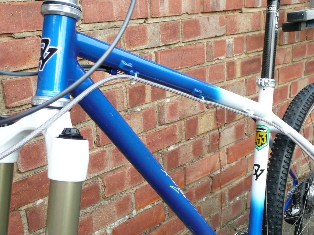

What's the other set of tabs for?

Beautiful ~ particularly liking the drop-outs and rear disc mounting. What are the extra hose guides for on the left side of the top tube? Time to hit the trails and give it a good thrashing!

I'm assuming its a spare cable run for a dropper seat post remote?

Yeah the 2nd set of guides are for a dropper post when I run one, thought it best to get the mounts fitted as I do like the dropper post on my Cube.
