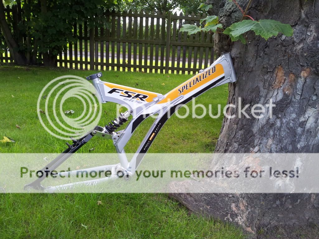

Frame was on eBay as spares/repairs as the main pivot point had a lot of play.
The frame was delivered last Thursday.
The main pivot point did indeed have a lot of play, simply because the bolts holding the chain stays on, WERE SLACK!?!?!
I tightend them up, and not it has no more play, :lol: :lol: :lol: :lol:
Approx 1 hour later i had transferred a fair amount of gear from my 1998 FSR comp, onto its new home :-)
It needed a few parts to finish off, chain/cables and a new headset, these were bought and fitted the following night after work.
Initial test ride was supposed to be a quick blast around the block to make sure everything was ok, i checked the bike out and the rear end has no play that i can tell, infact it feels tighter than the 98 FSR Comp its replacing, the back end suspension defo feels a lot more "active" in use, it apparently has an extra inch of travel over the other bike, so the pivot points must be in a different place, whatever they did, its a total upgrade IMO.

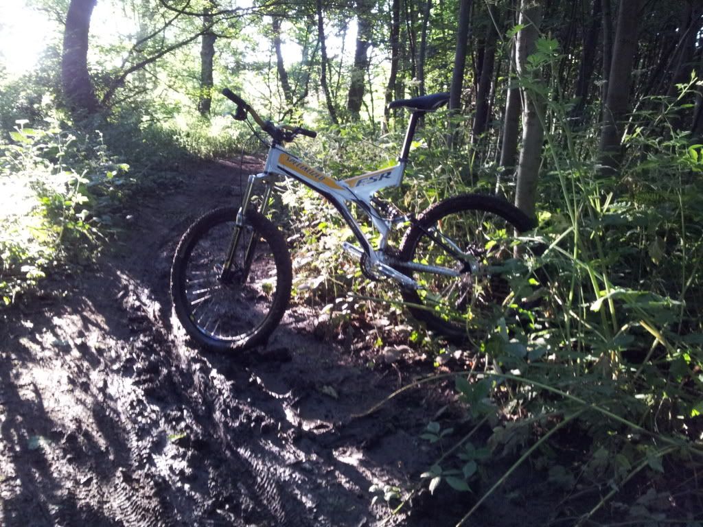

My initial test ride around the block end up being a 25 mile offroad route i have done before as i got carried away :twisted:
The following day (ie: yesterday/sat) i took it for a 32 mile road test to a local airshow, where it preformed spot on, i really love riding this bike!

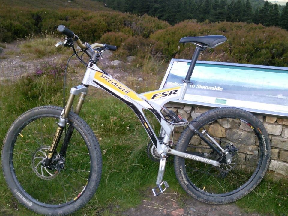

Today i figured i would take it on a club MTB ride, which started out from Rothbury, up towards Simonside.
From here we did the BEST downhill rocky natural trail i have done so far on any of my bikes, around 1 mile downhill at speeds of 30mph (according to endomondo) the bike was AWESOME, it just soaked everything up, unfortuantly the brakes currently fitted are crap, they came fitted to my 98 FSR Comp and i still have not got around to swapping them for some Avid BB7`s yet, i had no confidence in them at all once i started smelling the pads burning, i loved it, brake replacement next on the list!

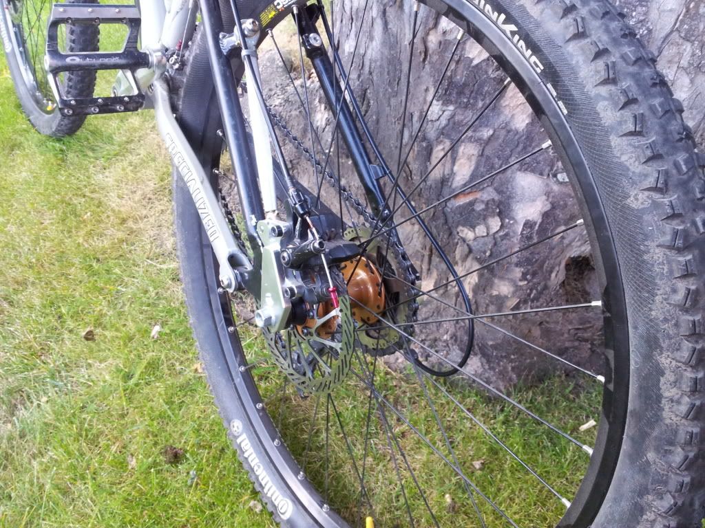

Tektro IO disc callipers (horrible) 203f - 160r
Onza rear disc adaper (sharkfin was missing from frame :( )

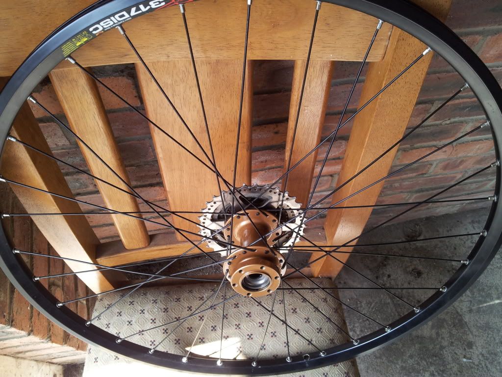

Anyway my rear wheel hub/freehub failed 30 miles into a 40 mile ride about a week ago, the enire wheelset came from my 2011 Boardman Pro HT and had been repaired once under warrenty anyway, i never expected it to last very long, Halfords have a bad press for a reason, they are shit!
Anyway i had sourced some replacement hubs a while back with a view to fit them down the line when the expected failure happened.
I figured i might as well tart them up before fitting them, i initially kept these hubs as the bearing cups were perfect, i have no idea what make they are, its been a long time since i stripped them down, but they did come fitted to a set of Alex Rims that i smashed up about a year ago (iirc they came on my 98 GC)
Cleaned them up, sanded them down and gave them a nice coat of copper paint (same paint i used on the 98 GC)
Fitted to the rim/spokes but not tensioned up yet.

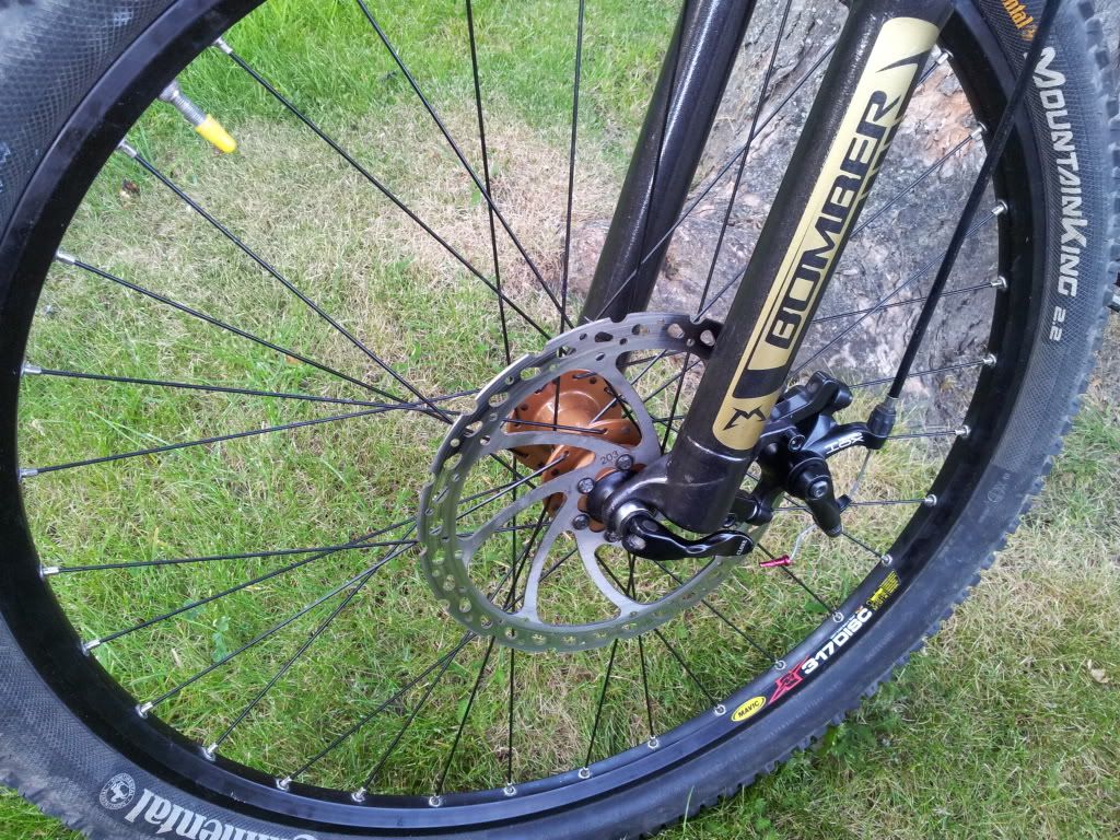

Finished off tensioning the front wheel tonight after work, i put brand new bearings/cones/axle in them, they spin real smooth :D
Really need to sort some Avid BB7`s out, next job on my list!
