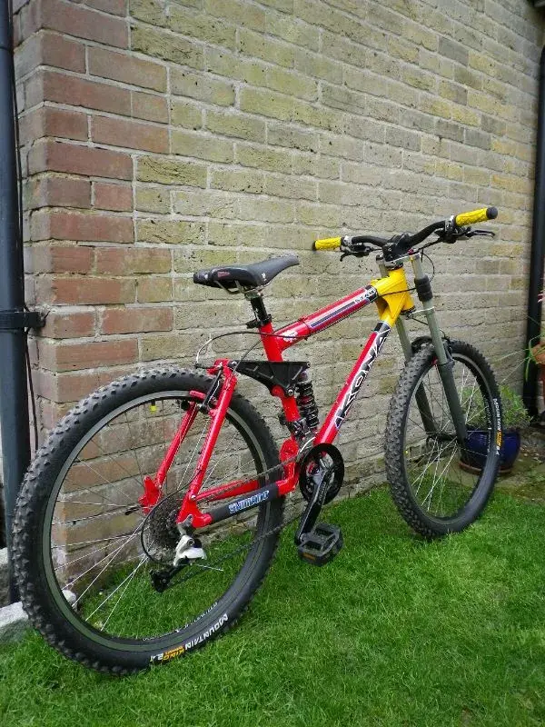

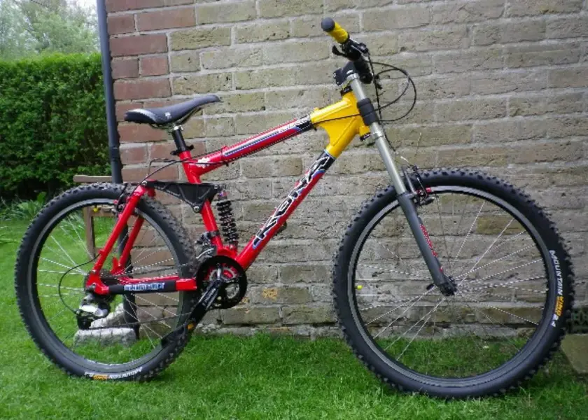

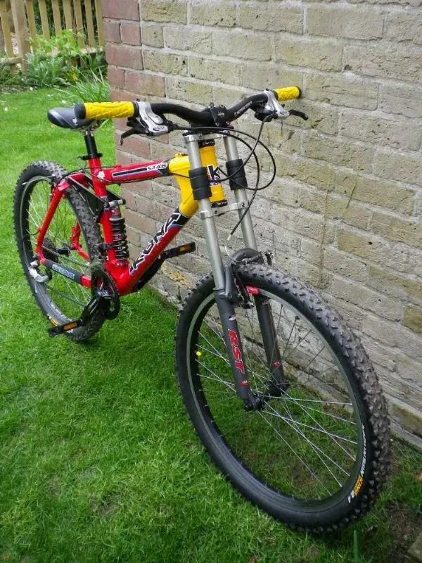

Hi Everyone
Just wanted to share with you some pictures of a Kona Stab I have just finished building for my wife. The build is not a restoration back to factory spec but based around a 1998 Kona Stab frame and intended as a fun bike. So hope you like it?
The spec is as follows with most items being secondhand (fleabay etc)except for the tyres and headset:
· 1998 Kona Stab 17" frame
· Sunline V Two headset
· RST Hi 5 forks (120mm travel elastomer)
· Fox Vanilla R rear shock (came with frame)
· Avid single digit 3 V brakes
· Truvativ Howitzer double chain set
· Hussefelt cranks
· Shimano STX RC rapid fire shifters
· Orange Super Cross OS bars
· Kona 50mm stem
· Yeti grips
· Shimano Deore XT rear mech (came with frame)
· 8 speed Shimano HG rear cassette
· Front mech (not currently fully fitted)
· Kona seat post
· WTB Power V saddle
· Specialized double wall Alex rims (with Specialized front hub and Shimano rear)
· Continental Mountain King 2.4 tyres
Having never attempted to build up a bke from parts before my wife and I are pleased with the results and it ended up being quite cost effective as well. So now it's off to the woods to get it dirty!
I also built up a Kona A single speed for my own use, which I'll put up as a separate post. :D

PostPosted: Thu May 24, 2012 3:40 pm
Joined: Thu Jun 30, 2011 2:54 pm
Posts: 907
Location: Heathfield
Very nice, Loving the colour scheme, you're wife must be well chuffed especially as you say it wasn't too expensive!
It's a 1999 btw, here's a link to the catalogue http://www.klassickona.com/oldgold/99bi ... einfo.html
PostPosted: Thu May 24, 2012 4:49 pm
Joined: Sat Oct 01, 2011 2:23 pm
Posts: 1365
Get some hydraulic disc brakes :lol:
Looks realy mean with those forks.

Many thanks to markwashington for pointing out that it is a 1999 frame as opposed to a 1998, which is what it was sold to me as.
Glad you all like it and thanks for the suggestions as to how to improve it. I do have a set of Kona OS bars but they are a little marked so I used the Orange ones instead that I was going to put on my Pro-Flex. I'll look out for a better set of Kona's then and look to swap them over at some point.
As for the brakes, the frame has caliper mount at the rear but as I scimped a little on the forks (~£40 for the Hi 5's) , these are old school so no caliper mount. But if I do upgrade the forks then I can also upgrade the brakes at the same time.
At present I have not cracked the front mech set up yet. As currently fitted when the chain it on the grannie ring it fouls the frame. So my guess is that I would need to put a spacer between the chainset and the BB? Any suggestions would be much appreciated.
:D
PostPosted: Fri May 25, 2012 6:54 pm
MacRetro rider
MacRetro rider
Joined: Sat Jan 05, 2008 11:58 pm
Posts: 4442
Location: Third stone from the sun.
:D
Could be that the frame is'nt designed for a granny ring, if you look at the catalogue pic it ran a single ring with retainer plates, may need to go up a bit in ring size or just resort to a single ring, make sure the cassette has a 32 tooth big sprocket to help on the hills.
