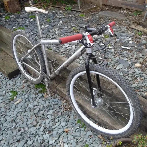

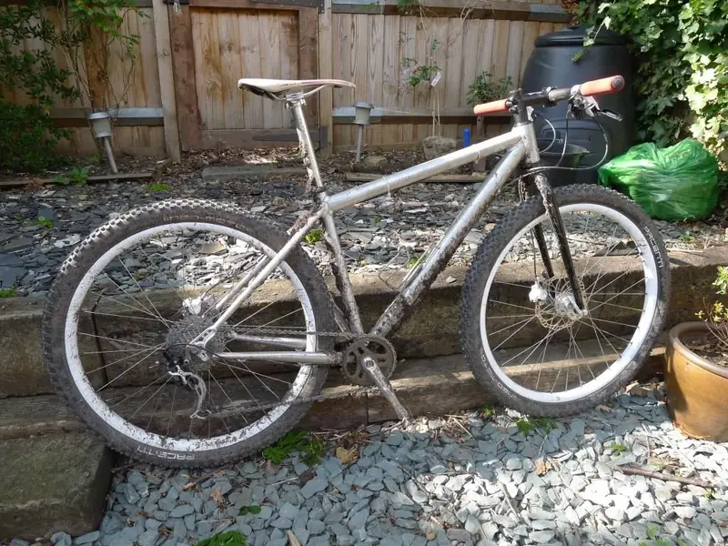

Well, the Darkside had its first outing today. Trail conditions are grim owing to recent torrential downpours. I don't mind a hose pipe ban as long as my bike doesn't get muddy...
Anyway, bit of an hasty build because I am an impatient man. Comes out about 21lbs despite not being built to be light. I wanted a fast cross country bike that would also be strong - so the wheels are Velocity P35s on bombproof XT hubs and the fork is a Vicious (from Nick).
The only thing I'll be changing for now is the stem. The one on there is a 100mm Cannondale Fire stem (very light and made by Syntace) which I will swap for a 90mm silver Thomson x4. The frame is designed to have an external lower cup on the headset so I might swap over to one at some point - but Hope are out of stock at the moment.
Drivetrain is Middleburn Uno (36) with an XT mech and XT Cassette (11-36) with an XTR shifter.
Brakes are Magura Marta SL Magnesiums with 160mm rear and 180mm front.
I likes my ESI grips.
And my wife demonstrating fine Yetiquette... tending to her gold clad ARC.

Gorgeous, but isn't it a nit stiff? I would't even consider riding my FTW 29er without a front suspension fork....

Head angle looks a bit steep- is it the photo?

Thanks. I have the stickers - just haven't decided whether to polish it or paint it yet or leave it as it is - because I'm lazy.
The head angle is steep. That's partly made steeper by the fact I've put an internal bottom cup in the headset rather than the external one it's meant to have. Handles nicely though and I'm used to the steepness from riding my old bandwagon.
