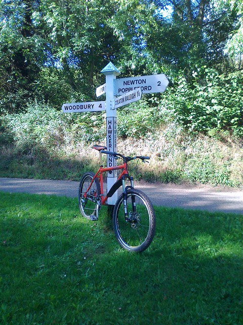

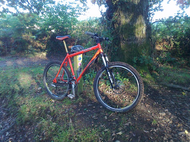

Rough and ready build this..........bought the frame on a whim from STW for £55 on Wednesday :-)
Frame arrived Friday.
Built up Yesterday (mostly bits from my unused full-sus + a new block and chain)
Ridden in anger round a 25 mile loop over East Hill and Woodbury Common today.
Lovely is all I can say! Quite a long frame, feels really planted and enjoys the downs.
Frame: Prince Albert frame 19" - Reynolds 520 tubing
Forks: Magura Phaon forks - 85-125mm adjustable
Headset: WTB Momentum grease-guard headset + Hope Head-doctor
Stem: Azonic Equalizer
Bars: Easton EA30
Saddle: WTB Speed V
Seat Post: OTA CNC
Chainset: LX HTII + Tiagra BB
Rear Mech: XT M760
Shifters: XT M760
Cassette: 9-speed Deore
Chain: Clarks 9-speed anti-rust
Gear Cable: Clarks Pre-lubed
Brake levers: Hope Pro
Brakes: Hope Enduro 4
Cables: Goodridge Hoses
Rims: Mavic Crossland
Hubs: Mavic Crossland
Tyres: Bontrager Jones XR

I know, and it rides gurt lush too ;-)
As it was a cheapie build with stuff I already had I bought a Deore HG50 9spd cassette for £15 and a Clarks 9spd anti-rust chain for £10 from CRC. Amazed how well they shift for relatively cheap kit. Not going back to twice the price SRAM stuff in future!
Here's another couple of pics:
At my favourite sign-post.
Just finished building it up.
I think the full-suss frame is going to be gathering dust for the foreseeable now :lol:
