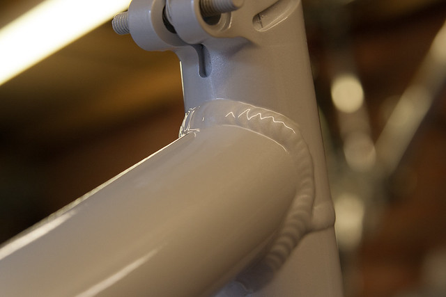

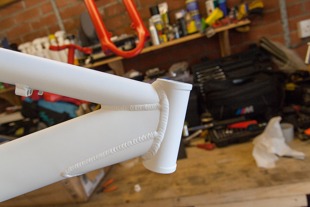

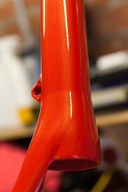

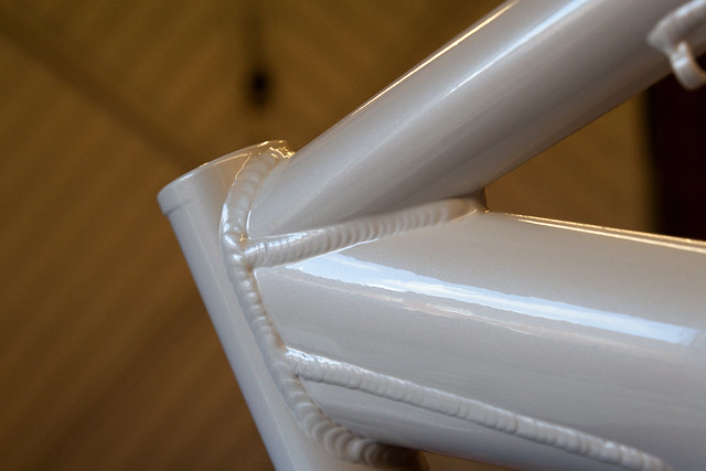

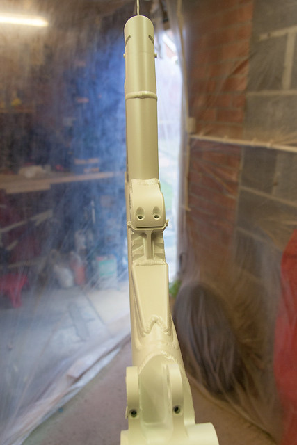

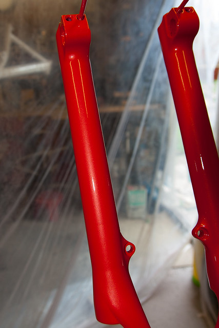

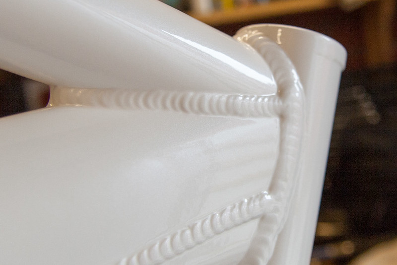

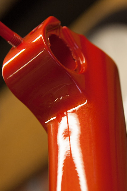

Half way down this thread I talk bit about painting and some pics.
I'm pretty confident it'll be ok, it will cost me a lot of time and piss me off but I'll be happy in the end :lol:
