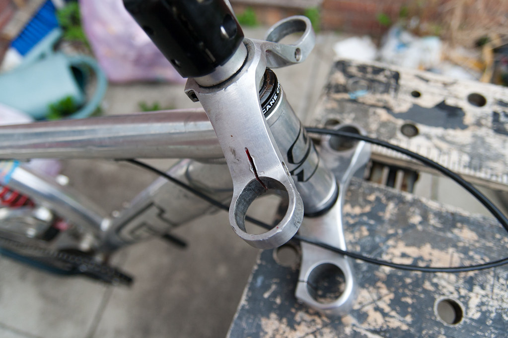

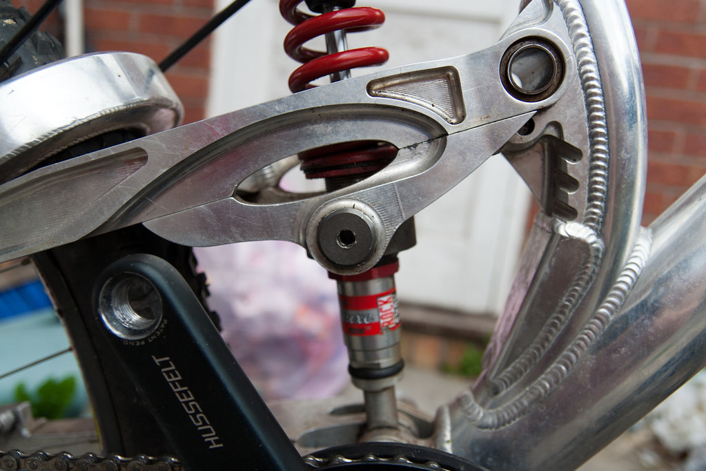

Here we go, sorry for so many pics but some of you will enjoy it! :P :
1/4 inch play in BB, Boxxers make some funny noises and are in a total state, can't make the rear really compress at all, rear axle/spacing/brake is wrong and the wheel sits off centre and rubs left hand stay. Pedals are fecked as are all the pivots, dent in the tubes, broken spoke in front wheel and very bad tension. Rounded trunion bolts and dead headset.
So now I've calmed down I'm just going to get on with it. Money is (almost) no object and I'm going to finsh to high standard. If I can get NOS I will but I'll use whats available.

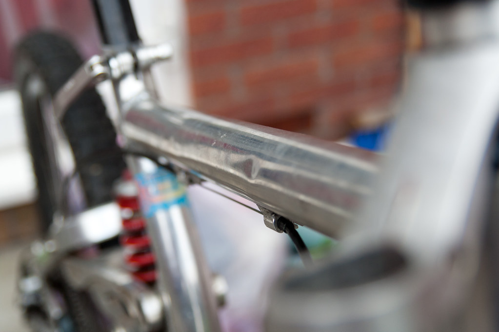

I didn't want to paint it but unless anyone can tell me how to remove the dents its gonna have to go back to its original white (thats the colour inside the tubes) so I can use filler to smooth it all out. I think I'm going to use a pearlescent white, with a 2k clear coat so it should be bodyshop tough, I might paint/stencil some of the decals on too. I can paint to a high standard btw :lol:
I am not going to stay completely retro but will try my best, my fetish for all things red and Hope is going to show through :O somehow he has fitted a no 3 is caliper to thr boxxers with some massive spacers? I already have a 6 pot ti for the front, can't change the rear but I'll get matching newer levers. Headset, QR's, hubs, bb etc will all be Hope.
Boxxers will go back to red. I had already ordered a full frame bushing rebuild kit for the US so that will go on. Can't find a new shock so I hope this one works!

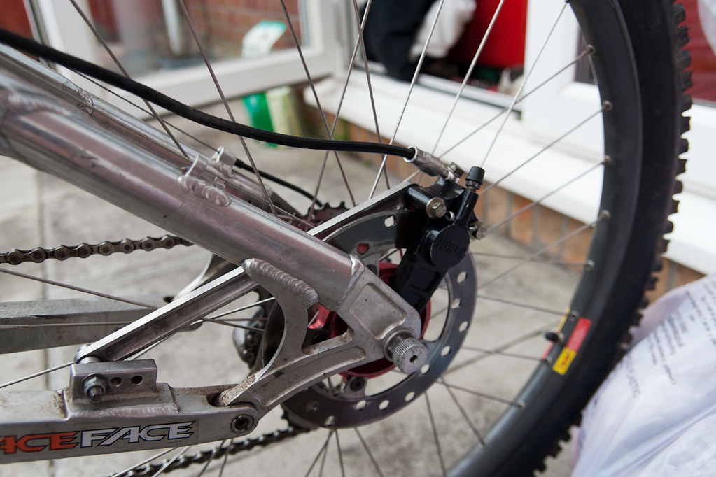

The rear brake setup is fiddly and I'm not quite sure at what point it 'floats', there is a washer that can go in two places confusing it. It seems to cause a lot of stiction in the rear end as it goes through its travel so something is not right.
Had to drill out one of the disc bolts and the other four runined three allen keys but came out in the end. Didn't mark or damage the hub, bearings are good but freewheel is somewhat iffy. Don't have a chain whip so couldn't get it apart, job for tomorrow now. I already have a full set of bearings for the whole hub plus pawls and springs.

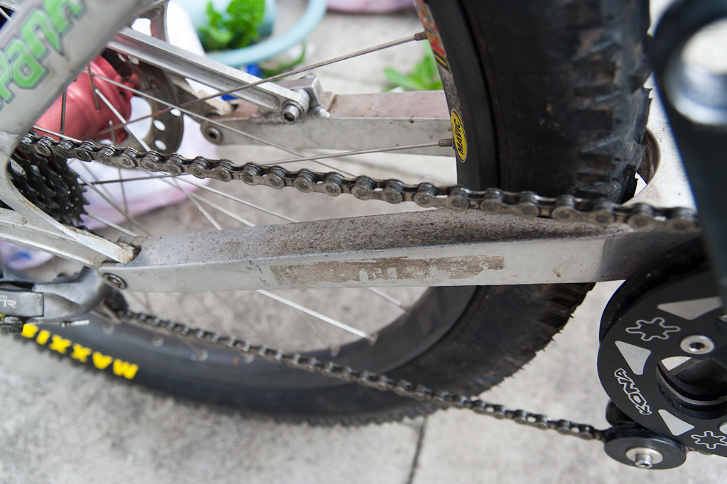

It has a massive 2.5 tyre on there which is too big, I'm aware they always had issues with rubbing plus the wheel sat off centre also which was due to the lower pivot 'tube' being slightly dislodged, pushed it back correctly and its centre in the upper stays but still a little off in the lower stay/swingarm. That said the swingarm is not symmetrical by design so perhaps this is normal.

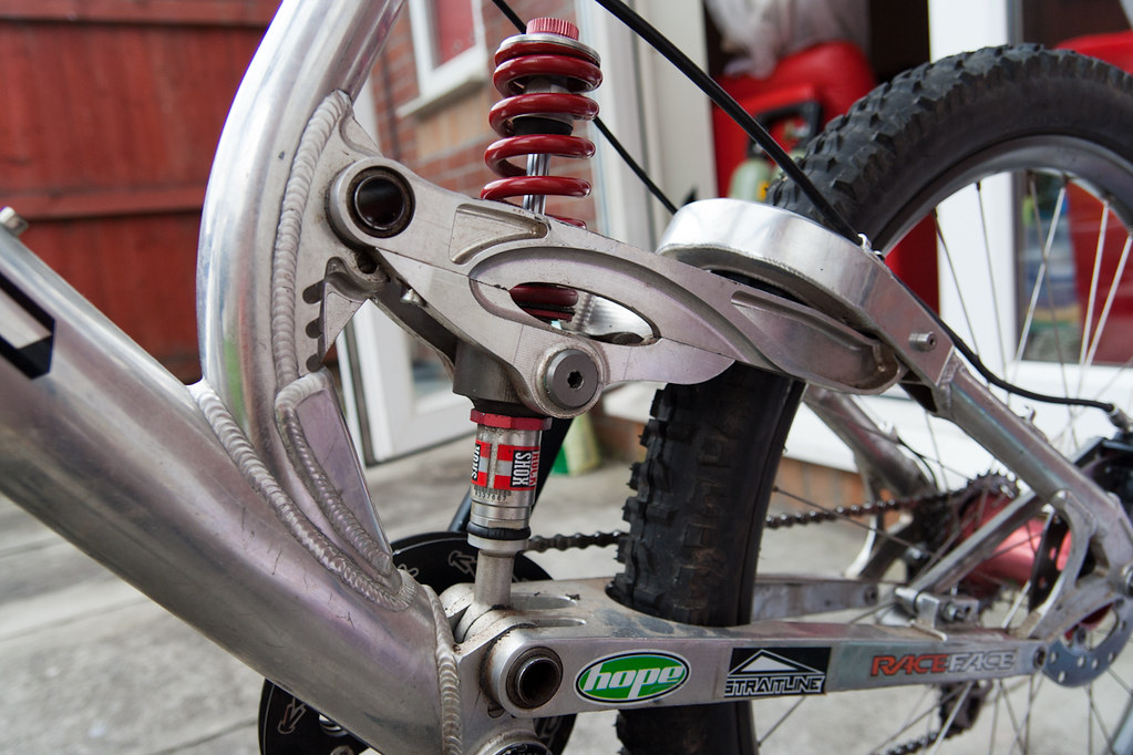

Popped the shock spring off and happy to find there is actually rebound damping! Quite a lot too so hopefully it will run ok, no leaks and it has a full range of adjustment.
Not quite knowing how it should be or the exact order of fitment is annoying, bit overwhelmed tbh, so much to do I don't know where to start / can't focus / depressed. I do know though that before I paint or renovate a thing I need it working as GT intended. Found a few more dents so it is getting painted for sure now.

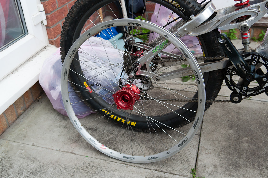

I have some spare wheels, the original Mavics or these? (Another bad deal, never told me he had used a rim brake on the rear, lesson learned)

Pinkbike is great for price but some of the convos I have make me laugh. I had to wait 7 days for one guy to have his driving lesson so he could take a frame to the postie and another guy who delayed a delivery until he had a job interview in town. :oops:
I will make the orginal rear brake work, how well it actually prevented brake jack I don't know but for me its part of the design. I may take the anodising off the caliper and polish it up so make it a bit more spangly.

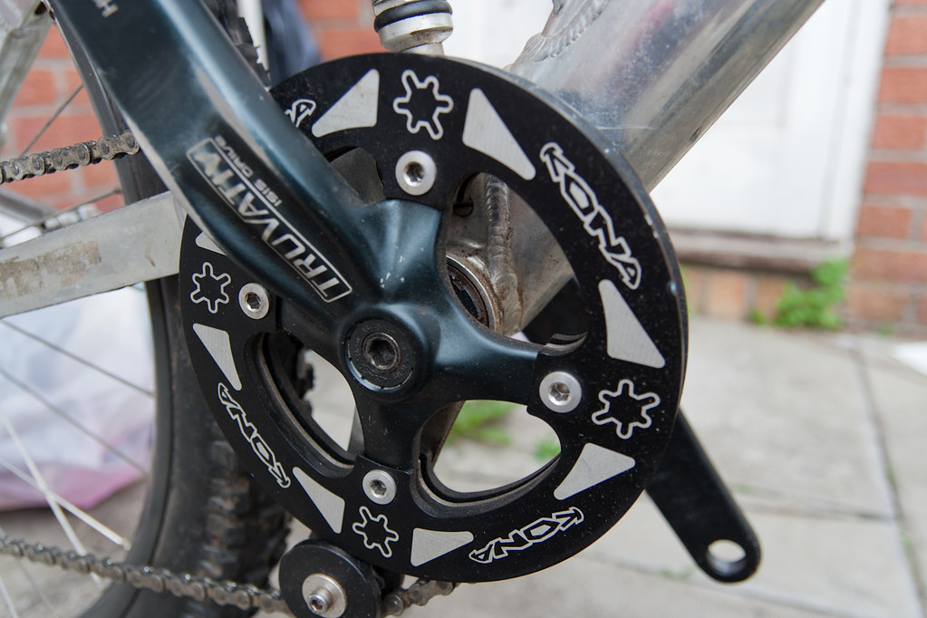

I really need a crank, I have no idea what to buy. I think an original AC will be too hard to find but it cannot roll with a Kona bashgaurd and a Truativ crank :roll: I will spend a bit but I find £200 for a crank hard to swallow, something with springs and pviots and oil yea, but a chunk of alloy? :(

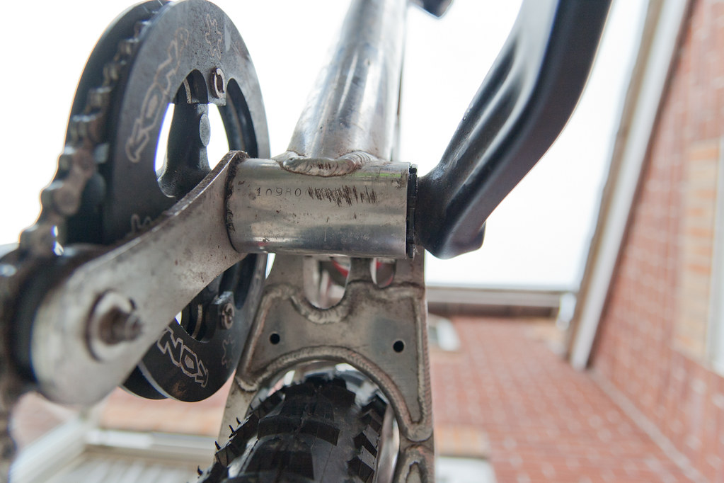

is that just dirt on the bb shell or has some shader scratched out the frame number? shame about the condition when u got it but at least its being saved!

Max tyre width on the rear is listed as 2.2, although from what I've heard, that'll still rub...
AC still make the cranks, Holeshot rings and Postman layback adaptor. (well, it's listed on their website anyway)
if you click the "up" button there's some variations on the crank too.

Thats not dirt :roll:

Figured out the rear brake, the pivot was seized and now its all cleaned up its quite a cool system and I think all parts are present. Caliper needs a full rebuild but thats to be expected. I'm hoping I can run it with a later model Hope lever cos these levers are ugly as hell, it may not be retro but they cannot stay!
