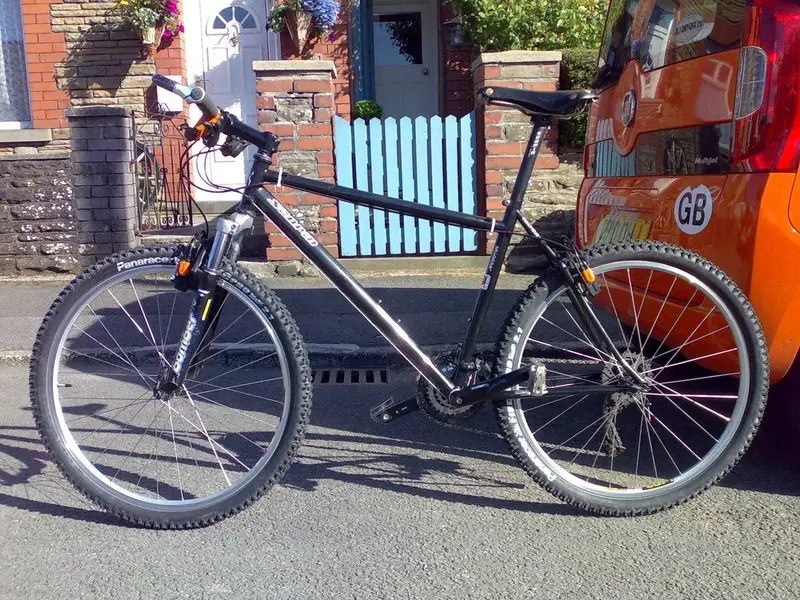

On ebay order is a Ritchey WCS Pro Lite flat bar plus 3T mutant stem that will get me to about 25lb all in.
Crap photo sorry :D
File comment: Frame: Scapin 2003 Rudolf X
Columbus Foco Steel
Fork: 1999 Marzocchi z5 Air 80mm (old, but I like it and it looks good)
Brakes: Magura HS33 limited edition Orange
Wheels: Handbuilt Mavic x517 on Roland/rigida hubs
Groupset: 9 speed SLX / Deore / crap cha

that's tidy mate, love the orange highlights. what length travel on the bombers?

I can't help but think that frame deserves better forks.
I'd imagine they're holding it back big time. :cry:

Bombers are about 75-80mm as far as I can tell.
They're only temporary really. I've scored a pair of Magura Menja 85s (with V brake mounts of course) from fleabay but a seal looks displaced so going to have them serviced before I put them on.
Unfortunately they're white :roll:
As to how far it's being held back (over and above my own uselessness) - I'll tell you when I've ridden it :D

Get the Menjas on there! Excellent forks!
Servicing them is a piece of cake, and the wiper seals can be replaced with 32 mm Fox ones from Mojo for £15. :wink:
Menjas always have leaky seals unless uprated to Fox. Magura argue that while they're leaking, they have oil in there... When they stop leaking, they're dry and need servicing. :roll: The rest of the fork is top rate , super stiff, perfectly damped , and will help you get the best out of that lovely frame

Cheers sub - if that's the case & they all leak I'll just order some brake lugs and get them on to see how they go.
Will take me a while to work out the permutations of adjustment, coming from a fork which ha one valve per leg and that's it!

Start off with one psi per kg of body weight, and full rebound less 4 clicks.
They're a lot easier to set up than old Marzocchis! :wink:
