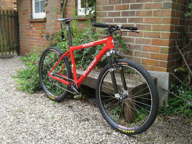

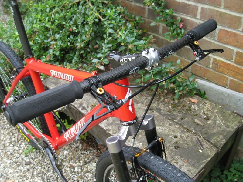

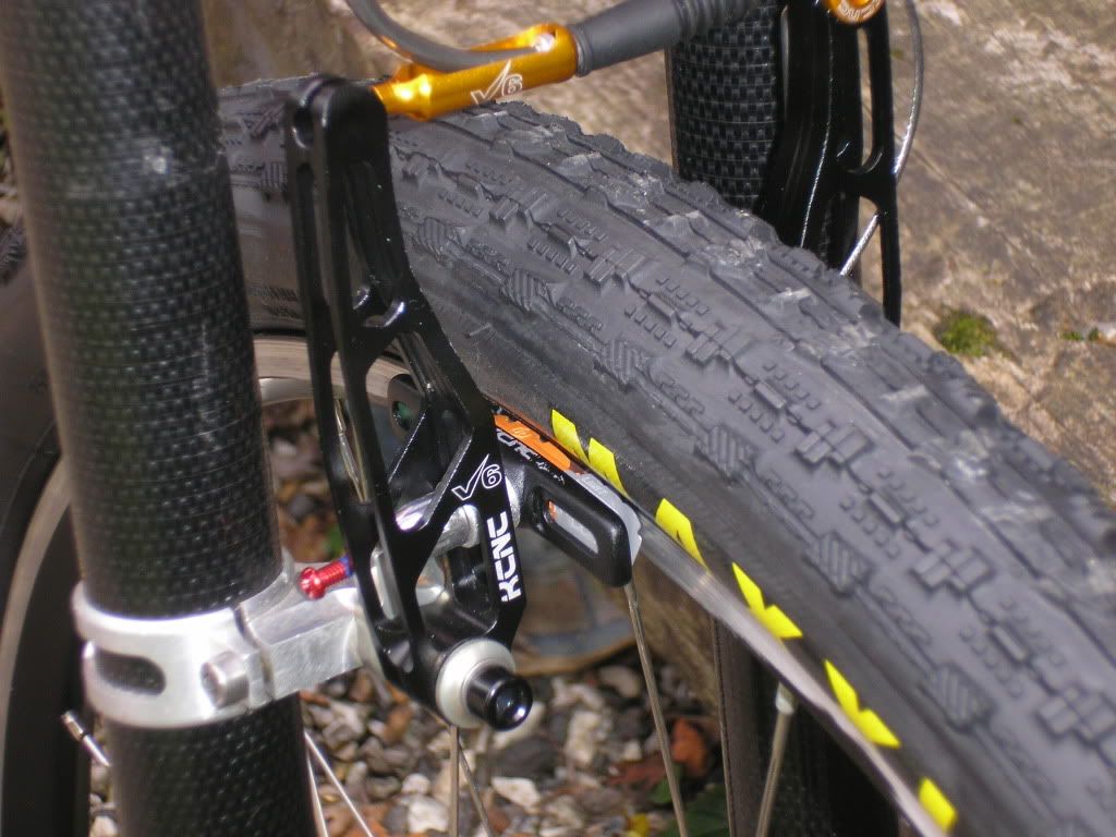

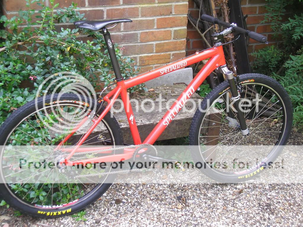

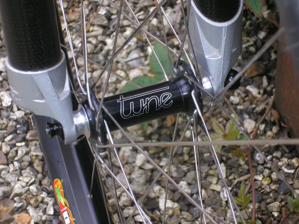

Well folks its finally finished, hope you like it, thanks to wadsy for his help in sourcing and spannering once again :wink:
Frame 17" STUMPJUMPER M2 decals by Gil 1670g
Fork Pace rc31 780g
Headset Chris King 93g
Headrace Chris King steel 13g
Headset top cap bolt titanium 5g
Stem kcnc 110mm ti bolts 101g
Bars USE atom 140g
Seat post USE sumo 30.9mm x 400mm 228g
Seat clamp kcnc 11g
Saddle selle italia slr 144g
Brake levers kcnc v6 66g
Brakes kcnc v6 front and rear 123g/ 123g
Bottom braket Un91 113mm axle 238g
Front wheel tune hub stans ztr355 rims 595g
Rear wheel Tune hub stans ztr355 rims 720g
Grips kcnc 18g
Tires maxi flyweight 330 328g / 328g
Tubes maxi flyweight 96g / 96g
Pedals cooks bros 4 ti 167g
Spacers and lock ring no brand 37g
Rear cog niner 17 tooth 19g
Chain tensioner 4jeri 110g
Crank and ring middleburn rs7 uno 34 tooth 516g
Crank bolt middleburn steel extractor 32g
Skewers kcnc ti 43g
Chain kmx x9sl 218g
Cables jagwire 120g
TOTAL 7178G 15.82lb
i will probably end up going for a 1x9 set up on this bike as i already have my klein as a single speeder, i figure it should weigh about 16.6lb :roll:
