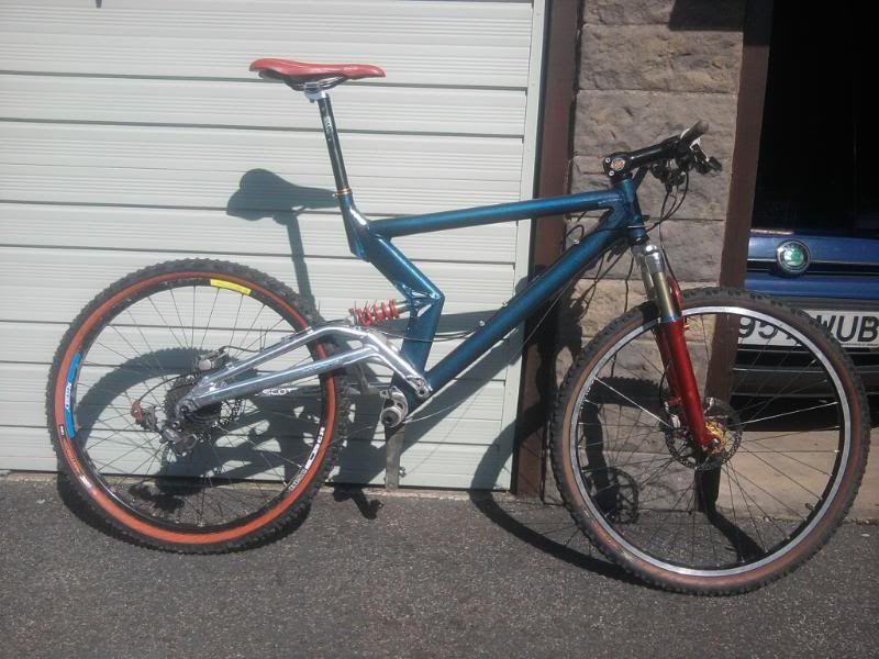

scott g-zero team not sure of the year build will be
forks manitou mars
brakes avid 5s
wheels xt hubs laced to mavic 217s
gears for now stx 8 sp shifters deore rear mech lx front
stem titec 120mm bike hut baRS
basiclly a mish mash of parts but if i like it i will stick some nice bits on it

I had one of these, i would look into changing the shock on it to an air one and i found them very boingy

Iirc, the i2i is an odd size, a 155mm?

defo 155mm the question is what would happen if i went up tp a 165mm shock or should i shim a 165mm shock down to 155mm?

Well i'm sure i've seen these with rockshox sid shocks on them and i'm pretty sure they were 165

surely if set up right - sag, it shouldnt matter
if not set correct, will be a littl ehigher to get on - 10mm :lol:
go for it

as most of you know the g-zero and fx are prone for cracking on the shock mount so i,ve beefed the welds up in the corners and gave it a lick of paint (powder) dark metalic blue but left th swingarm. build might be changing a bit
98 deore lx group set
manitou mars elites
easton mag 60 stem + easton bars
hope wheels
rear shock manitou s-type or sid xc

only problem im having is the front mech is fouling on the swingarm
