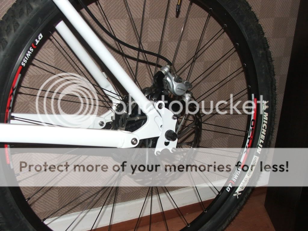

Hi guys nearly finished the build so thought I would share some pics with you.
The forks are loose in the frame as it goes into LBS for facing and H/S fitting on Thursday

Looking good, but how much travel is in that rear shock?
Its not massive 5" but it will be getting changed asap :lol:

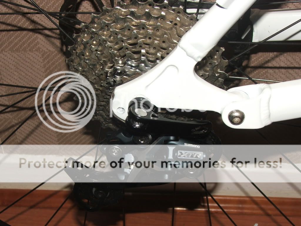

Spec of the bike is
1999 FSR Ground control frame with subtle/slight mods
Truvativ Ruktion double chainset
Howitzer BB
DT Swis 430 wheelset QR rear 25mm front axle
Specialized E150sl forks 120-150mm
LX dual control shifters/brake levers
XTR front mech
XTR shadow rear mech
XTR inner and outer cables
Fox float rear shock
BETD linkage and Goldtec reducers and bushes
A2Z rear disk adapter
Avid juicy fives front 203mm rear 185mm
Specialized Enduro bars/Clarkes vice grips
Specialized seatpost
Prologo Nago Ti carbon gel saddle
Michelin rubber
H/S and chain and pedals still need to be bought, headset going in thursday FSA
This is how it was when I bought it
All the parts have been bought and not transplanted from other bikes.... I just need to get the decals
