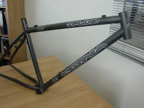

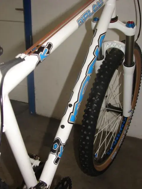

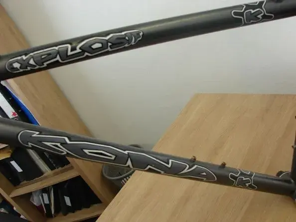

UPDATE.......

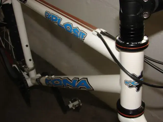

FRAME.
I decided to powdercoat the frame, as its a little more hardwearing, and very lowcost. The decals are exact reproductions of the originals, although in custom colours, and they have been laminated, to reduce wear, as i wont be lacquering the frame. (didnt see the point, if i come off the bike, and damage the paint etc, for £30 it can be done again.)

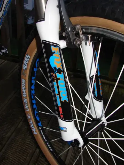

FORK.
The fork that came with the bike, was in very good condition, although as dull and dreary as the frame, and dated looking in filing cabinet grey.
The forks have been stripped completely, and refinished in the same colour as the frame, including the crown.
Custom decals made, and identical to the original factory decals,(laminated). (although custom colours used to match the frame decals.)
The entire fork recieved a full upgrade service, new seals oil etc, to the same internal spec as the current replacement model fork)
The forks were not sand blasted, before being painted, as any residue left in the fork upon re-assembly, could damage the new replacement seals etc. They have been rubbed down by hand, and then refinished.

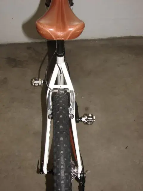

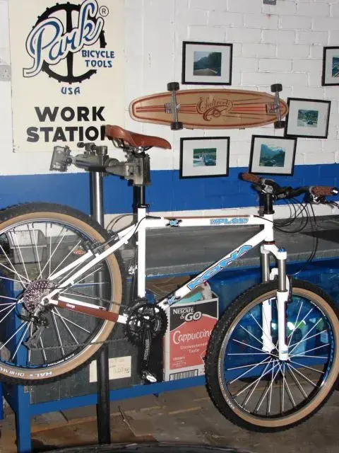

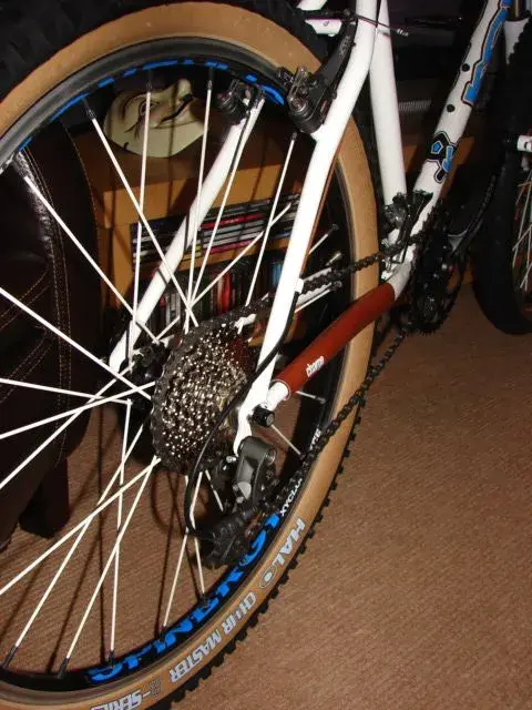

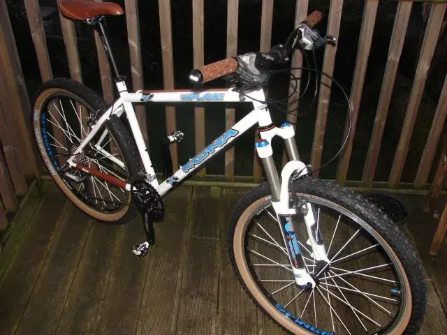

SPEC.
The spec of the bike when i bought it was really very good, however a lot of cleaning and some painting has been required.
Items that were needed for replacement, were wheels, grips, saddle, seat collar, tyres, seatpost, pedals, cables.
FULL BUILD SPEC:-
Kona Explosif frame.....refinished in storm trooper white.
( custom decals---Galaxy brown and Obession blue. )
Made with True Temper OX Platinum...( true tempers answer to reynolds 853, in terms of strength to weight ratio....and....Air.hardened) Approx weight/this size 3lbs 15oz
Fox Talas RLC suspension fork.....refinished in storm trooper white.
(matching custom decals.)
Adjustable travel from 80 to 125mm. with lockout. Approx weight 3.9lbs.
Wheelset.....Spinergy XYCLONE race---- a low maintenance wheelset, light and incredibly strong, with thicker gauge PBO spokes...finished in white. (specs...front weel radial built, 24 spoke. Rear wheel 2 cross 24 spoke, Hubs custom cnc machined, with aerospace grade aluminium axles. weight 1520g)
Tyres-----Halo Choirmaster R- series 2.35 Amberwall,
Brakes----Shimano XTR---v brakes.
R/mech----Shimano XTR
F/mech----Shimano XT
Shifters---Shimano XT
Chainset----Raceface---Prodigy XC
Stem----Raceface----Prodigy
Bars----Raceface---Evolve XC lowrise.
Seat post-----Raceface---Evolve d/h.
Seat-----WTB/Kona----galaxy brown leather.
Grips----Odi----lockon.
Headset-----WTB momentum---cartridge.
Seat collar---Salsa....non Q/R
Pedals.....Shimano "budget" clipless.....White.
Finishing touches.....Colour matched.....Charge Chipper, chainstay protector.-------Cable sleeves----colour matched, in coffee.
