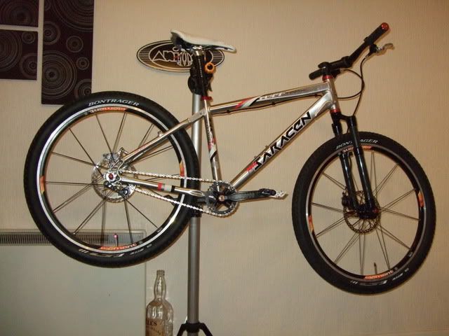

here's my trusty Saracen Tufftrax from '06 (as far as i know)
i bought it as a new bare frame and it has been built in various disguises over the last few years
here it is in its latest incarnation
the single speed rigid
Exotic Rigid Carbon Fibre forks
Element DS3 wheelset
Raceface Prodigy Chainset, 32t, with Middleburn Ti Self-extracting bolts
14t rear sprocket with gusset double six adapter and On-One Doofer
bontrager select seatpost, stem and bars
yeti lock on grips
selle italia XO saddle
Bontrager LT3 tyres
outland flat pedals
Hope Mono M4 rear 180mm
Hope Mono Mini front 180mm
Hope Skewers,Seatclamp and headset

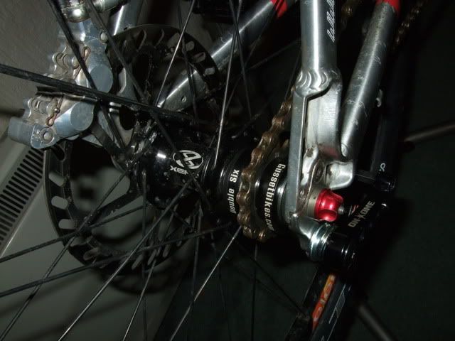

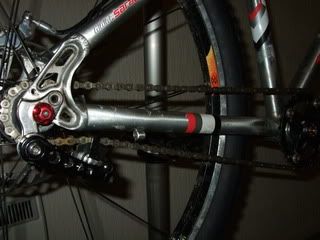

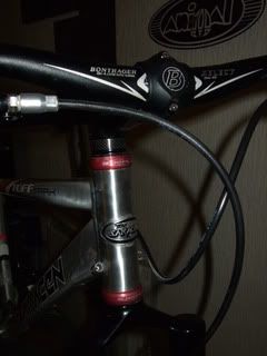

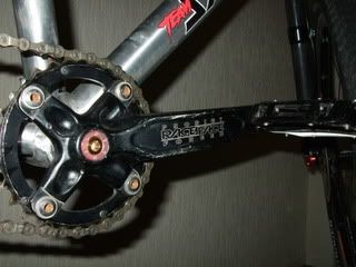

ok, i now have the On-One Doofer and the 16t sprocket...
upon removing my 18t i realised it was already a 16t :oops:
i needed a 14t... rejoice! i already had one (anybody need a couple of 16t sprockets? lol)
anyway, all fitted now
with the 14t i managed to avoid needing a half link
it is rideable without the chain tensioner as there is only a tiny amount of slack but i feel happier knowing it is there

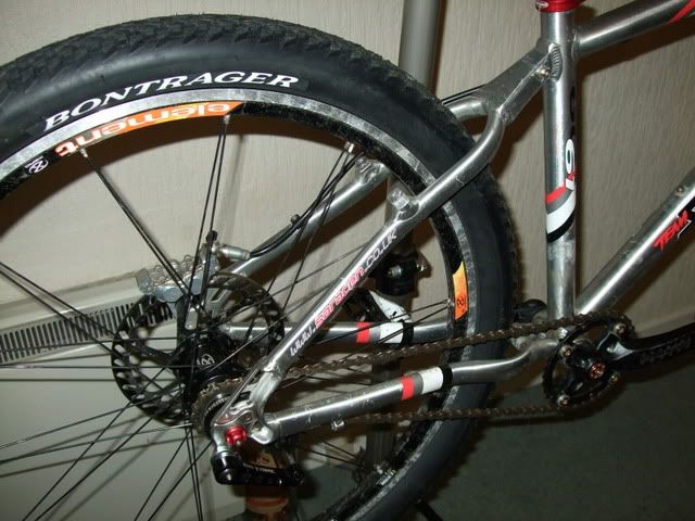

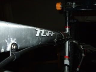

heres a few update piccies

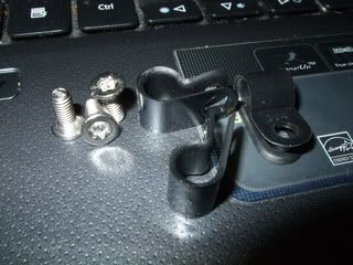

i have used nylon p clips with stainless torx headed bolts to guide the rear hose, the frame had M4 bosses already in it for these

Out of interest where do you get these from:
As I need some for my saracen zen (06/07) and cant find any? my lbs has run out!

ebay came up trumps for me
i think i bought a pack of 10 or each
how many do you need?

these are what i used

Spot on. Just what I need!
