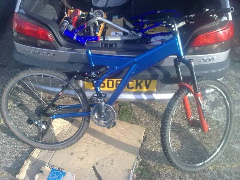

this isn't an original restoration, partly because im so poor, but also i have come across a lot of free components due to a friends bike being involved in a minor accident :) lets call it fate.
right, so this arrived the other week:
http://www.retrobike.co.uk/forum/viewtopic.php?t=113938&postdays=0&postorder=asc&start=0

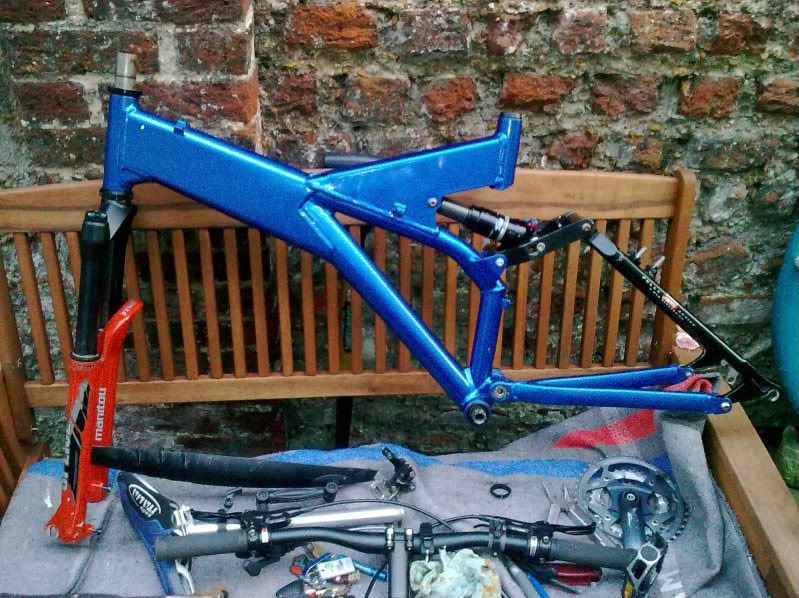

yesterday i spent a couple of hours putting the on the bare essentials:
transferred over from my (bent)Fuji frame:
forks: Manitou Splice comp (130mm)
Fox Triad - from a specialized apparently - Came with my Fuji
Bottom Bracket - Shimano 118mm
cranks - Shimano hollow tech - may not be keeping these as i've yet to get more stuff from my mates write off :)
headset - Token 1 1/8" threadless
next on are the handle bars, shifters, brakes i'm thinking disc up front, magura out back.

i didn't bend it myself, it was something i noticed about a month after i bought it (second hand) :( the seat stays are off centre - bent off to the left by about 3-4mm.
Odd thing is that the chain stays are fine. but it means the shock isn't aligned properly. not sure what damage this could do, i've just had the Fox shock serviced as is it was knackered so didnt want to take the chance and use it on that frame again.
i also found out it was missing a grey link (which i managed to track down and buy off some ex display in Germany)
the frames pretty heavy too, but seems quite solid. its a shame really.might put the old shock from the FSR frame on it to see what happens and build that bike back again with the missing linkage. i've think i've got enough spares to make another bike back up now! or i may just sell it all off in bits.
not really sure.

UPDATE - yesterday lunch time:
+ wheel rims: Front off a Carrera (WPP?) heavy - came off the Fuji. Not sure of the Rear one, but has Shimano Deore Hub.
+ Tyres (Tioga) need to swap tyre on rear
+ Rear mech (deore LX) - swapping rear cassette to match existing chain set.
+ wide handle bars (Ritchey + Ritchey Stem) with Deore LX shifters (damaged shells but still working - is there anywhere/anyone who has a duff set for spares???)
need a front derailleur (35.0mm)

turns out i need a top pull front mech :( should have looked closer at the frame instead of relying on Bikepedia! tsk tsk
my fox shock is having teething trouble since being Mojo'd, so have sent this back and replaced with original shock from frame for now.
just got to hook up the chain set and gears and i may be able to give it a whirl round the car park!
i do need some proper bushes to help secure the shock in place though.....
