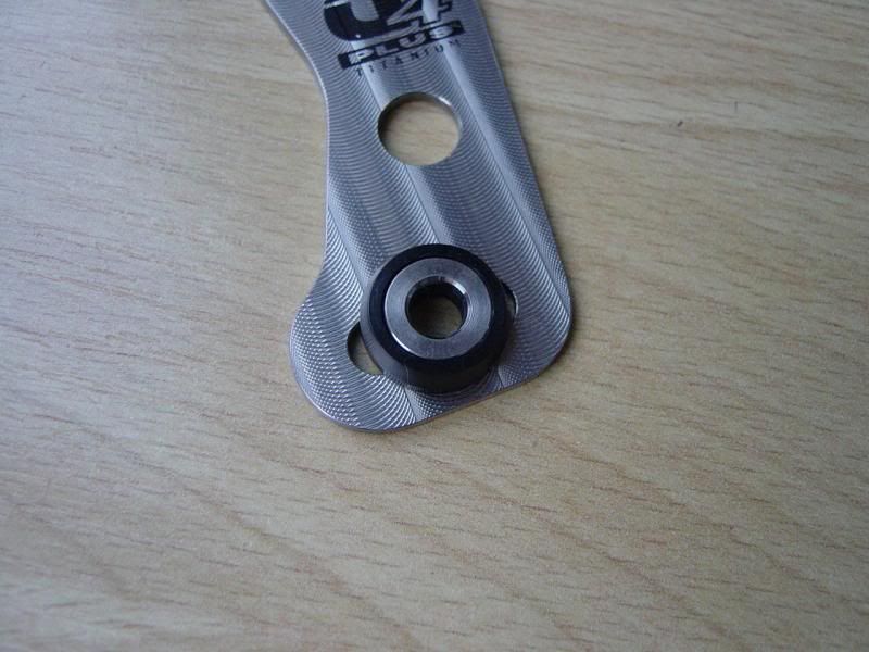

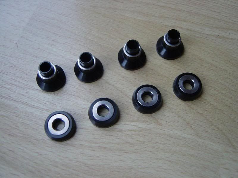

As you probably know I lost access to a lathe some time ago :-( but I still feel the need to design and manufacture simple custom parts that do the job better and look better than the OE versions – satisfying my OCD at the same time … :oops: :lol:
Although I don’t use it much any more, I still have my design software and Rampage / Intrincycle comes to my rescue turning my paper designs into reality for the things I cant do any more i.e. lathe, milling work and anodising (I have always had to out source anodising) … 8)
Can you guess what they are yet ? :

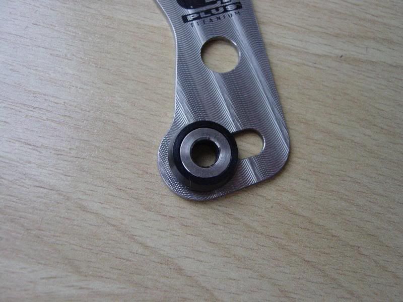

The counter bores are for Ti washers and the small diameter goes inside the XTR brake arm bore, the stainless thin walled washers are OE from the XTR arms :
They provide the largest clamping area possible :
Whilst maintaining a nice matching radius at the extremities of their adjustment :

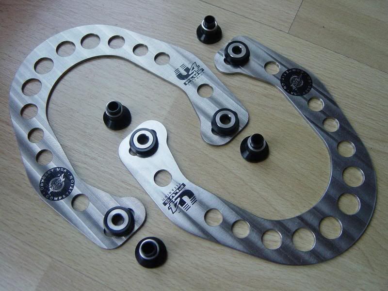

The back piece was designed to match the front :

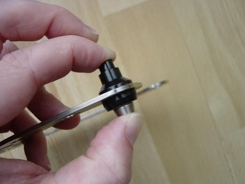

Whilst providing clearance for the parallel push linkage and the small bore fits inside the arm to provide support / location :
I managed to find a twin to the first brace I sourced :
I reckon they are a much neater / better solution compared to the standard hardware :
Compare the difference in the clamped area and the potential damage that the smaller clamp could cause to a softer ally or carbon booster.
I am really happy with the result 8)
WD :D
