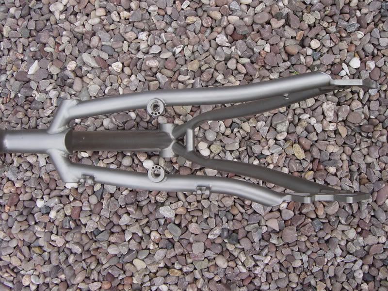

Once a deal was struck I soon received the package and upon opening I was quite surprised by some of the frames features that aren’t easily picked out with the camera, even when you know where to look :-(
Anyhow, this is how it arrived :

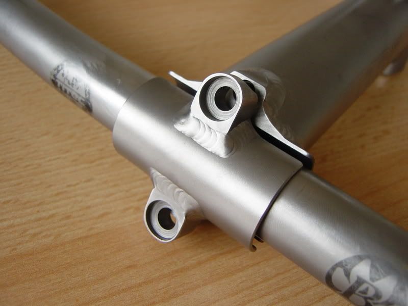

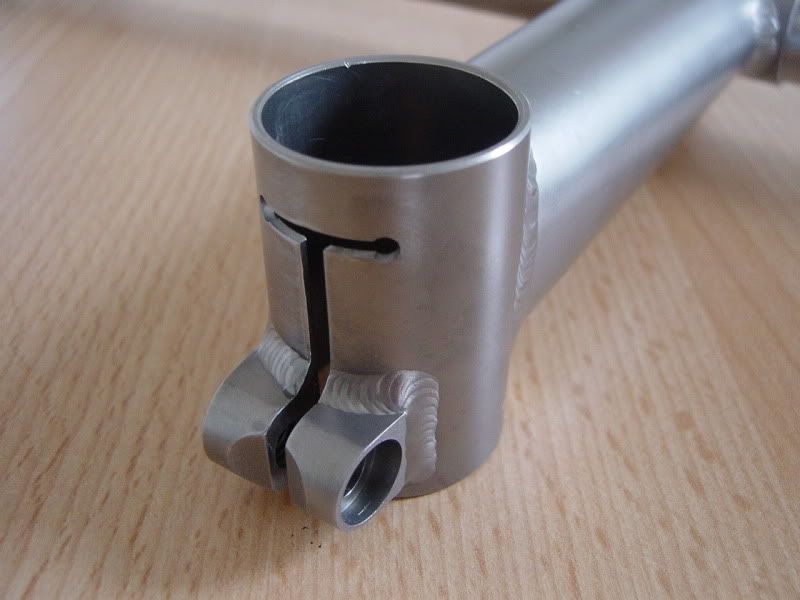

Dropout’s / v boss’s / pipe clip’s / chain catcher etc that might help date it (as I am still unsure of its age) :
This probably shows the welds and profile of the top tube best - it almost feels triangular (and potentially painful :lol:) :
This is the forming on the rear stays :

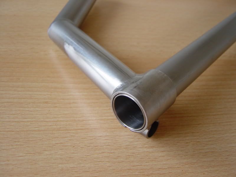

The down tube is ovalised at the head tube, round in the middle and then very ovalised at the bb shell (across the width). You can 'just' see this on the side view of the frame pictured above.
The vernier says :
Top tube (constant triangle) : 28.9 x 36.0
Down tube (front) : 43.5 x 37.8
Down tube (middle) : 40.2 x 40.2
Down tube (back) : 45.5 x 35
Seat stays (constant round) : 22.2
Chain stays (constant round other than tyre clearance) : 22.2
The angle gauge says a one degree difference between head and seat angle. EDIT : I will check confirm this with something more accurate than the iPhone (I have a digi camber gauge I will use :D)
The serial number is SER02608
Is it ‘retro’ ? I am not quite sure … :? But it will be having V’s and a nice selection of retro goodies thrown in for good measure ;-)

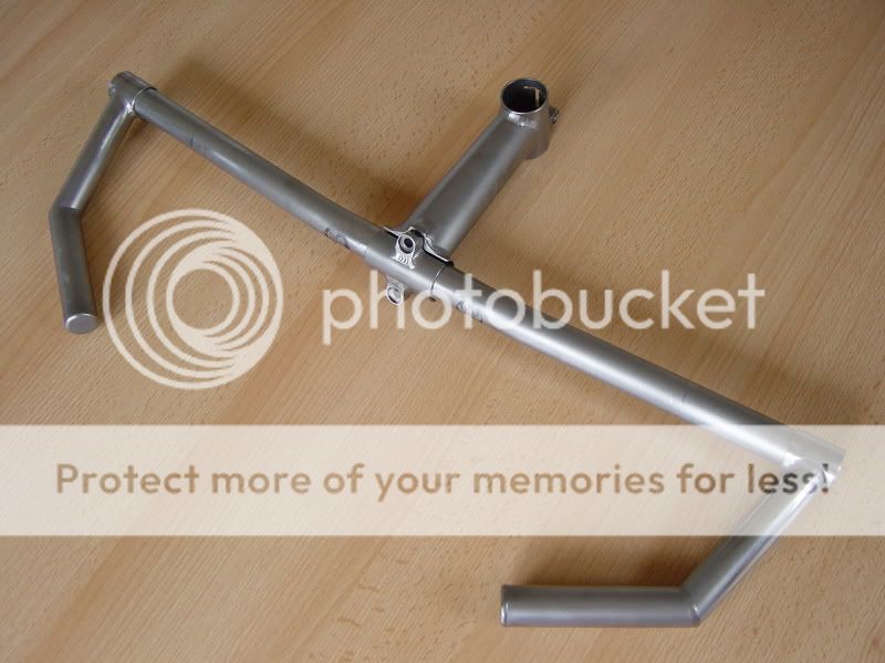

Well here is the Ti stuff that started the bug (you can see I have already dressed this up ready for blasting). Titec bars and stem with Titus bar ends :

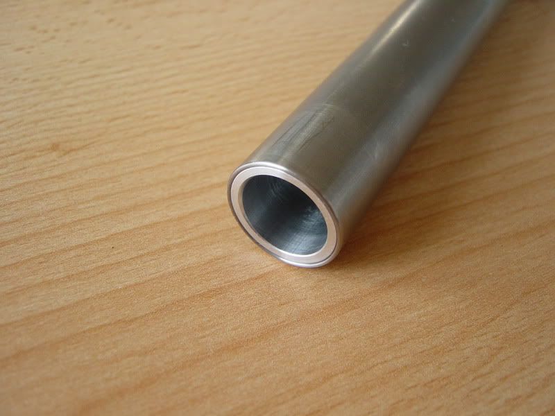

As some of you may have seen on another thread and on the BV rebuild, I was worried about crimping the Ti bars. After a few enquires, 2 sets of BERTS turned up courtesy of ekiborter 8) 8)
As it turns out the BERTS are for the Titec / Bontrager 118g butted bars where I have the 150g plain gauge bars – therefore the diameter was a little bit big and they needed turning down to suit.
I found (what I thought at first to be useful) information on the bikepro site about the diameters wall thickness etc but the sums / measurements / components didn’t match up :? :-(
Taking an average ID of the bars and a average wall thickness based on 22.2mm OD my bars measured came out with a ID of 20.35mm
I turned the BERTS down to 20.32mm which allowed me to push them about half way in by hand before they got really tight. This seemed like it was going to work well so I covered them in Loctite and whacked them in :lol:
Standard BERTS and one modified BERT at the point where they got ‘tight’ :
I know 271 isn’t really supposed to be a ‘retainer’ but A) it’s the best I had at home and B) I don’t think they will move, even without any Loctite on at all :lol:

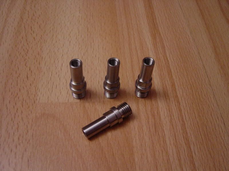

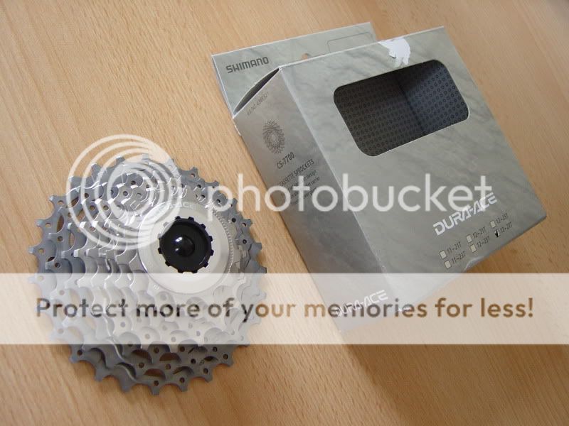

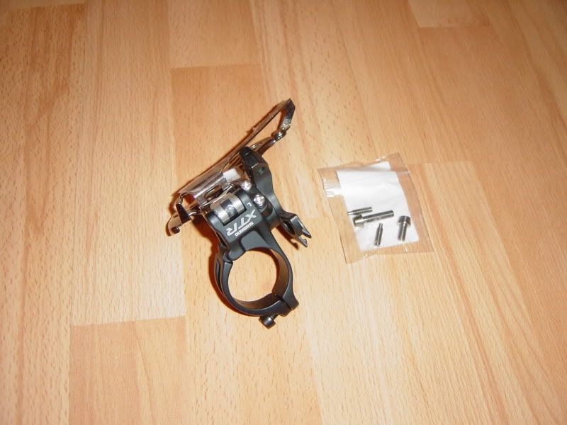

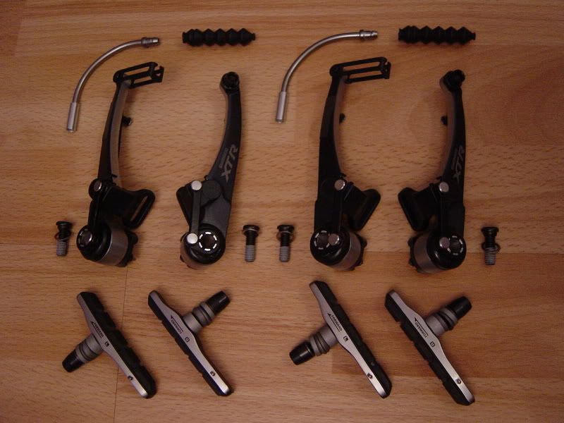

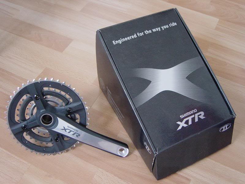

Loads of pics of the bits I have collected to date :
Rear with Ti bolt kit :
Front with Ti bolt kit :
Ti stuff for the above (more to come ;-)) :
Also got some M8’s versions of these for the forks :

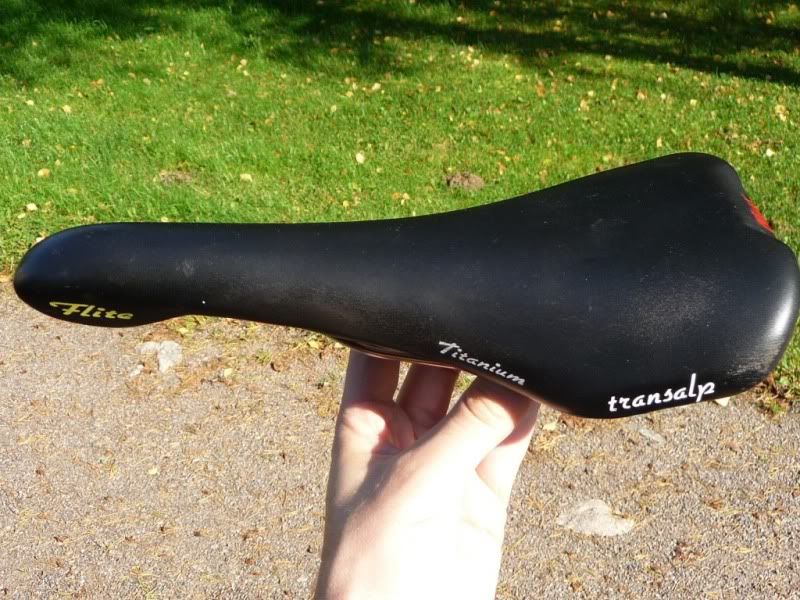

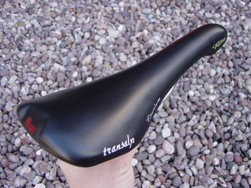

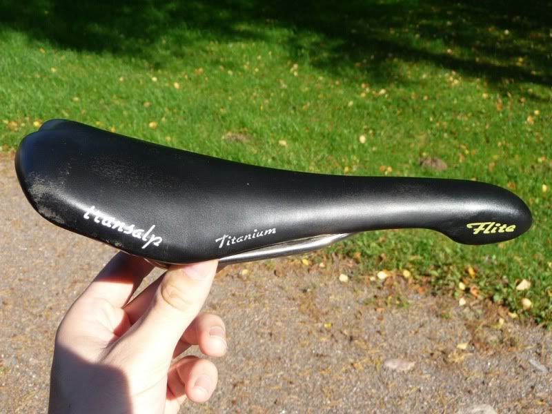

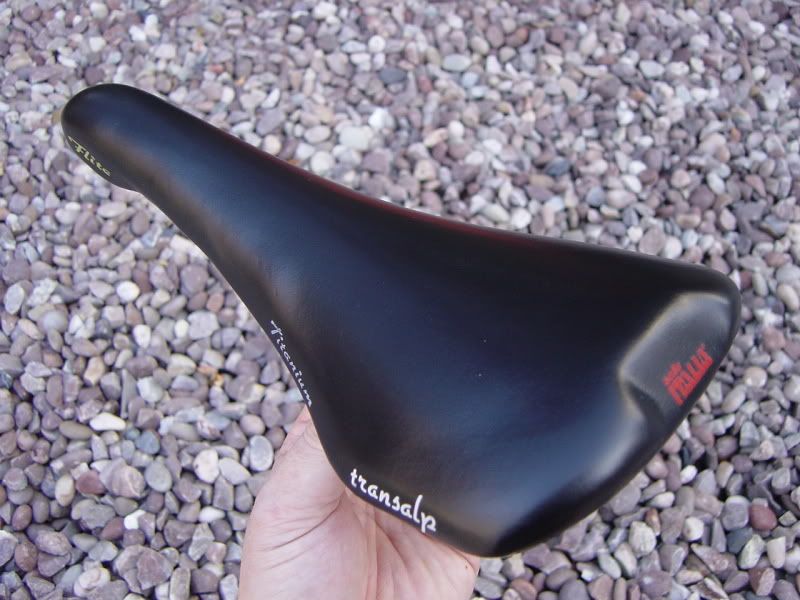

This is the seat I will be using, the quote (and seat :lol:) has been pinched off the ProFlex build :
WD Pro wrote:
I also picked up a great condition Flite Transalp (thanks Archangel  8) ) :
But everything can be improved a little …  :wink:  Spent a bit of time with the ‘wet n dry’ and good old kiwi :
WD :-)
I also have the forks, XTR chain, Ti seat clamp, grips and frame protection. Ti headset spacers and a USE Ti post should be on their way to me now – more pictures soon i.e. when I have taken them :lol:

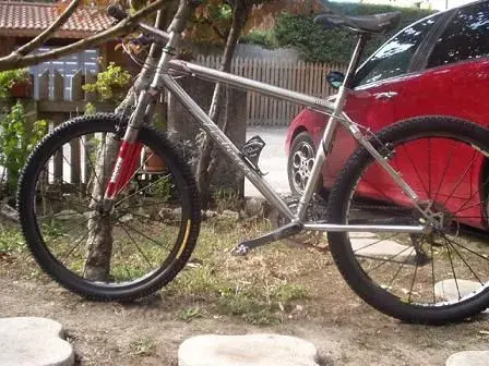

Def a king. I bought two and never fit them. I'd also plump for the Crossmax, they are superlight and look very cool. I'd expect you to get closer to 20lbs. You'll be surprised how light it feels and how it handles! Nice work on the Flite 8)
Edit... Pic with Crossmax!

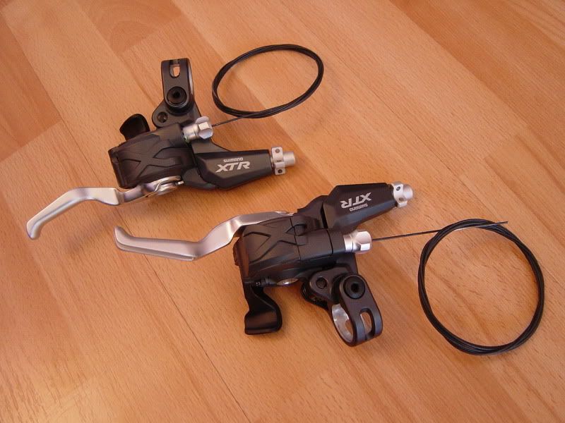

Thanks 8) the shifters are a new thing for me but at just less than £70 (brand new), they were (I suspect) a 'wrongly' priced bargain I just couldn't resist :lol:

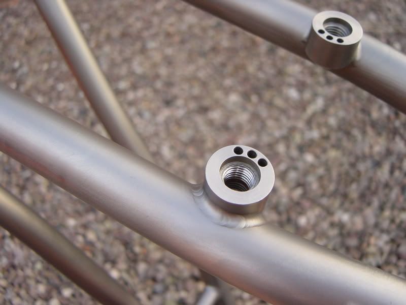

The frame is dressed up now and ready for blasting - the decals are gone :-( but so are all the sharp edges on the pipe clips and cnc’d dropouts etc 8)

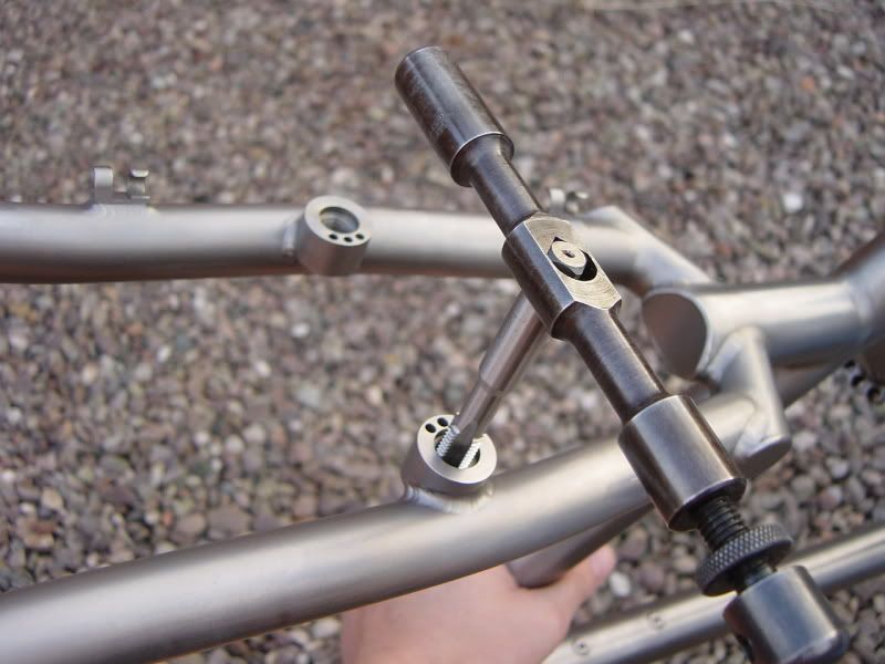

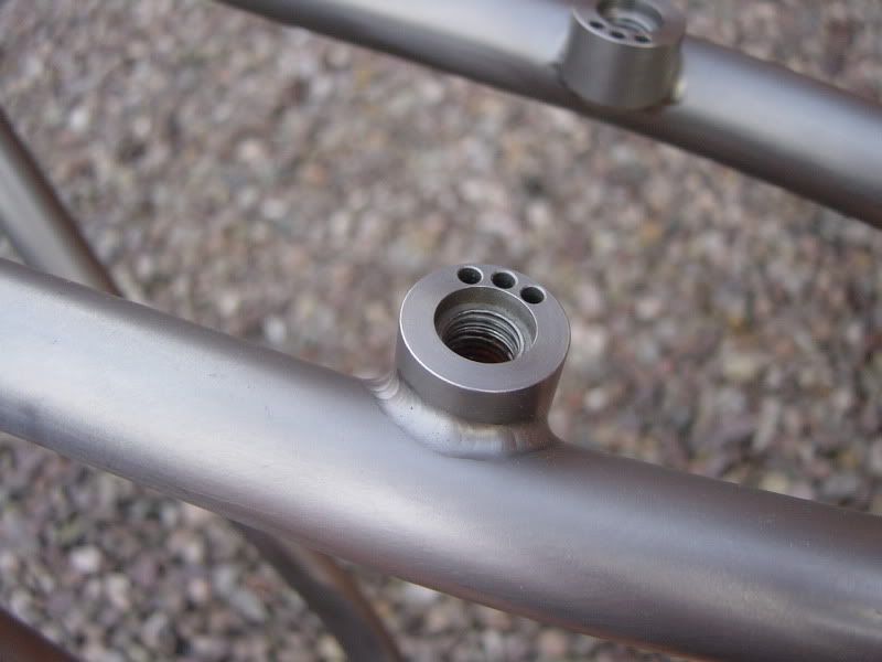

I found that one of the rear frame bosses had at some point in the past, had a standard (rather than fine) pitch canti boss partially screwed in :? :
An eBay tap of the correct pitch came to the rescue :
It didn’t actually cut anything out, just a bit of resistance so I can only presume it just re-formed the de-formed threads ? Anyhow, the result was really good :

I think I need to try and find more Ti bits for my King kahuna ;) Anyone got a stem, seatpost etc etc :roll: :lol:
ps, where did you get the ti kit for the xtr V's?
