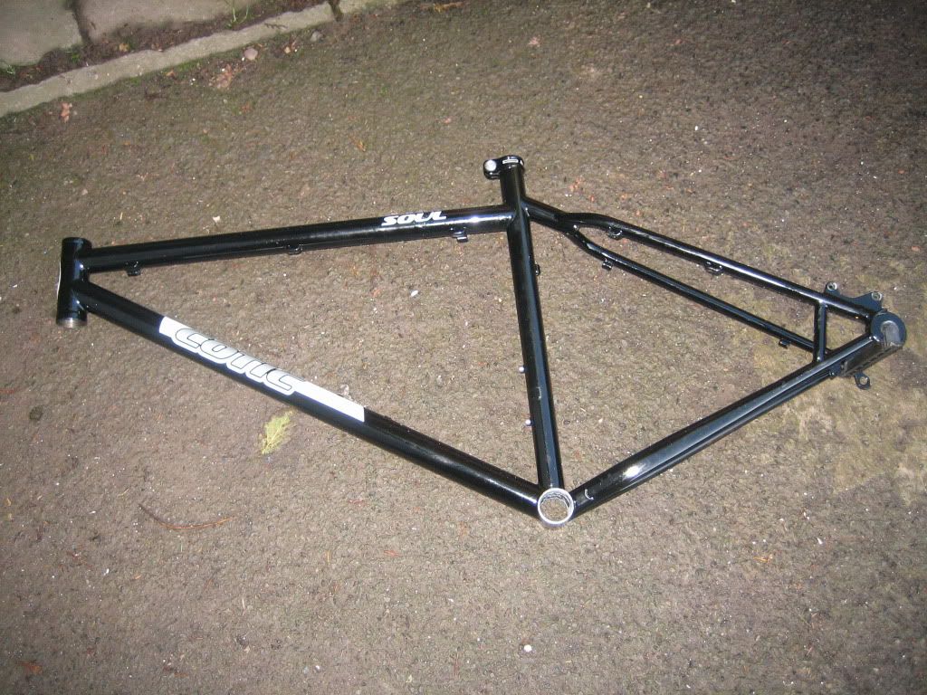

hey, thought i might share with you guys the build i am doing over the next week or so. i currently have a charge duster, and though there is nothing wrong with it i have fallen across a cotic soul frame on the cheap.
this is what i have been riding all year....
and this is what i have aquired....

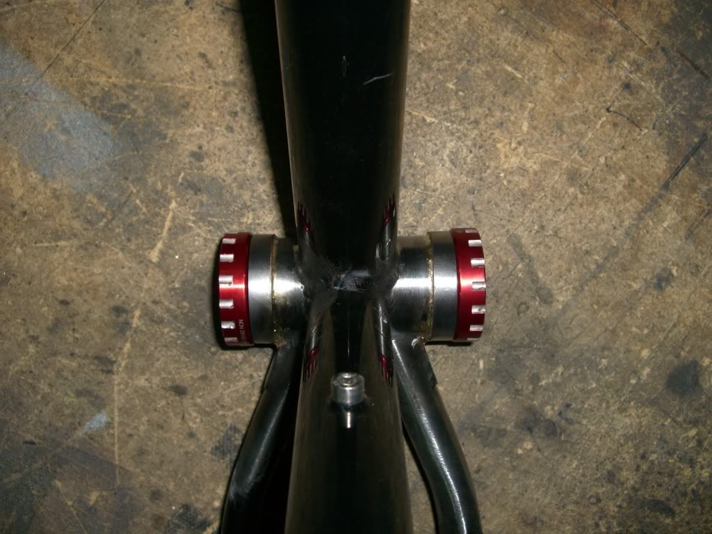

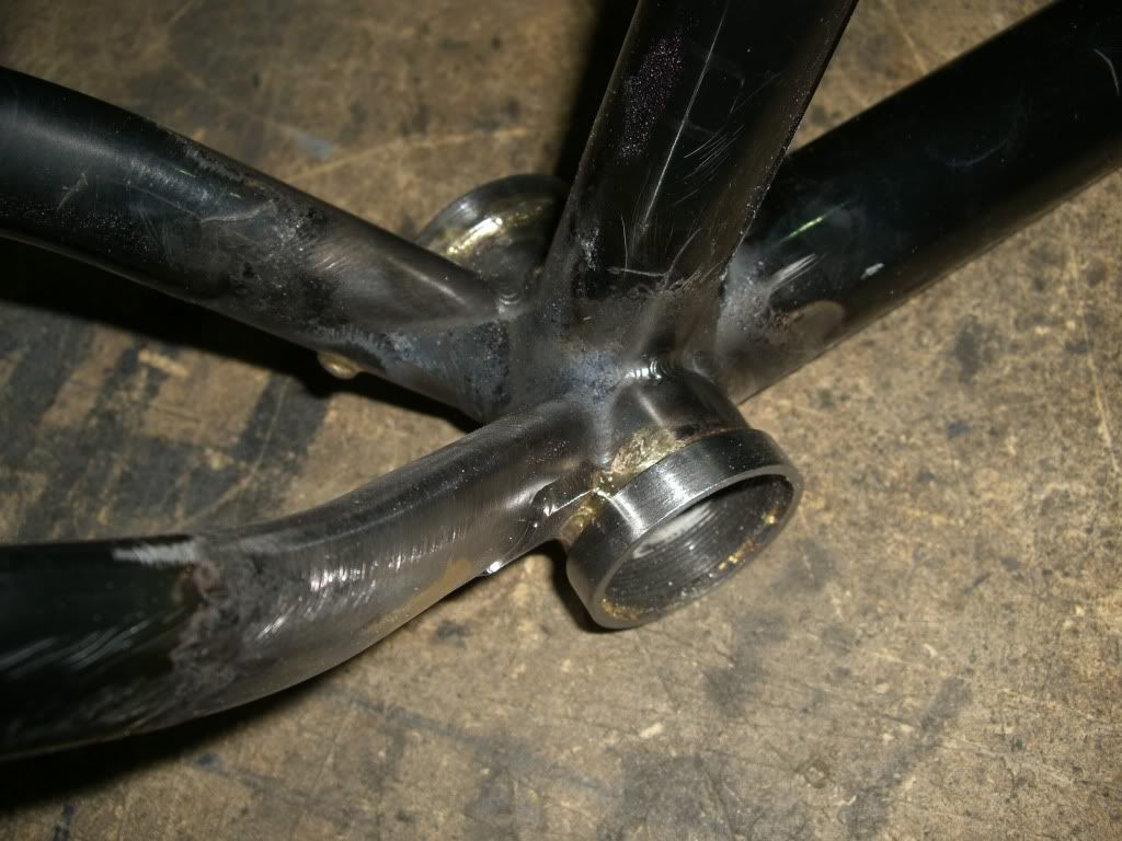

so the mods start. i have always wanted to run a bike with a 75.5mm bottom bracket. this means you dont have any nylon spacers between the frame and the bb shell, and if its faced well the bottom bracket should last for ages. also makes the frame look more integrated. made up some rings on the lathe, i always liked the look of ring reinforced bbs, ever since i had one on my gt pro series bmx....
the non drive ring is flush with the bb shell, but the drive side ring is stepped so that it sits 2.5mm wider.
so you can see here that the cups just fit straight onto the frame, no spacers.

cheers guys. bb90 is a good idea in principle, but mainly for manufacturers. i have access to most tools, helps having access to the lbs workshop and being a fabricator/welder during the day. but this was a relatively quick fix, and was possible due to the tools i have access to, and the hope bb and raceface cranks i already have. and i quite like the way the bb threads in. i always wanted to try a x-type bb as a head-set and as a pivot point(a-la gt) in a dh bike......
