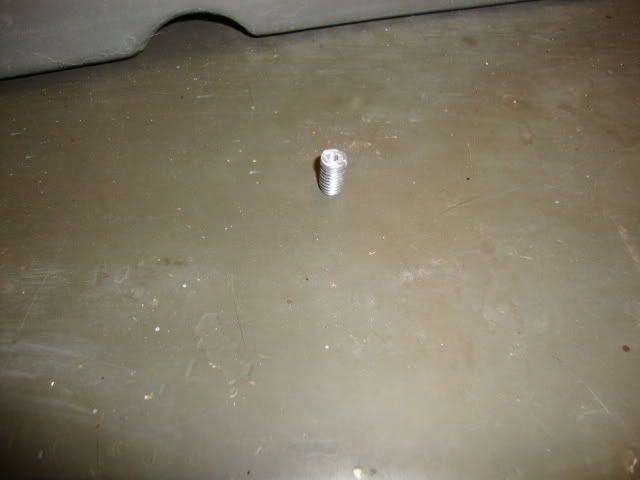

Older forks and frames do not have mounts for disc brake hoses and although there may be gubbins thatr can be bought, I was using strips cut from plastic bottles held to the brake boss via a bolt. It worked but well, looked like strips cut from plastic bottles held to the brake boss via a bolt.
So having some 3/16 hose clips, as used for car brake pipes, thought I'd make something nicer looking and lighter.
Forks tend to have M8 thread for the brake bosses that are removed. I put on a short length of M8 thread onto an 8mm aluminium rod from B&Q and cut it a couple mm above the thread - the unthreaded part to stop the plug from screwing all the way in. I drilled and tapped M4 and finally a saw cut to act as a screwdriver slot (I hack saw bladed is used to screw the plug in).

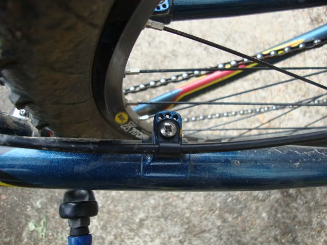

first photo shows the plug - the M4 hole is offcentre since I do not have a lathe and next photo shows it fitted.

I have strip of plastic and made a T-shaped plug, drilled to take a self tapper. Photo shows home made cutters. Some fetting with a file was needed. For the second of these plugs, I used a hacksaw to put some thread - very crude but worked well enough to allow t he plug to be screwed in. Left hand shows previous mount - cut down brake boss, plastic bottle strip and bolt - right hand shows the plug, clip and tools to make it.
Last photo shows the plug fitted.

02gf74 wrote:
Forks tend to have M5 thread for the brake bosses that are removed.
I've never seen brake bosses with a fixing as small as M5 - some Marzocchis use M6
02gf74 wrote:
I put on a short length of M5 thread onto an 8mm aluminium rod from B&Q and cut it a couple mm above the thread - the unthreaded part to stop the plug from screwing all the way in.
I guess that you meant that you threaded an 8mm bar M8, not M5?
02gf74 wrote:
The rear brake bosses are tapped to some fine possible non metric thread, larger than M8 so I could not make a plug from aluminium.
M10 x 1mm - same as rear mech. hanger thread and Shimano wheel spindles etc.
Looks tidy enough once its all done though..... 8)

^^^ well spotted - it is M8 in forks - putting M5 onto 8 mm rod is gonna take some doing - corrected the post.
re: rear, at leas on Gary Fisher frame - it could be M10 but is not the standard M10 thread - looks too fine - I didn't try to fit an M10 bolt to check since it looked too fine plus I do not have any 10 mm bar to make the same type of plug.
PostPosted: Mon Sep 06, 2010 10:18 am
Joined: Tue Aug 07, 2007 12:22 pm
Posts: 2947
Location: Platsa, Messinias, Greece
"Standard" M10 thread is 10 x 1.25mm pitch.
