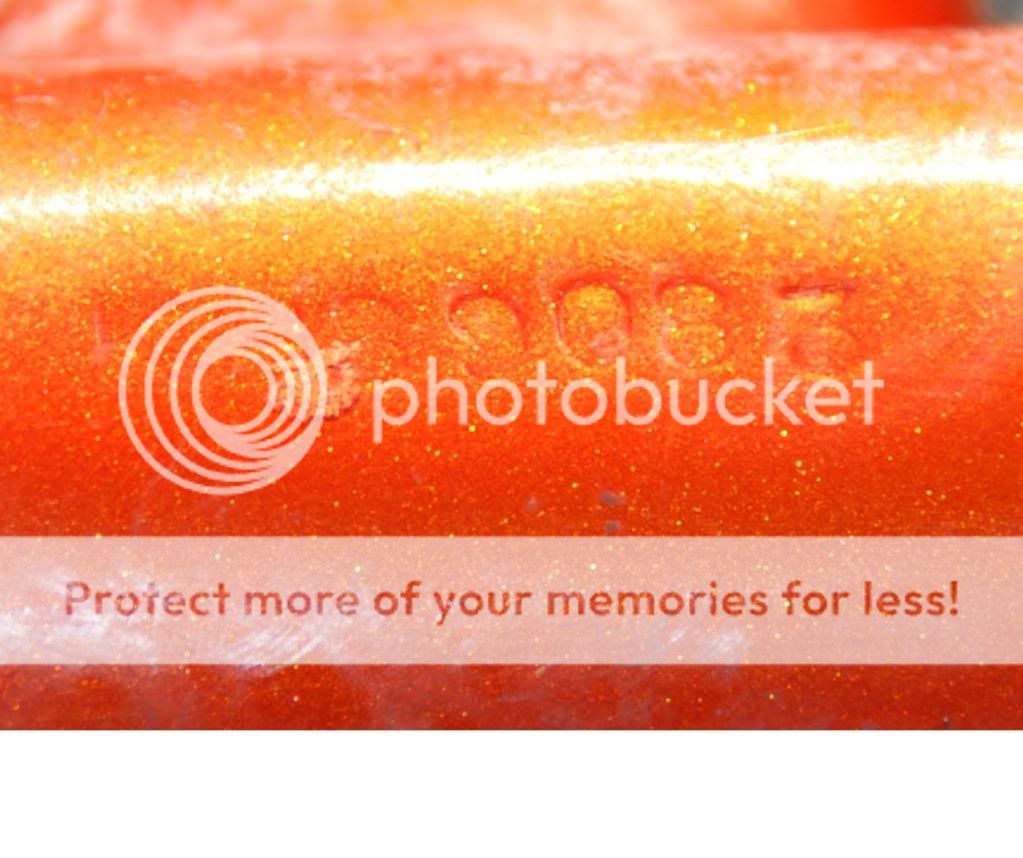

Thanks guys! I apologize for the misleading/poorly worded thread title. At first, when I started this thread, I wasn’t 100% sure that the bike was a bona-fide Hot; I had very, very strong suspicions that it was one of the last Hots, but I wasn’t 100% certain. At this price £123, or 200 beans in my neck of the woods, I would have been extremely pleased with an Explosif. The fact that it is indeed a Hot is a bonus…
Reynolds 853 Opposite Oval
Reynolds 853: full oval/opposed oval/taper oval
After chatting via e-mail with Kona I’m positive now that this is the real deal. In my first e-mail to Kona I simply sent them the frame # and nothing else. I was hoping they had a database that would allow them to retrieve things like: size, color, model, dealer, build date, manufacturer etc. No luck though, in fact they thought the number I gave them was missing at least one digit. I replied by sending them additional info: badged as a “Hot”, 18.6” from center of BB to top of seat tube, 13cm head tube, Reynolds 853, ovalized down tube, Kona dropouts. Then I asked them if it was one of the last Hots welded-up by Altitude or Enigma. Kona replied by asking for a picture, the guy mentioned that he was running with the custom bikes back then and said he could nail down the age from some of the small details like dropouts, cable placement and decals. So, I sent them a raft load of pictures and received a very interesting response:
The bike was welded-up in Taiwan by Hodaka, it’s one of the absolute very last Hots ever made. The dropout was exclusive to the factory that also builds the bikes for their XC race team, builds shocks and wheels for a lot of the other component brands. He also said that they were the nicest custom frames too; mentioning that he ran that program for the dealers till it ran down and these frames had a way nicer finish than any of the Enigma, Altitude or any other steel builders they had on tap; pretty well level with what came out of Titanium Sports.
To this, I replied by asking if it is a bona-fide Hot and not a fake. I also asked if it was from a batch of bikes with Reynolds 853 + directionally ovalized Columbus MAX down tubes. The answer:
It’s a full Reynolds frame, they also had a Bi-Oval air hardening down tube. It was too expensive for most production bikes but it made it into the custom lineup. The bike is for sure a real Hot, if it was an Explosif it wouldn’t have that down tube.
_________________________________
To those wondering about the serial number: KH89083
My wild assed guess, stab-in-the-dark at deciphering it would be: Kona Hot 1998 19” number 083 in the batch. Perhaps someone else with another 1998 Hot could confirm?!
Again, the thread title was poorly worded and for 200 beans, I would have been very happy with an Explosif…
For me, 18” would have been better, 17” would have been ideal.

That's a very interesting addition to our fund of knowledge. One of the partners in Enigma came on here at one point and gave us a few details of their involvement, beginning in December 1996. They were contracted to build two batches of frames, not one frame at a time, so it clearly makes sense for the orders that Kona received in 1998 to be fulfilled at Hodaka.
The only truly custom aspect of the deal was the paint in any case, and I would guess that the KH frames were still shipped to Bellingham, Washington State, for Tony @ Velographics to paint them to customer requirements. The standard deal covered one colour - multi-colour like Doug's above, came extra.
Hodaka is a huge Giant factory, and in my experience it has high standards. Enigma is no doubt a fine little company, but it is tiny - it just goes to show how strong is the pull of the 'US-made' tag that Kona would give its custom contract to such a small and newly-formed company in preference to Hodaka in the first place! Add to that that 853 is very difficult to work and you have probably got the best end of the deal there.
My guess about the serial is that K stands for Kona custom, H stands for Hodaka, 8 stands for 1998 and 9083 is the Hodaka control number (standard Hodaka serial numbers have four-digit control codes at the end). My 98 Explosif is H8A2 7042 - i.e., Hodaka, 1998, possibly February, control code 7042.
I am puzzled about the 18.6" seat tube. 13cm is the head tube length for a size 19, and all my Konas have the seat tube length equals the size. Not just thereabouts, exactly. So where did your missing 0.4" of seat tube disappear to? And could it be linked to the mysterious sudden loss of Altitude experienced in Chico in 1996? The plot thickens.
