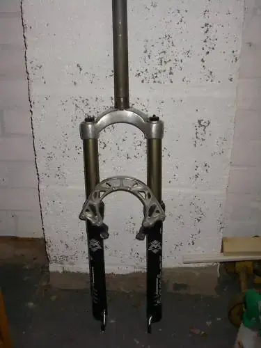

I've just taken delivery of a pair of Marzocchi Bomber Z1 CR forks, year 2000 model. Does anyone have any information about these, mainly where they sat in the Z1 lineup and what the differences between them were? The fork has a bolt on crown, bolt on brace, preload and externally adjustable rebound damping. I'd guess they are 130mm travel, will be checking them shortly!

CRs were the top Z1s, adjustable rebound and compression damping, 4 or 5 inch travel.
Lovely forks, and are becoming collectable especially the orange bams.
(BAM stands for Bomber Aerospace Material, whish is a load of bollocks and basically just means aluminium!)

Thanks Carter, feel as if I've got a bargain now. Guess the 'CR' must be short for compression & rebound. Thought they might have been some OEM fork.
Reading around on the net, they dropped the compression damper the following year and went back to dual rebound. Ebay picture attached.

hi all,just got a pair of z1 cr's,98's(polished with blue bomber decals) i think,anyway has any body got any idea are these bam's or alu's,as oil level is higher om bams,cheers martin :)

If the bottom of the slider is round, as mine are in the pic above, they're BAMs. If the bottom is tapered to the dropout, and they have dual disc mounts, they'll be the ALU model.

thanks Sam,seems mine are bams

Great fork indeed. I have a set on my 1999 Chameleon. The compression rod was known to 'spike' hard on fast compressions; that's why it was dropped in 2001 in favor of 2 rebound cartridges.
Yours appear to be in the 5.5" setting. Alternate is 4". I spent a fair penny on mine earlier in 2014 and never regretted it.
