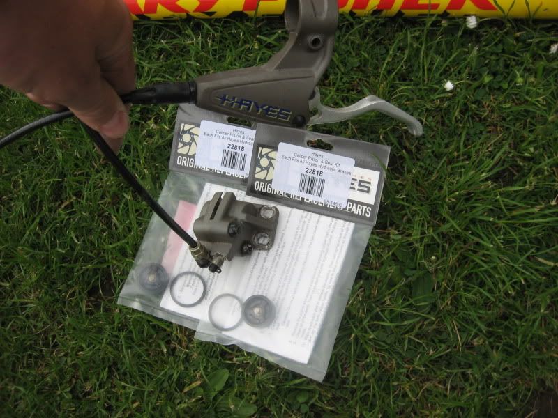

I feel almost silly asking, but are these frames disc brake compatible? if not, what is the place holders for?

yes, it's the early hayes type, i think you can still get an adaptor to convert it to international standard. think it was a2z components that make it.

i have a complete rear hayes 22mm rear brake to fit your frame if your intrested ?
it works perfectly , theres a re-build kit to go with it too but no pads but there is always some on ebay :D
or heres an adaptor a little colser to home > http://cgi.ebay.co.uk/A2Z-AD-PMR-Rear-D ... 45f39781ee :wink:

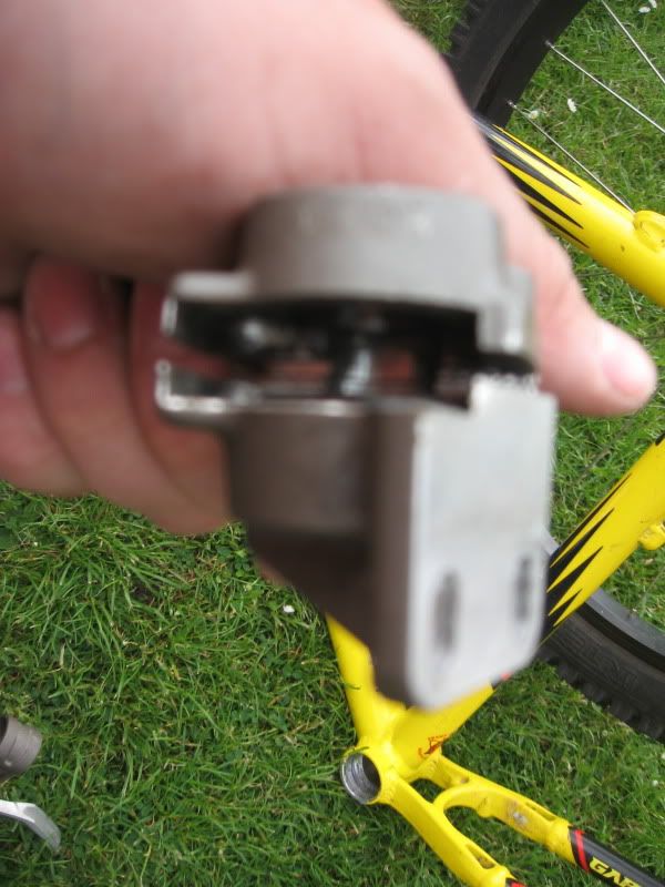

Be aware that using one of those 22mm to IS disc adaptors will mean you need to up the rotor size by 20mm .This also effectively means you need a caliper for a 140mm/145mm rotor because anything else will be too big. Also the A2Z adaptor leaves quite a large gap that needs shimming out using a washer thats about 3-4mm thick.
I built this for a mate and encountered both the above problems.

Just so I'm clear, if I add this adapter...I will need a rotor that is 140/145mm in size? So a 160mm or 180mm will NOT work? I currently don't have discs on it, so I will be purchasing a new set for it. Just want to be sure I get the right size/setup.
