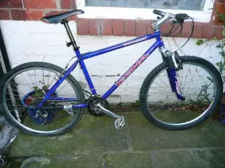

Just trying to post some pics but it does look like a '98 Explosif.
Appreciate the link on the decals - good to know there's an alternative to those listed on ebay.
I think I may take Anthony's advice and hold back on anything drastic - for now anyway. The Bomber's actually seem OK considering the state of everything else on the bike. Keeping it as original as poss sounds like a good plan. If I did end up going Project 2 though, I may need to research a bit more on fork lengths, as the shortest axle to crown length P2's I've seen (on ebay) are 420mm?

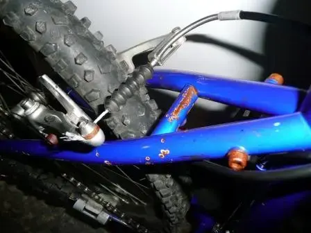

The frame is quite battered but may look better after a good clean (a job for the weekend), and I reckon most of the components can be sorted too...
From what I've seen so far though, main issues seem to be:
- hefty dent in the top tube near the seat tube junction; not sure how serious this is but will see how it rides (once I've got it running) before looking into repairs.

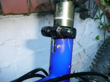

- removing rusted/seized parts. So far discovered the nice Kona O Beam seat post is jammed firm, but trying some gentle WD40 action for now.

WD40 will not do much I doubt mate. If you search on here you'll find loads of ways to remove a stuck seatpost or else google "Sheldon Brown stuck seatpost" - he has a lot of great ways to remove a seatpost which many have tried and work well.

If the dent is the only damage that you would want Jacksons to repair for you, I think you could the job just as well yourself. I'm assuming that it's one of these dents that looks unsightly but actually hasn't weakened the tube, so it would be ok to just repair it cosmetically and carry on. You ought to get advice from a good bike shop first though.
It looks as though the paint has lifted there and allowed surface rust to spread underneath. You need to cut that off with a blade until you're left with sound paint. You then need a fine file and go over that and all the other brown bits, removing as much brown as you can and any unsound paint. You then need to treat all brown or bare metal with Kurust to stabilise it. You could probably fill the dent with auto filler (subject to advice as above). Then complete the job with as close a match of gloss blue as you can find. Halfords car touch-up paint is a bit pricey, but Humbrol modelling paint is at least as good and 1.50 a pot. And maybe as a finishing touch, the top tube repair would be a good spot to site a Retrobike sticker.
If you don't like the outcome then get it resprayed, but I think it's worth trying this option first.
If the worst comes to the worst and you're advised to replace the top tube, then Jacksons could do it for you but it would be expensive. It doesn't look that bad from the photo though.

I'll take the frame into Jackson's or Woodrup's (thanks for the reminder on that) next weekend and see what they think about the dents and the stuck seatpost before I go any further. Tried all the tips for the seatpost I've seen online but it looks like it may have been hit hard at some point and bent/jammed in the frame, maybe jumped or crashed?
