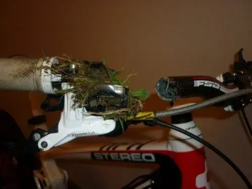

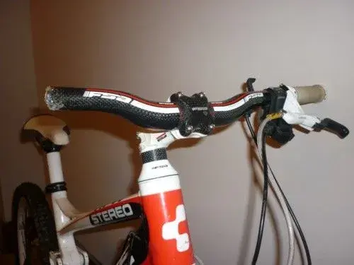

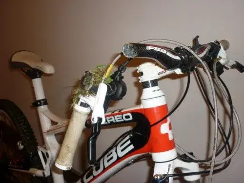

Just a reminder that you should never jump with 100% carbon bars, although i must say it was a 5ft drop off i did!!

Funny how it broke at the brake lever clamping area. Sure you didnt over tighten the lever?
EDIT: Actually its a good inch away from the clamp so maybe not :lol:

within an inch means it is still probably an over tightened lever, or from the lever slipping on the bars.
Carbon bars are fine for jumping guys..... just have the proper carbon bars for what your doing. IE, if you plan on riding hard, you must be running carbon DH bars. All mountain etc carbon bars wont cut it :)

Yes it is approx an inch away from the brake clamp, infact its a very good inch away, my levers are never that tight, if you over tighten them and come off, they snap instead of move round the bars
