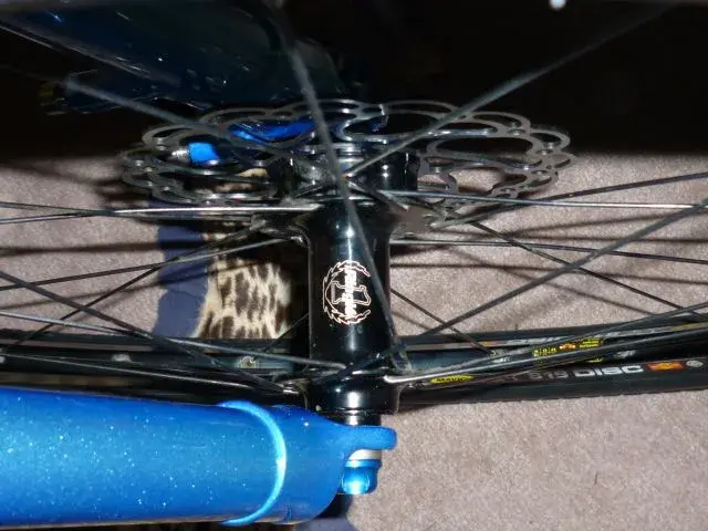

I always wanted to build a superlight rigid klein and funds where never available.........until now.So far I have ;
Klein attitude framset in linear blue(medium 1404grams)
carbon rigid fork (558 grams)
manitou mars carbon cl (1170grams)
Spinergy rev x (1780grams pair)
Hope ti skewers(69 grams)
Maxis semi slick 1,5 tyres(780 grams pair)
mmmmicrotech full carbon stem (99grams with ti bolts) :shock:
fsa carbon riser(157 grams)
Chris king no threadset(117grams)
Nokon union jack cables (76 grams)
Xtr m970 front mech(126grams)
Xtr m970 rear mech(199grams)
Dura ace 7700 9 speed in titanium(saves me 102 grams over the xtr!!)
Xtr m960 9 speed shifters(218 grams)
Hope ceramic bb(109grams)
F.s.a red white and blue hollow chromo(192grams)(58gms lighter than fizik gobi ! so I swapped it)
Hope bolt seat clamp(19 grams)
Ritchey carbon pro seatpost (187 grams trimmed and with ti bolts)
xtr m959 titanium axle spd
Fsa team issue carbon chainset(575 grams)
KCNC vs (180gms)Avid black op research levers (?)
kmc ti gold 9sl chain (176grams now! a saving of nearly 80grams due to dura ace cassette)
Ritchey true grips (60 grams)
And all bolts will be titanium or aluminium.
This should be v.light I was hoping for under 17,5 lbs but realistically under 19lbs should be easy. :D
I think I could get under 17.5lbs if I really try and put myself in the poorhouse :lol: :lol: :lol:

A few more pics

arrrrr 'tis a nice colour 8) 8) 8) especially in bright/direct sunlight.... :wink: looks like a bit of a nice build on top too...
Just notice tho, that you've run over a bloody Leopard, will that clean off your tyres ok??? :lol: :lol: :lol: :lol:

Yes I am an antiques shop owner and as such my house is like a museum :lol: The leopard was shot by one of my ancestors about one hundred years ago :!: So there are no squidgy bits left :lol: :lol:
If you type into the google search klein attitude superlight rigid you will see that originally I had run over bagpuss :lol: :lol: :lol: Luckily hardly any :oops: body found this listing
