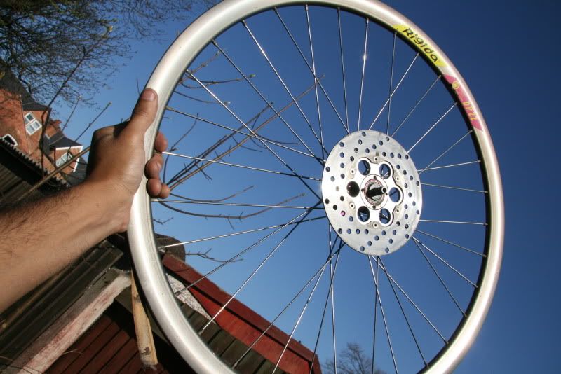

I dont even know what these are called. This is a DP22 rim in excellent condition built onto a hope hub which is designed specifically to go with a hope disc brake. Part of the brake holds the axle in place, I do not think it will work with anything else.
I also do not know how much these are supposed to be worth.
So I am going to say £50 posted just in case it is rare and valuable. But feel very free to hit me with offers.

Hiya there is a thread about these called hope disc brake timeline in the retro chat section.
Fwiw the hub isn't that rare although a close up to confirm would be nice. The disc carrier is a little more so being as its from the phase where Hope were playing with the number of holes and went from 6 to 3 to 5 fairly swiftly. If I'm not mistaken that mount will take standard modern 6 bolt rotors so apart from the fact the carrier is a chunky bit of metal it could be attractive to someone looking for a semi-modern brake set up.
If you search my posts you'll see what an older prototype rear cost me to buy - although it's not directly comparable to what you have there.

but you see the axle is different on each side. The rotor side will not stay inside a fork end. I saw the brake on the bike this came off, it was a hope mechanical caliper which held the axle in place. Without it the wheel will not mount into forks.

Yea - I have 2 of those hubs one built up and one loose - they will fit either an enduro mechanical or a c2 hydro.
See bottom right but two.
Prototype disc carrier (note no lock ring)
