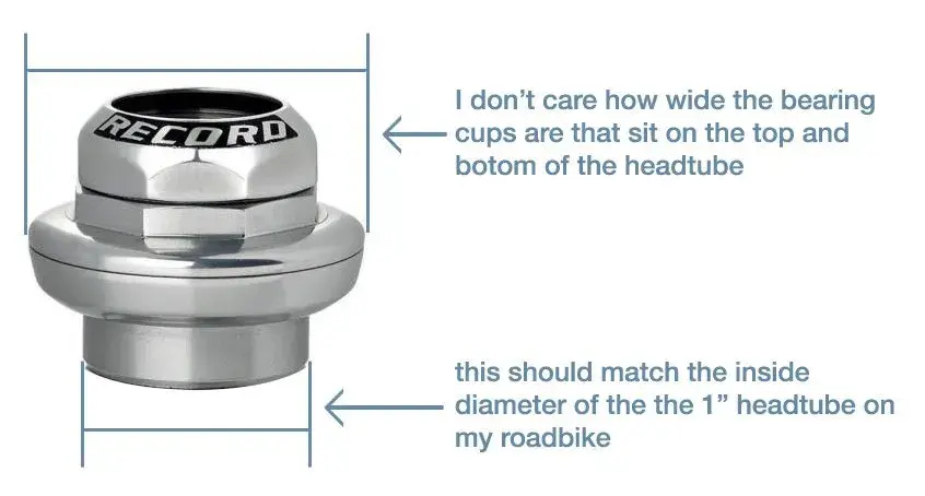

I have a question about the GT Epoch headset. I can get my hands on a gold one which would suit the colours of my roadbike very well. I'm not sure it will fit though.. The nut that threads onto the fork is 1" so that sould work fine (the bike has a 1" steerer), but will the bearing cups fit into the headtube of a roadbike?
Here's an image of a random headset to maybe clarify what exactly I want to know!

just measured one with my gauge - and the inside measures 1.1/16 0r 27mm - so i don't think it will fit in to the tubes of your road bike
i do remember that us bmx have the same prob some times when buying headsets and they don't fit they rattle :roll: :cry:
you could try a knock it in but you might take it out of shape or do you tubes in :shock:

I just measured an old headset from a roadbike and the outside diameter of the bearing cups "mounting ring" (the part that goes into the frame) is 30mm, and the inside diameter (which isn't really that relevant) is close to 27mm. Did you perchance measure the inside diameter of the mounting ring?
Anyway I already paid for the headset so it should be coming my way at some point this week. If it doesn't fit I'll make sure to contact you!

yup :lol: your right - but in theory it means to be the same a 1.5 on each side to make the outside 30mm (inside) 27mm
it had been a long day :oops: :lol:
have a look at this thread on Raleighburner.com - a member seems to have bought a road bike headset cups
http://www.raleighburner.com/phpBB2/vie ... hp?t=22304
seems to be the opposite way around to your need ?

I can't open the page because I don't have an account there, could you maybe copy/paste the relevant bits? Cheers for thinking with me!
