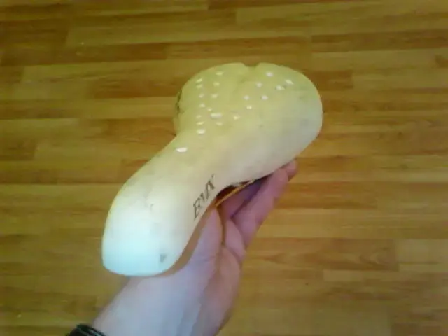

hi guys,this bmx seat has suffered somewhat cosmetically.
originally white it is now 50% caramel/yellow.
id like to restore if possible,ever encountered this problem?
other than throw in the bin is there anything i can do?
thanks for looking.
marc.

try bleaching it or use some jiff on a scouring pad

cheers! i will soak in bleach,see how it goes.
i will post results for future reference.
thanks. :)
