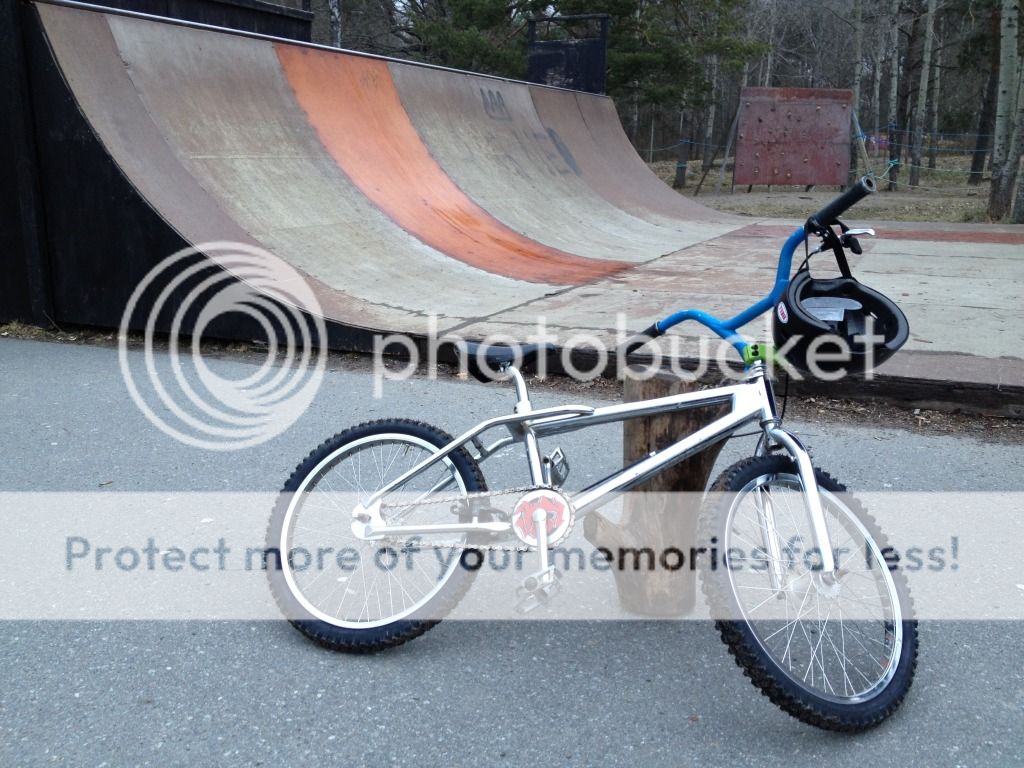

Now my kid is getting big enuff to use the Heavy Tools I bought him last year.
Even though it´s a flatland I put tires with some knobs on them :)
I also fixed the brake so it´s usable, and it works real well now!
Here we are at a dirt track, having a great time :D
We´re not at this level yet though :lol:
Hope you enjoy the pics

looking cool there and a sweet ride :twisted:
but get them bars forward - in line with the forks - let him learn the right turning circle and the right point at which it works best - he will ride better for it :wink:

Thanks Cat!
But the bars have to be where they are, he can´t reach the brake otherwise.
We will get there in time :twisted:

the brake can move up round and the bars a bit more foward - give it a try and if he can't then maybe lower/samller bars will help
it's how it rides that will get him better and avoid accidents due to steering :wink:

I got the seat forward a couple of cm´s.
I pitched the bars forward a similar amount and it made a big difference.
I tried it out and it was a lot better riding it.
We´ll try it out tomorrow.
Thanks for helping out man :D

If the bars are too far foward it will give the feeling of a shopping trolly - it hunts where to go instead of you feeling it
too far back and there is a lack of what is going on till it's too late
when the bars are more in line with the forks you get a true feeling of what the tire feels and at the same time you can react to it
different frames have different head angles and so will feel different to ride, but get the right line and they should ride better and feel more dialed in
get him to test it out - line the side look of the bars to be in line with the forks - it can even be a slight bit more forward - but back is not great

Yeah, the headtube is really steep!
I´ve lined it up just shy of that angle and it seems to work fine :)
I adjusted the seat for my kid and it went really well.
