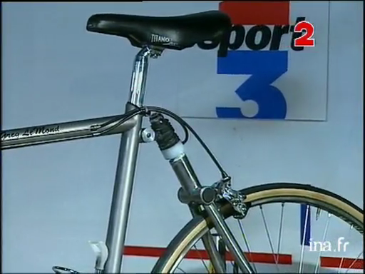

http://www.tearsforgears.com/2010/04/2- ... ubaix.html
or maybe a bit off full-sus...
http://www.tearsforgears.com/2010/01/fu ... ubaix.html

that lemond is awsome! 8)
