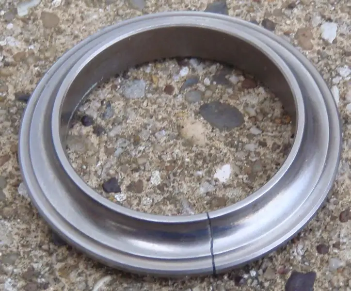

Firstly my crown race (?) appears to be cracked (I'm assuming it is a crack rather than built that way!) - I'm hoping that this shouldn't be too much of a problem to find a replacement...

The crown race should be easy enough to replace, surprised it's cracked though in all honesty as they are normally steel. Any chance of a picture?

File comment: the crown race..

Yuk, that's a crack.
Sorry to be the bearer of bad news.
