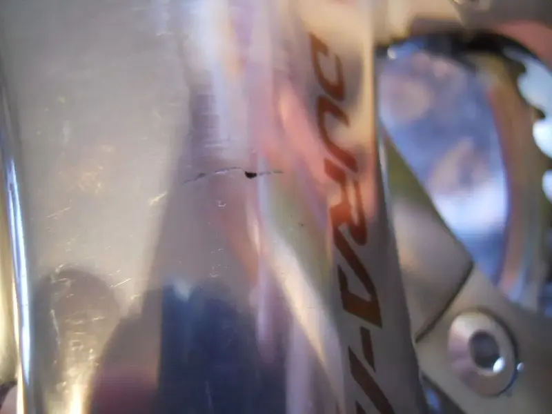

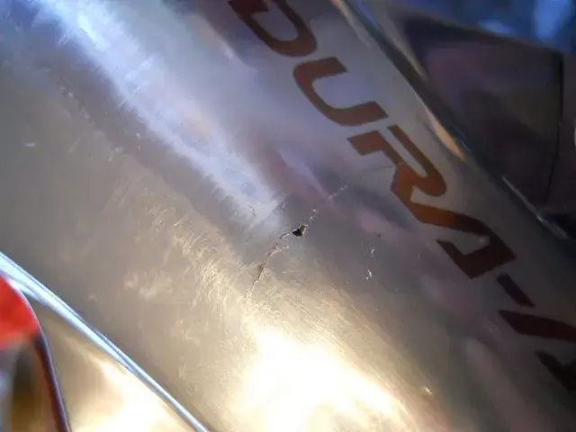

Bought these second-hand off another forum and when they arrived there appears to be a crack across the crank arm. Any views? Unfortunately this damage was never described in the for sale advert! :evil:

:shock: not good. write back to the seller :twisted: I'd say they are useless or fit to garage queen.

The crack started from an inclusion in the alloy. Bin-bound garbage and definitely widowmakers.

Sadly seller refusing to acknowledge it is a crack. Anyone here a specialist in this kind of thing? The reason he gives is damage from a pedal spanner...

How can that be caused by a spanner? There would be quite an obvious impact mark, steel hitting aluminium leaves a dent on the aluminium. There is do doubt that is a crack, and if he won't accept that then take it do an engineering shop for a die penetration test or even an xray if you feel like making the point to him.

Definitely a crack :o and if you took those to be dye penned or xrayed they would laugh at you. I've had a few deals like this, ideally the seller covers postage but its not uncommon to share costs if its a genuine mistake. Perils of second hand goods and all that.
