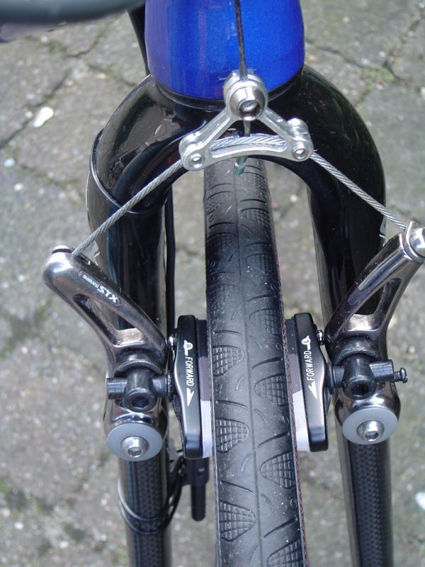

Maybe handy to know , it's not difficult to
make the it yourself .
Check the picture.
Regards!

They chopped down V brake inserts? Nice lookin' brakes as well- are they Shimano Cyclo Cross?

Any more details? I'm trying to source a suitable set of pads for carbon rims :)

I've been looking for these brake pads long time now .
They'r just not available anymore.
Now i found out that cutting an cadridge brake pad from an road bike is
easy , the size is almoste the same.
Do NOT use ATB cadridge pads , they are more bend , caused by the smaller wheel size.
i used BBB cadridge pads , the same as i use for my road bike.
Whell ...ahem ...road bike.. i ride an transformed cyclocross bike..
its these brakes (STX)
And the shimano 600AX brakes wil be fitted to this frame

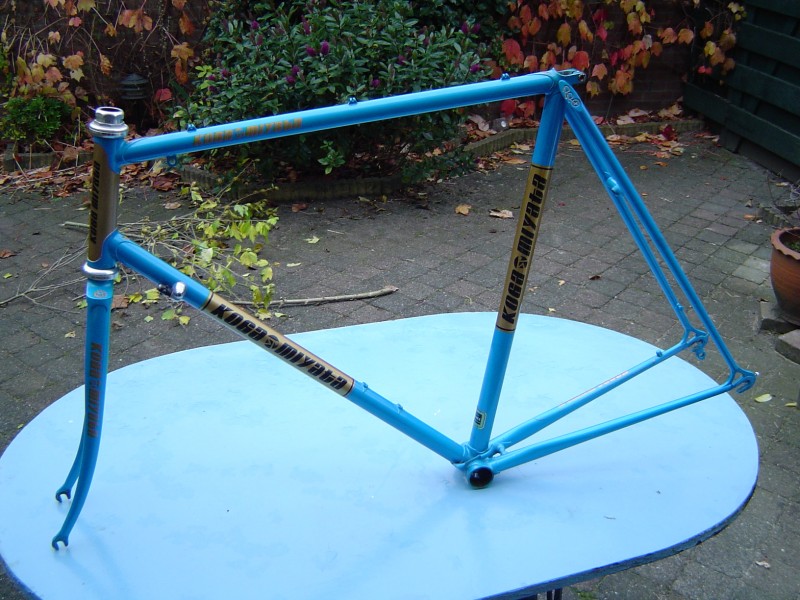

Very nice frame you have there. What is the story behind it? Is it refinished or was it ever like that? The race number tab certainly is a custom addition and the vertical decals on the headtube are something you normally saw on teambikes only.
I notice modernish headset and STI adjusters: You are going to build it up as modernish rider?
Are the callipers goldish anodized?

i think you know all about this frame ... Bought it at e-bay few years ago , guy came all the way from Friesland to bring it , he had bought it like a year earlier as new old stock , and used it a season with the 8 sp setup , thats why the modern STI adjusters are on the bike. I will remove them and install the old style setup. The frame is original and in splendid state.
I do have other PRO frames that need attention , but thats for later.

Okay Rene :D , now I recall again. I remember that auction. It was in a unique condition and I even recall what money it went for. Its seller visited me once, when I were living in the north. He told me about that he ran some of these frames with 8s and even entered competitions with them.
What are the other "PRO frames" are you busy with if I may ask?
