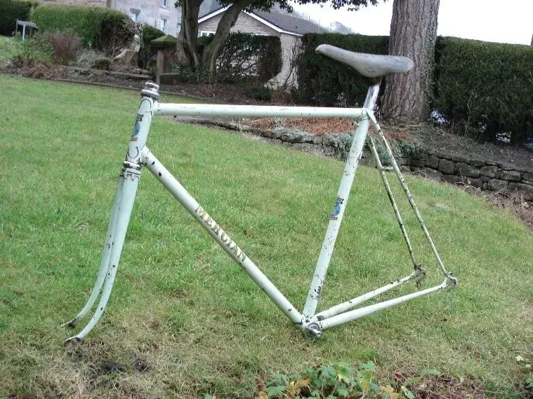

hi further to my post ref 1963/4 red feather falcon here is a picture of my old 1953 king of mercian before strip and then frame down to metal
looking for ideas as to how to rebuild it , gonna build it up with all the bits then strip it and paint and rebuild, save messing up the paint
don't want to spend the money for Mercian respray , will do my own - i did the falcon myself
have wheels and some centre pull brakes and brake levers , have got a pair of downtube gear shifters
so need to sort out suitable gears / sprockets / gear changers cranks chain wheels. rear brake hanger and the yokes for the center pull cable on the brake calipers

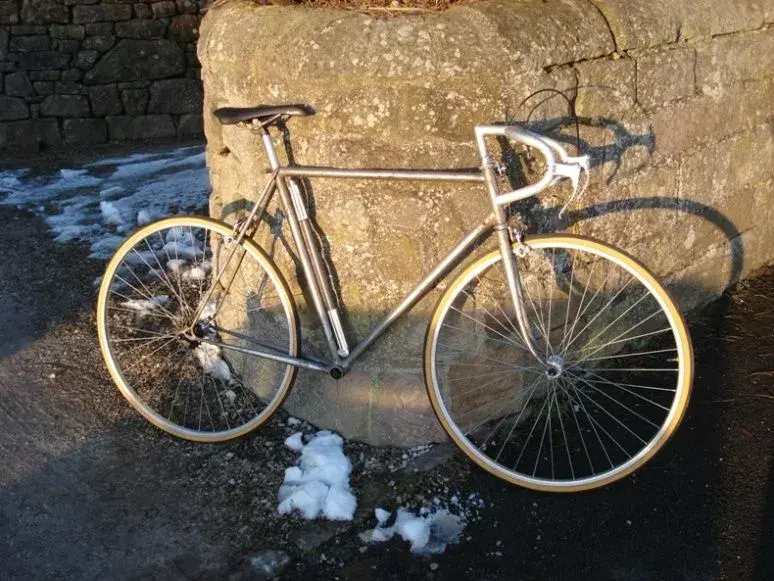

frame stripped of paint
seat stem still in , bit of inner tube over end of seat post as it has ammonia solution inside to attack the aluminium oxide ,
it came out 2 weeks later with a lot of work .. made special contraption to get it out

wheels, alloy seat post, and brooks competition saddle, brake calipers and levers, alloy h.bar stem and bars and a pump !!
bb empty
