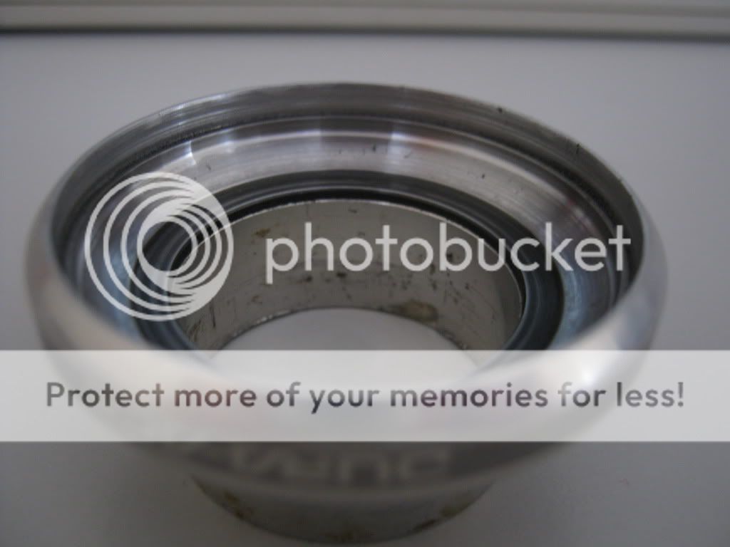

I've got a 7400 headset that's a bit notchy. I've got access to a lathe , can the dents be polished out with emery cloth or something ? The races are probably hardened but the dents are surely only a few thou deep. Google doesn't have much to say on the subject :(

I would try the usual bodges first; change the number of balls so that they don't line up with the dents. So if the balls are in a cage at the moment, fit loose ball bearings without a cage, and vice versa.
The second thing to try is to remove one of the cups and refit so the dents don't line up.

Rats ! I forgot the crown race has some sort of plating ( it was 20 odd years ago when I put it in ). Good idea fiks , thanks.

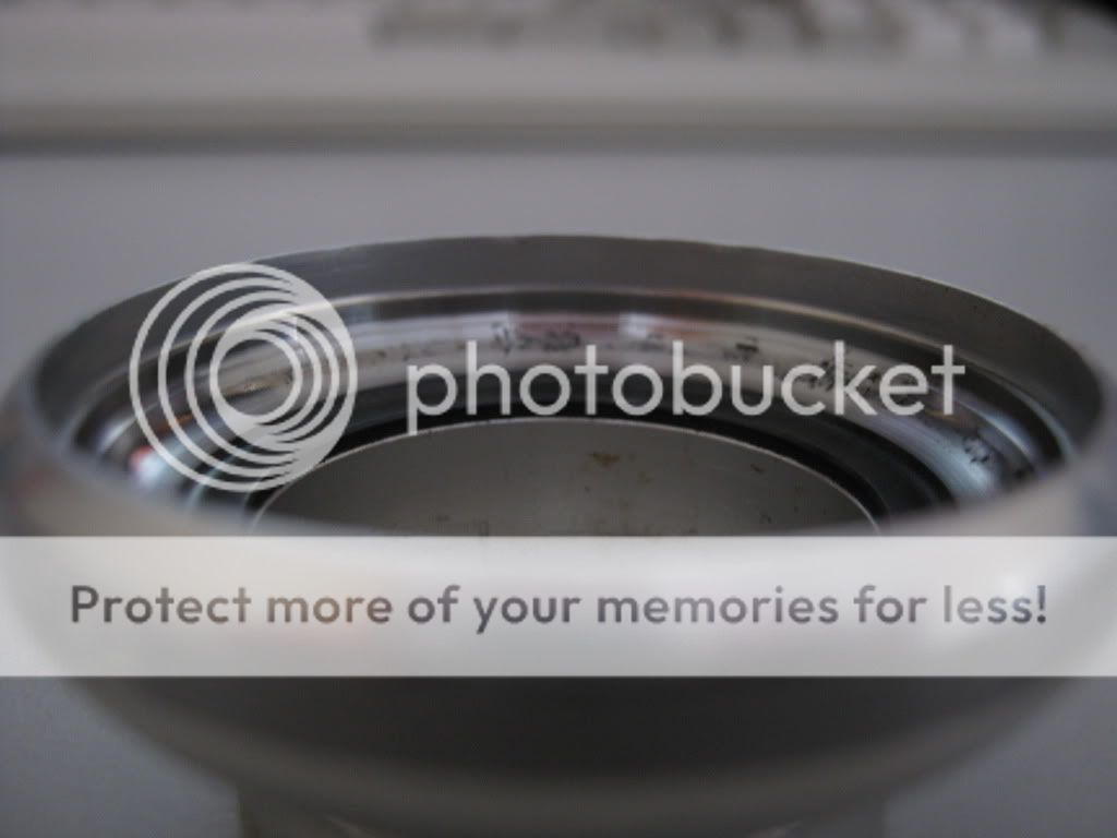

Same bottom cup after a couple of minutes in the lathe with a bit of emery cloth wrapped around the blunt end of a drill bit. It feels noticeably smoother but whether it will last another 20 years is doubtful !
